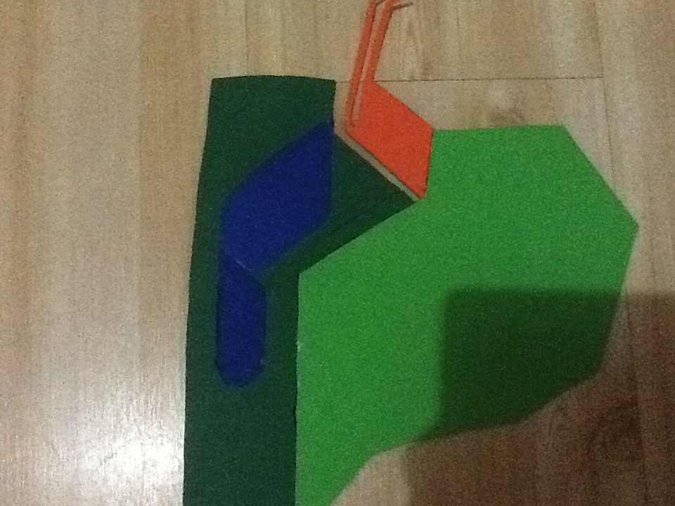

Hey guys, I am having some issues with the scaling of the pieces, it's already happened to me so many times that I don't feel like working on it anymore.
(Sorry for the bad quality)
As you can see some of the pieces are a lot smaller than others and they do not fit with each other, I would like to know if this has happened to anybody else since it's getting really annoying and as a new costume builder i'm losing a lot of motivation :( any help as to how to fix this is appreciated, thanks!
On my first suit I didn't scale each piece to my exact measurements. Instead I just scaled the whole suit to my height to get a rough idea of the fit.
That way all the parts retained the correct scale so as not to look weird when I wore it.
As you get more experienced you can start to alter the scale in more detail to achieve that perfect custom fit we all want

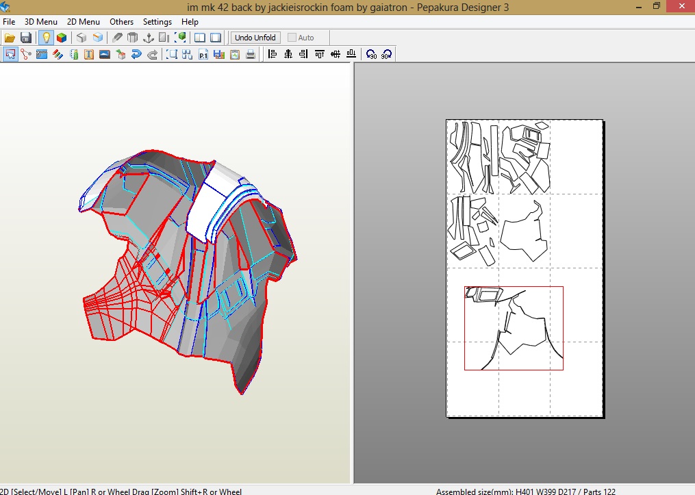

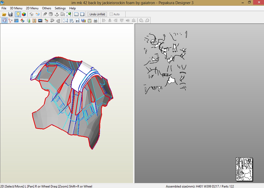

I have attached two screenshots of how it is on my pepakura to show you what i mean.
The first shot shows the missing parts up in top left and the second shows a part that I tried to place back on card, but it appears to be two parts and it wont fit on one page. am I doing something wrong?
View attachment 226342View attachment 226343
If u are making it for foam then all the parts you need should be there. You can either split that part to make it fit on 2 separate pages (join/disjoin edges) or print it over 2 pages and then tape the pages together to make 1 big part (JFCustoms method) make sure to check the the print alignment marks though

I see.., but the problem that really bothers me is that the pieces inside the file, in this case the leg, don't fit like they should, it's like if you had a puzzle piece that was too small compared to the other pieces, I hope you understand what i'm trying to say. :p thanks for the help!
Go back to your pepakura viewer and make sure to click on every piece in the 3d window so you know where there are in the 2d, I usually mark all my pieces if I'm not sure where they go to make it easier
