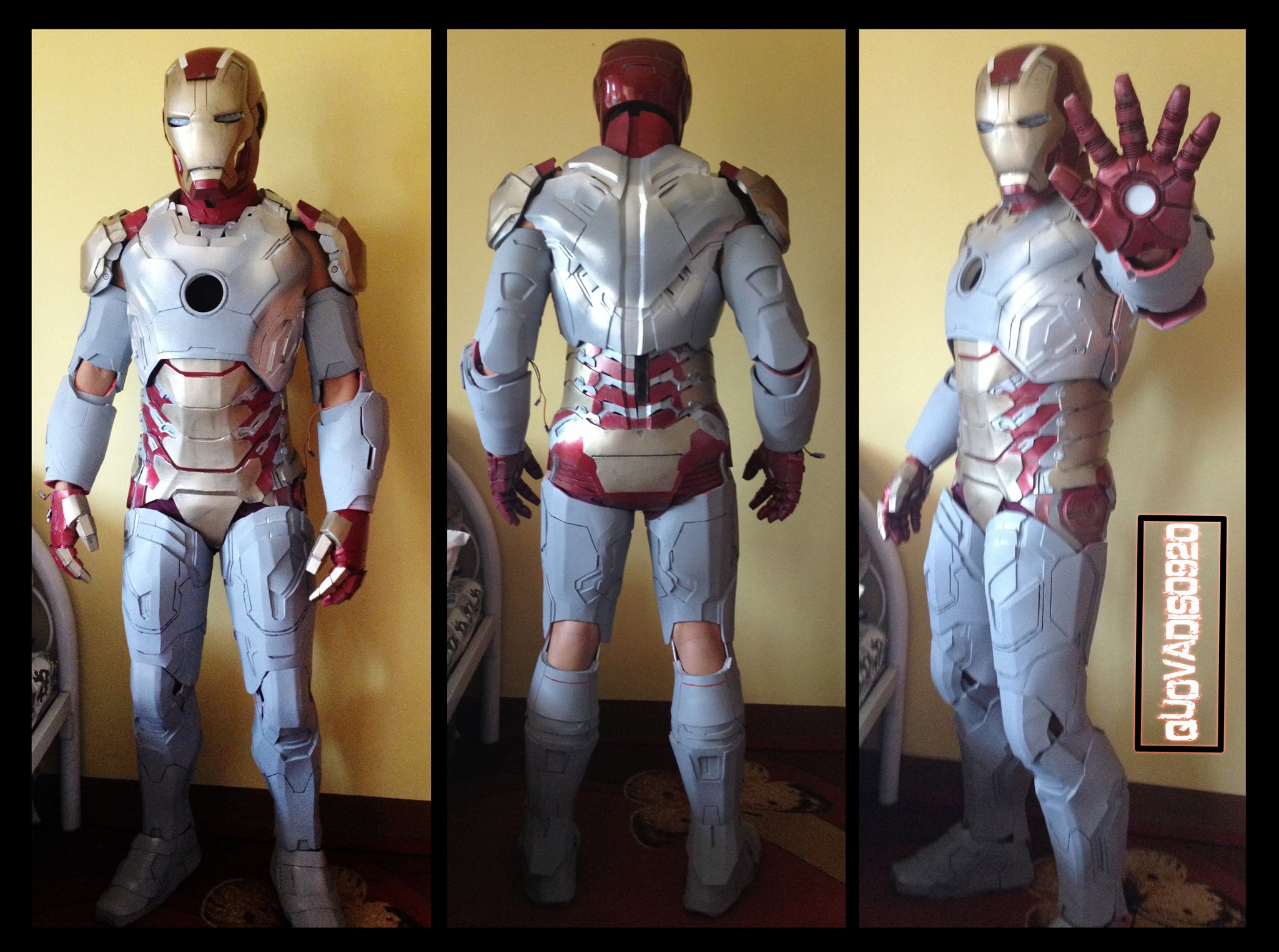

What size is that?
It's meant for a person 5'7. I'm 5'7 but it can fit 'til 6. I have lifts in my boots and if you're taller than the specified size, just need to remove the lifts. I'm considering selling the whole suit as a package as I'm wanting to make a new set of suits again [1 for me and a couple to trade/sell]. I'm just obsessed with the mk42 atm. Check my THREAD out to view the electronic features.

Wow that is some amazing work! My thought was to put lifts too but I'm 5'11"! Haha

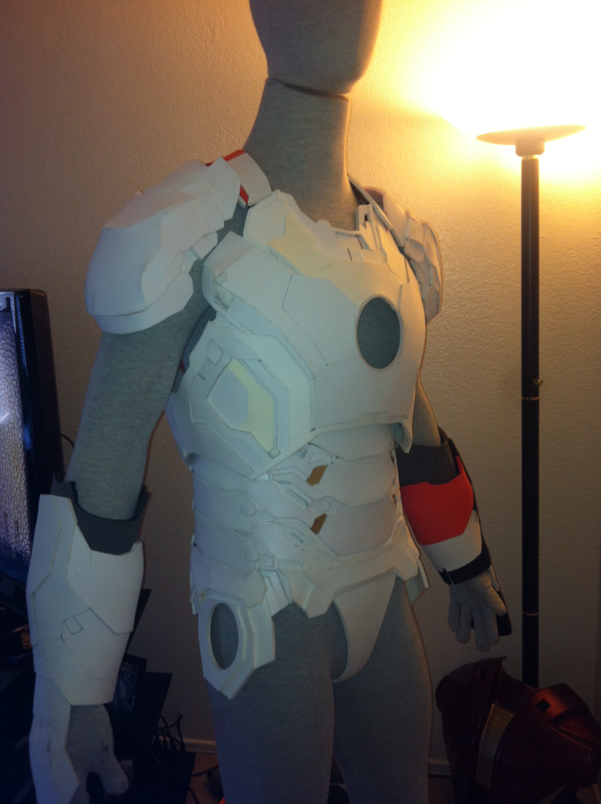

Hi people! Can somebody help me with unfolded back files for paper? I'm sharing some pictures with all of you, paper is really very complicated, but I hope to finish all the armor next month.
Anticipated Thanks for your help!!!
