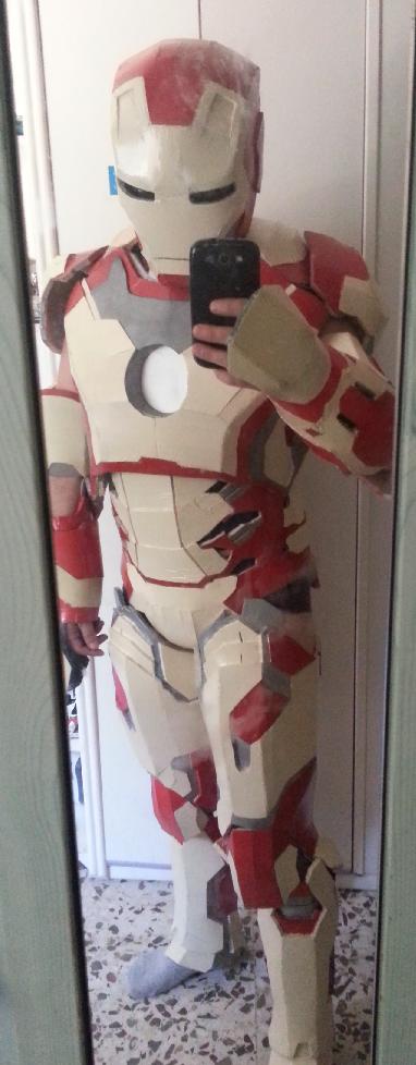

just wanted to share my progress on my last mark 42 build :)
majority of the files i used was from jackieisrockin (my unfolds ofcourse), mainly the lower parts (boots, shins, thights cod and abs) and the chest. .

Finished mk42
Looks too awesome!
https://m.ak.fbcdn.net/photos-h.ak/hphotos-ak-frc1/s720x720/10664_485292644886533_1567474625_n.jpg
As always, too awesome!
thanks jackie for the files

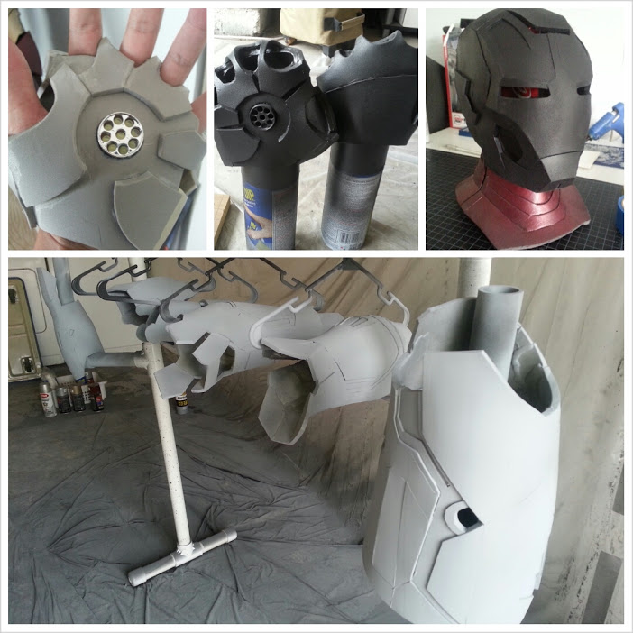

Hey everyone, here's a quick pic that summarizes where i'm pretty much at with this build. Thank you Jackie, Helegak and all the unfolders for your awesome work!

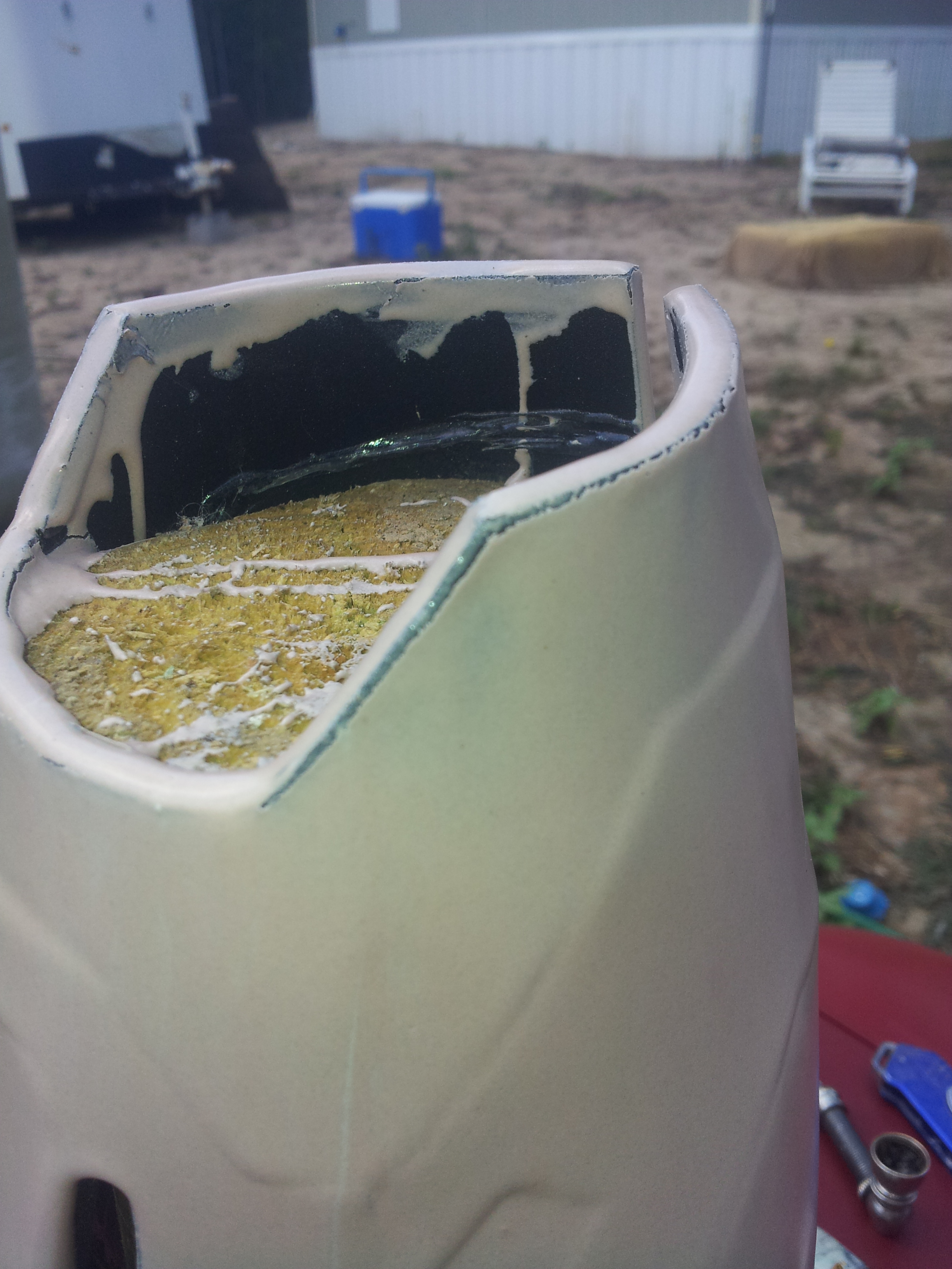

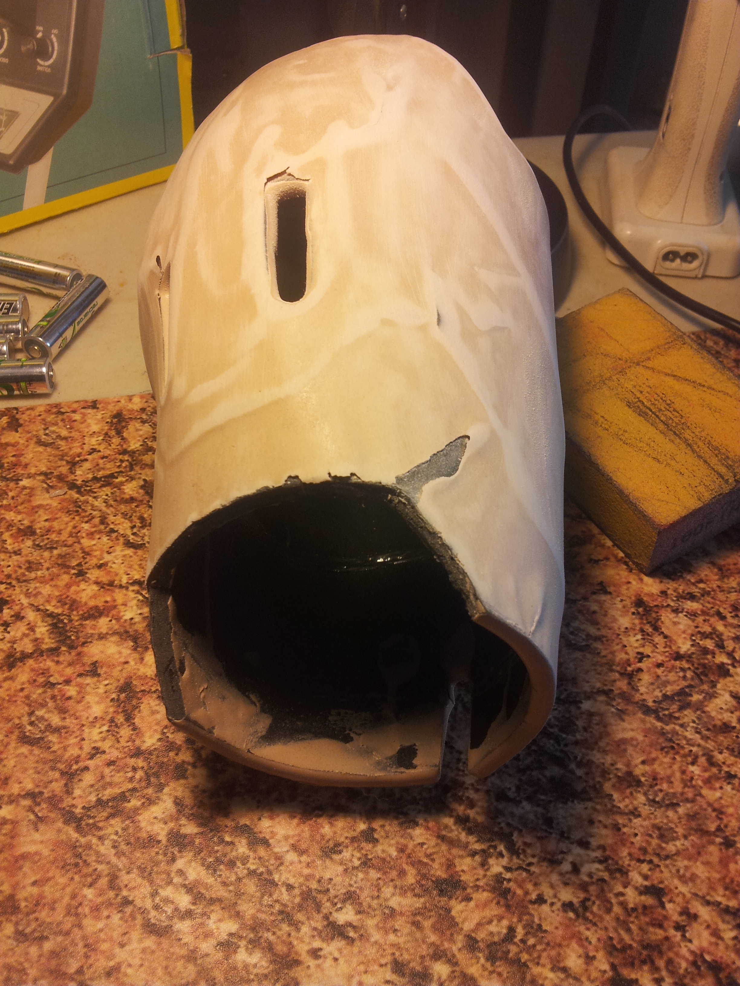

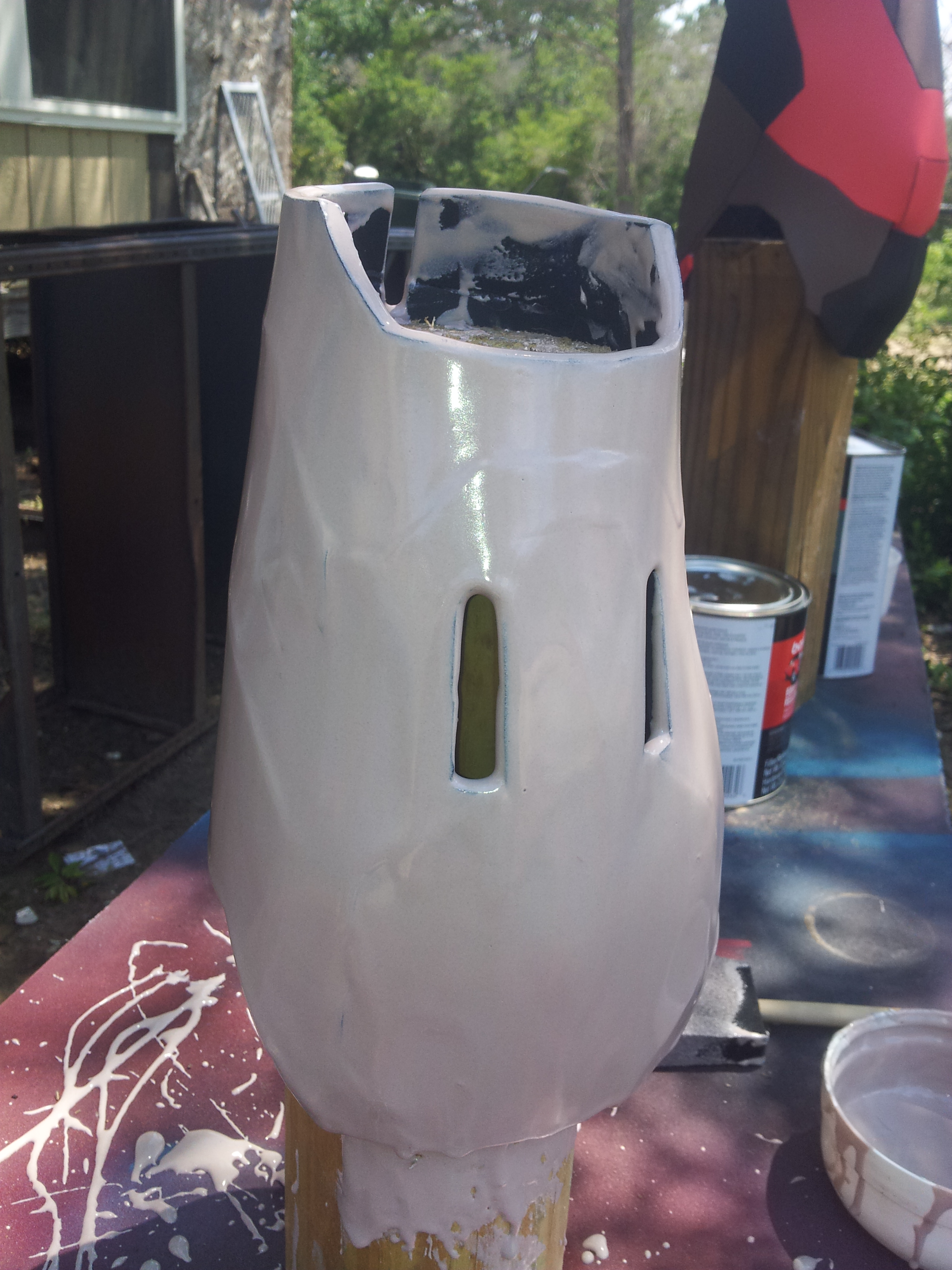

I sealed this forearm with modpodge, then brushed on rondo. After it dried, I sanded it. I was going to put on more rondo, then sand again, however, it is cracking of at the edges. It also warped it slightly and is even coming away from the foam in some areas creating an air pocket.
Any advice?

View attachment 206968View attachment 206969View attachment 206970
Any advice?
you can fix the warping with a heat gun sand it down where ever its cracking and or coming away and apply another coat of rondo.
