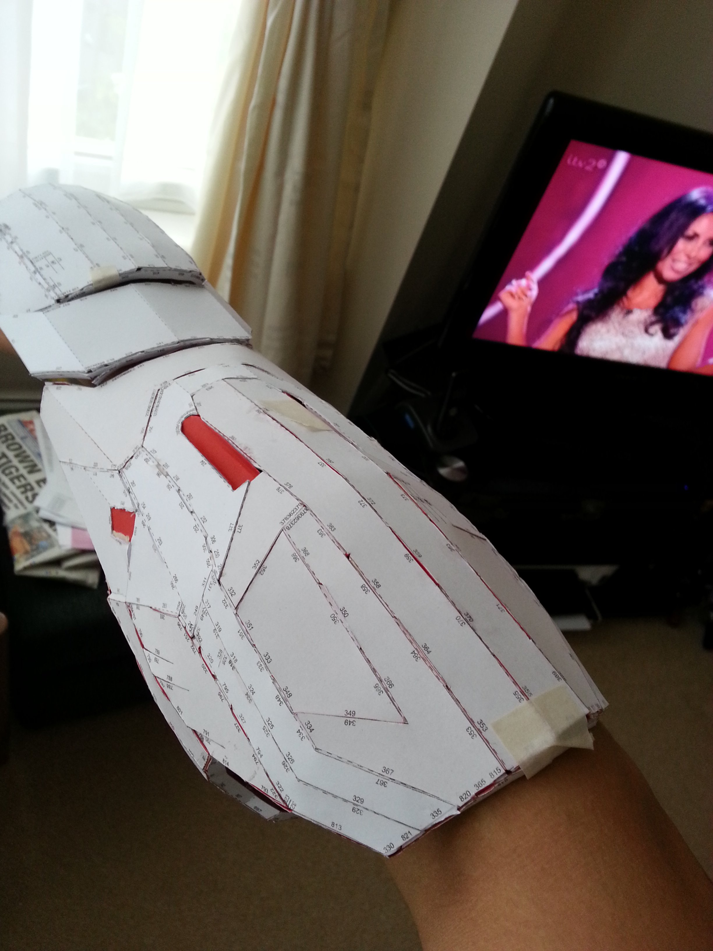

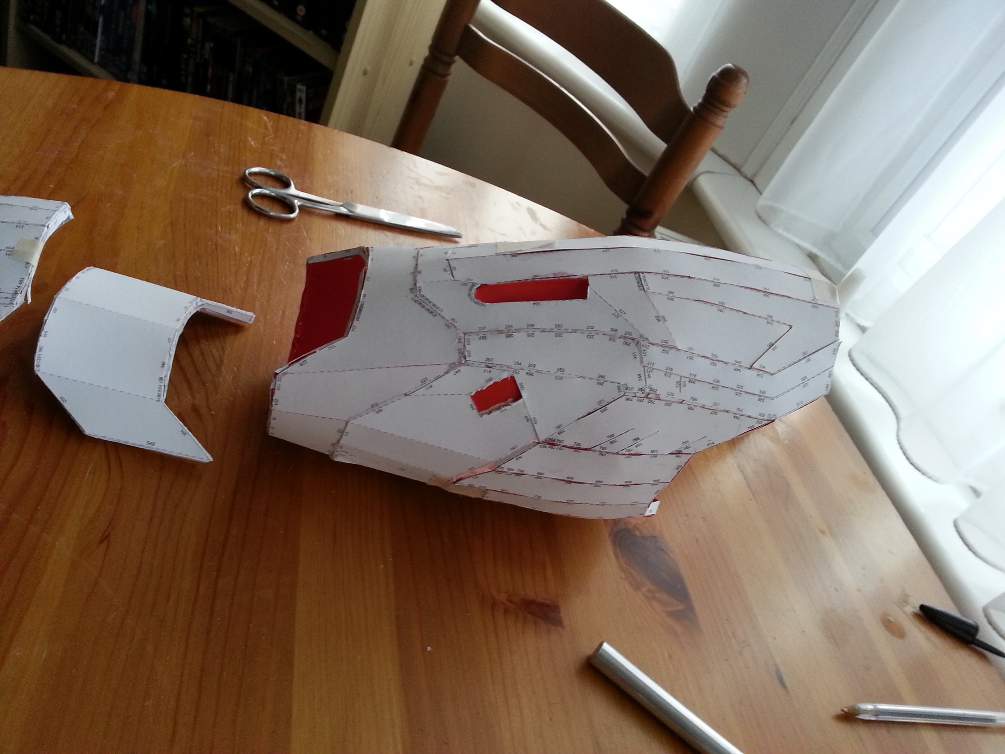

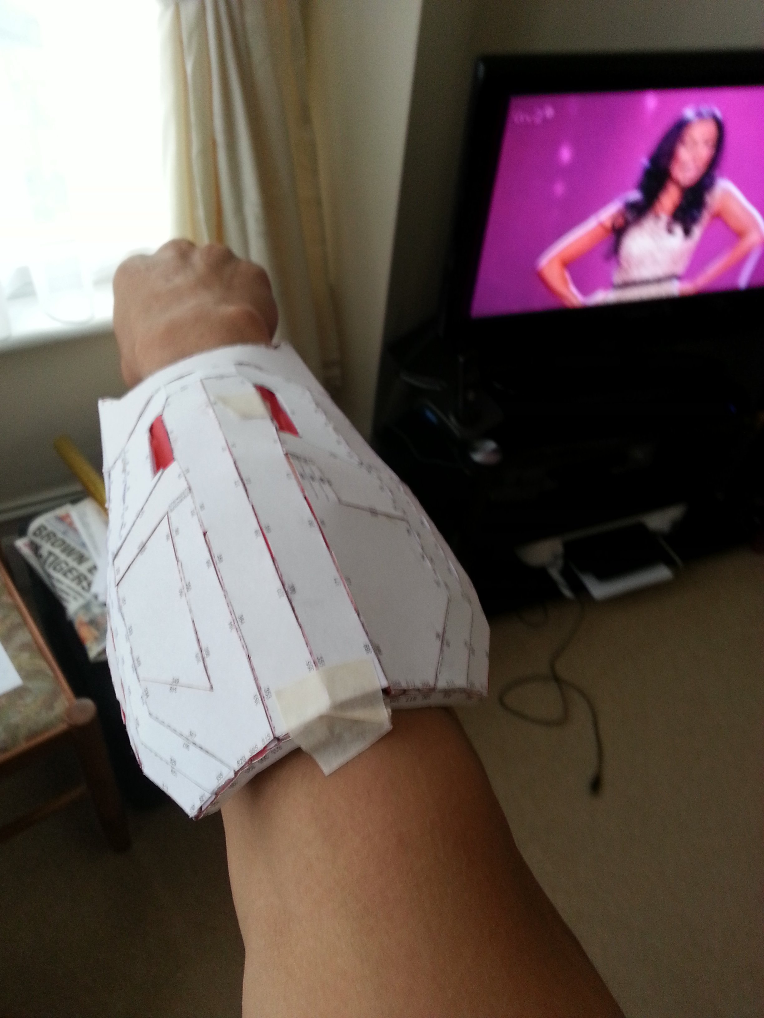

I'll upload a few pics of my 2nd pep work - The forearm
Im just about to resin this but I still need to pep the inside of the forearm, so please no one say ive made it too big :p
