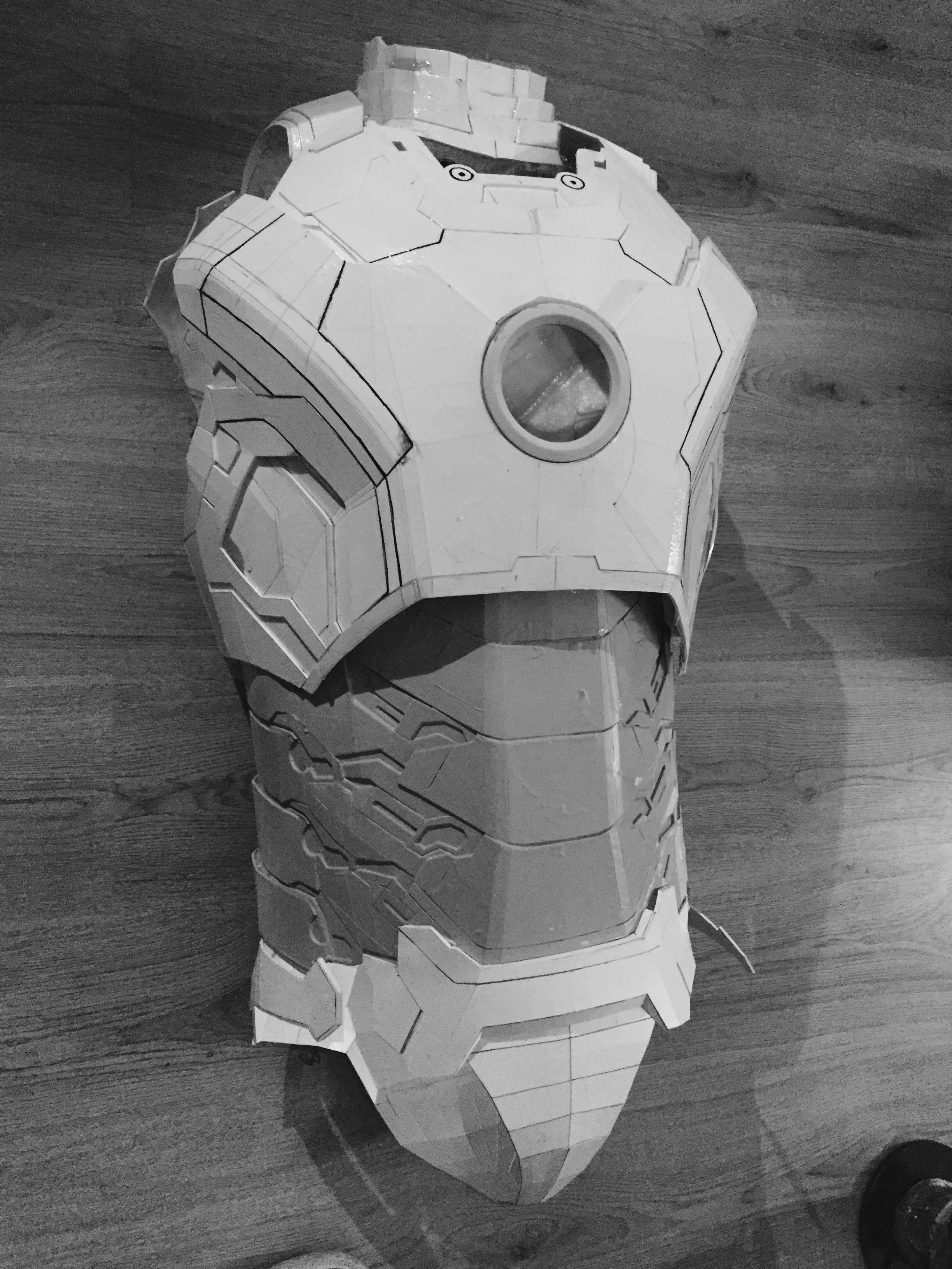

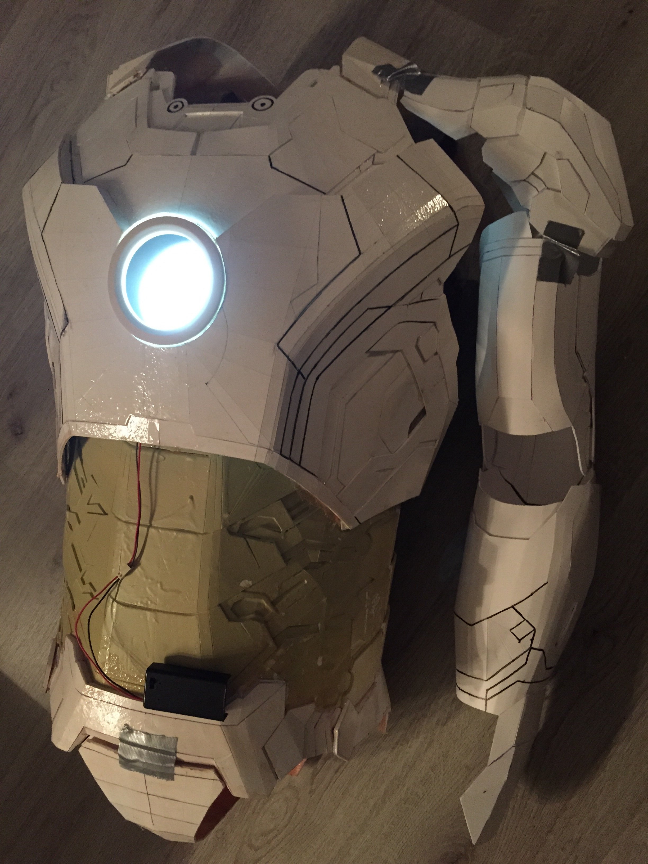

Hi guys, i wanted to share my progress.
Its a Sintra an fibreglass build. In only need to fibreglass the cod and its ready for bondo.
I scaled these parte at 475. Hopefully they will fit. I am a 176cm tall guy, but the abs allready seem thight, although i have a normal build (73kg).
ps. this will be in the MK43 paint scheme!

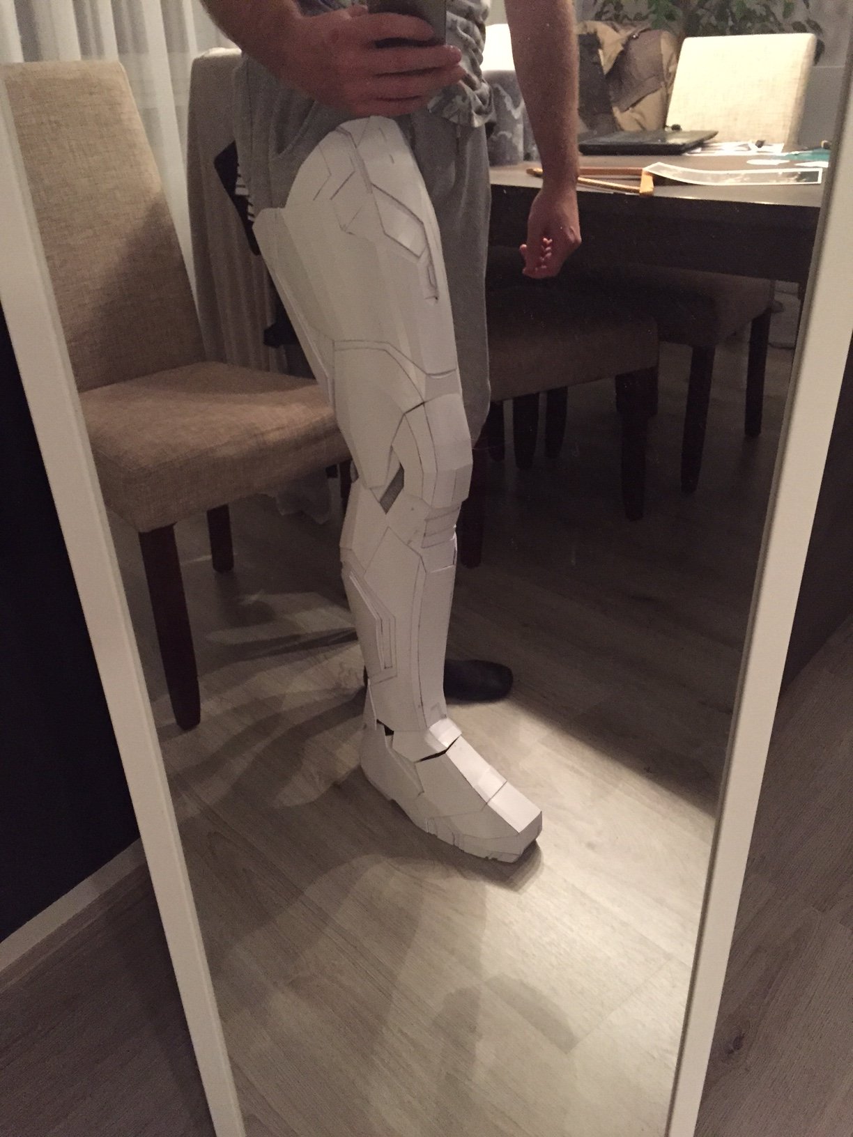

some more updates on my MK43. Great files. The lower leg however is quit difficult.
I will be making my own Thread on my build. But that wil be online when i am a few steps further.

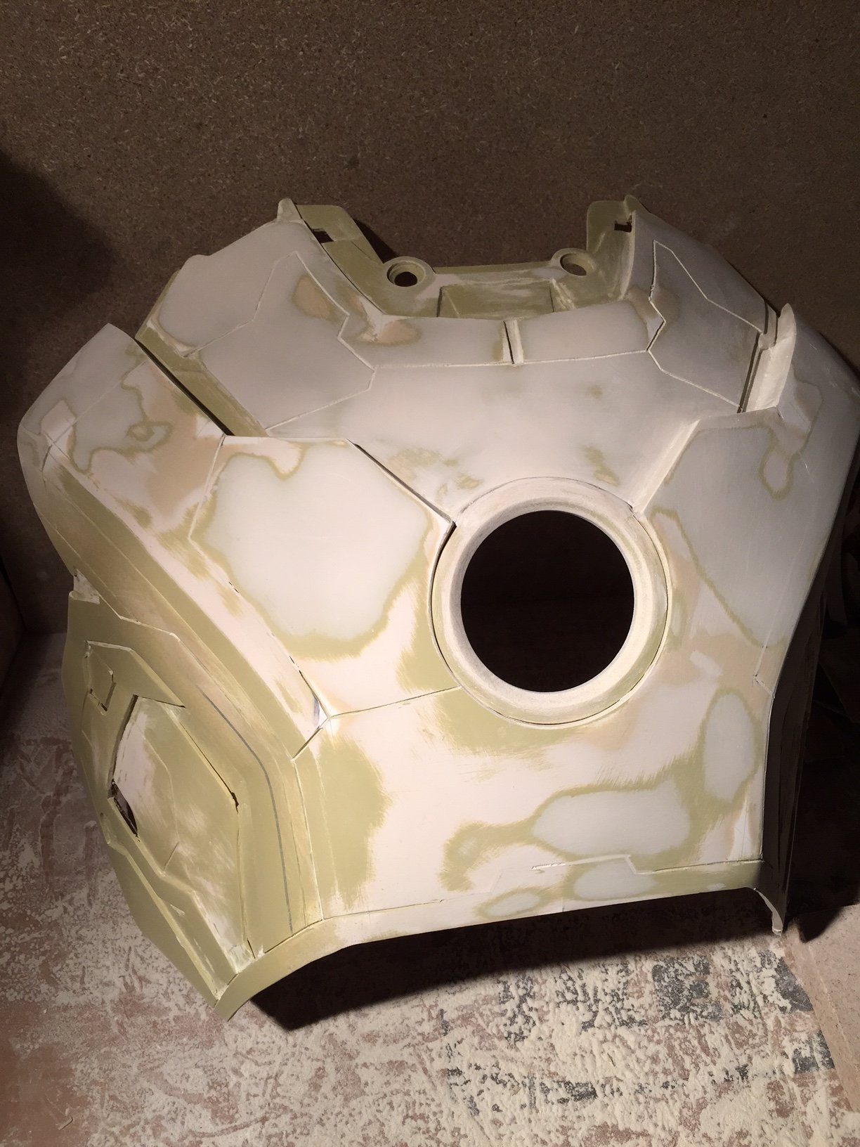

I think the chest and maybe the back will be primed this week.
Hope you guys enjoy it.

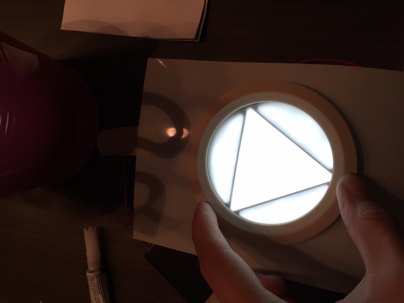

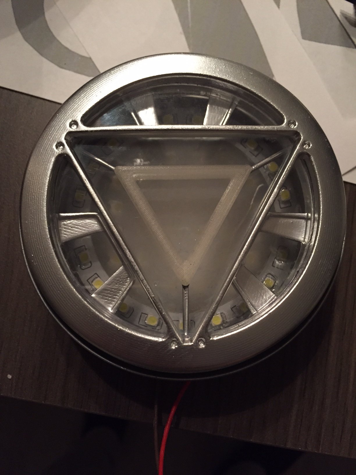

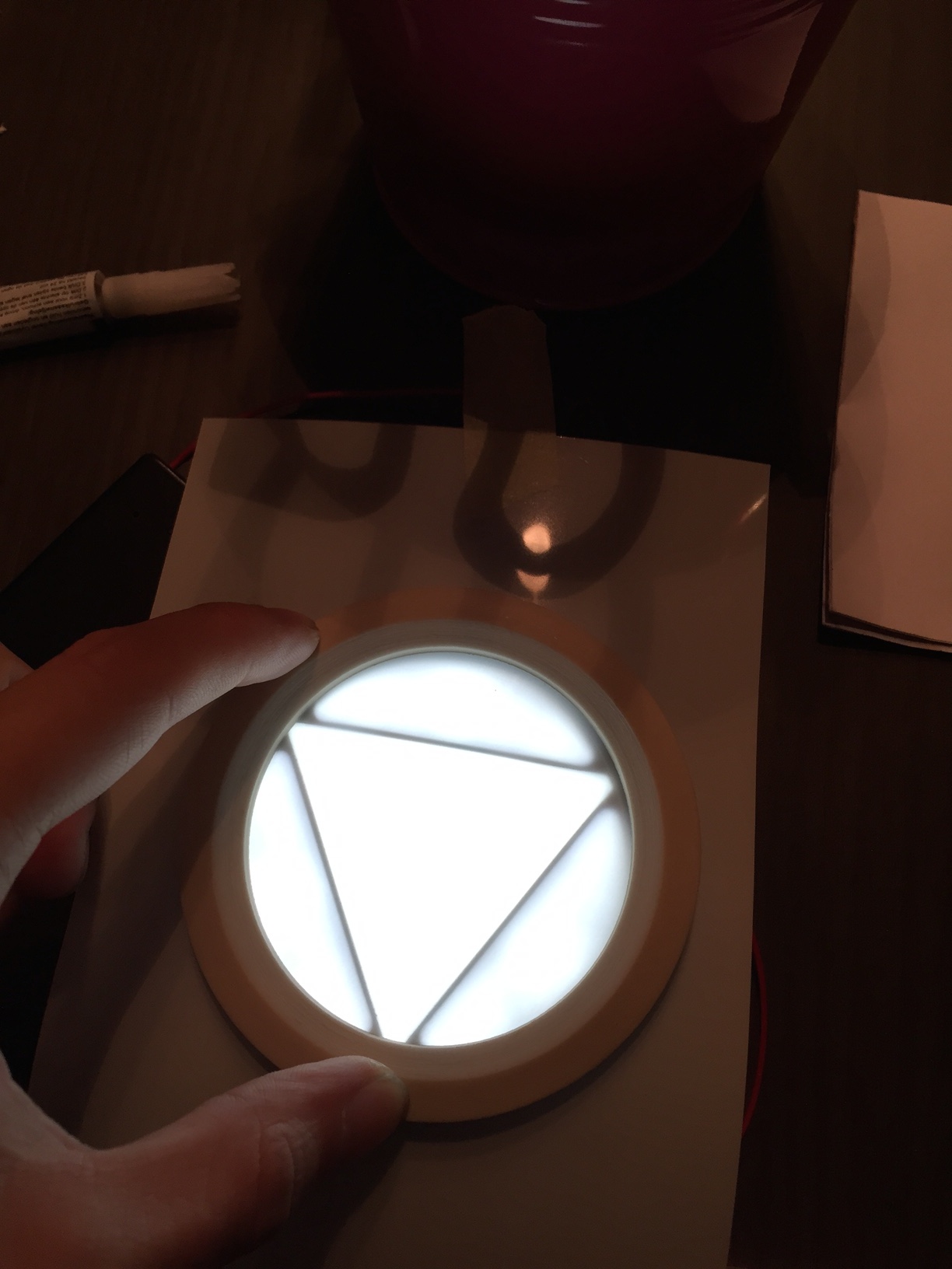

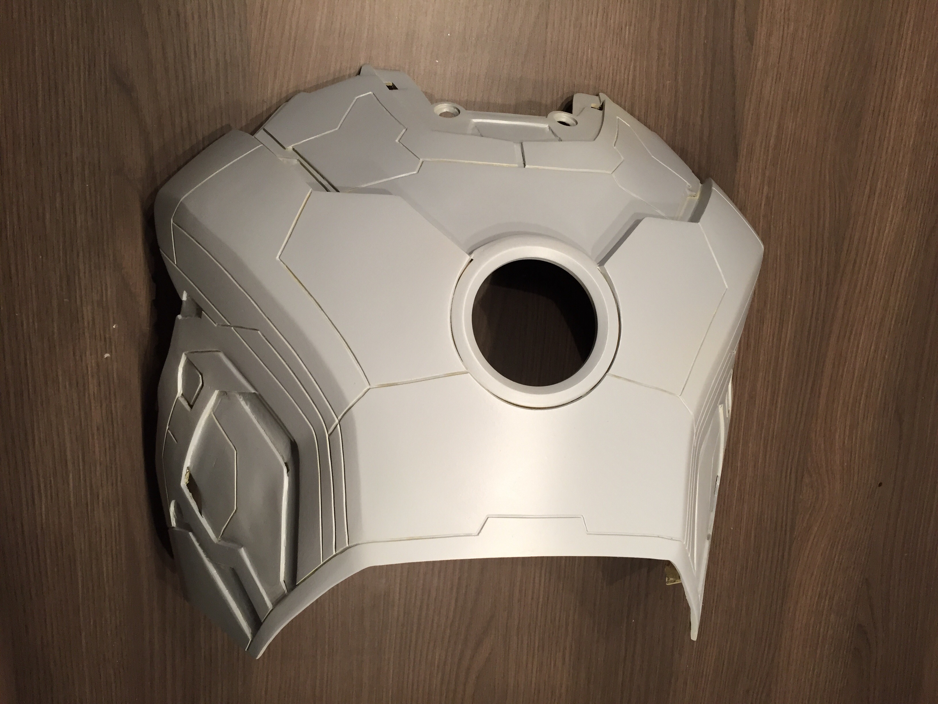

Chest finally ready for paint! But i think i will first paint it together with more torso parts.
next step... The back!
