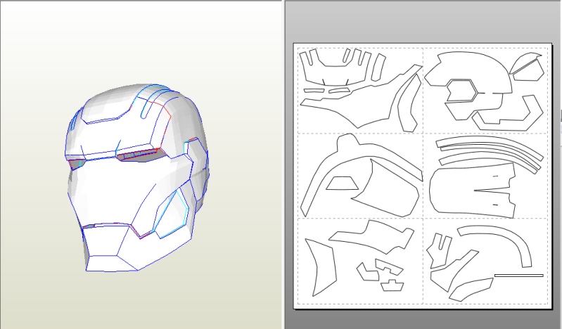

yo jackie, mind changing the link for the helmet file?
Iron Patriot Helmet by Jackieisrockin foam template by gaiatron(good scale) V2.pdo - 4shared.com - online file sharing and storage - download
this new one has the right scale that i'm using now and has guides for the details that you can etch incase you propsters dont want a triple piece faceplate.
forgot to post this yesterday. same technique im using for my 2nd helmet
What does this mean- the right scale? Was the first helmey scale off? Thanx GM
Re: Jackieisrockin's Iron Patriot (IM3) Pepakura Files! Links in first post! Neck add
done. BUT i think i done gooped and didnt scale it right because its very bobbly on my head. i understand this helmet gives a wider impression than the im helmets, but im thinking its too big. eye separation widths and face plate dimensions are on par with my im helmet. so im hoping i can tweak the jaw and use dowels to bring the helmet inwards to give it a slimmer look, and just hope it doesnt look like poo on me after ive resined it, etc etc.

If you guys are having problems with the scaling then pay attention to this.
If you look in the attributes, Jackie's default "assembled" size is height- 267mm; width- 187; depth- 241. However, that isn't the actual size of the default assembled size, but the size of the "box". Check out the attached pic- Point to Point measurement -"assembled" width is 178.77 and that's the outmost part of the helmet (inside temple to temple is 153.89).
My head is 23 3/4 circumference and I need the inside (temple to temple) with of 165mm. So for me to fit the helmet properly, I had to change the width to 199mm (height-288mm; depth- 260mm)
So Torx, you said your assmebled helmet looked to bobblehead. How did you manipulate your scale/attributes?
