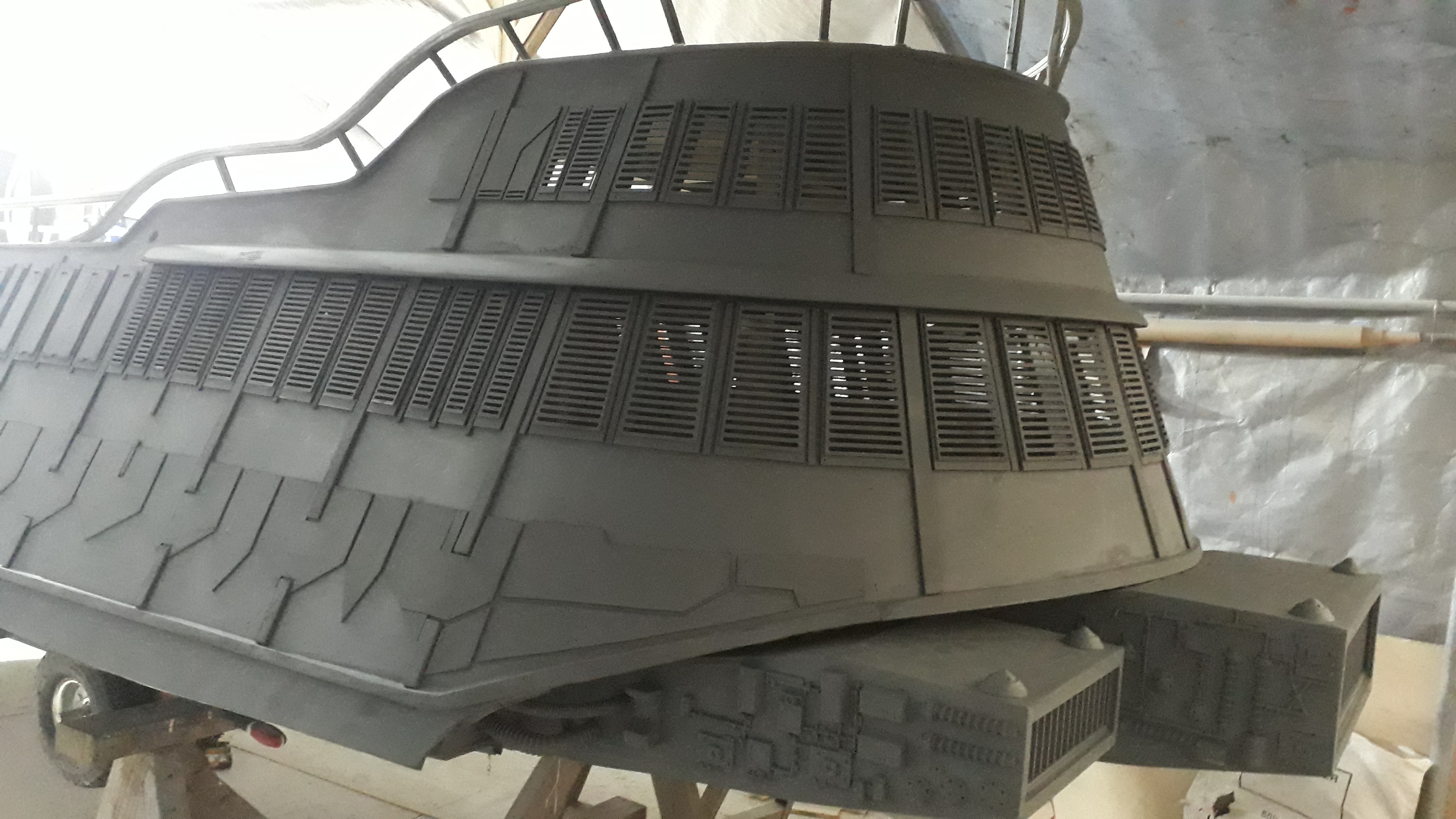

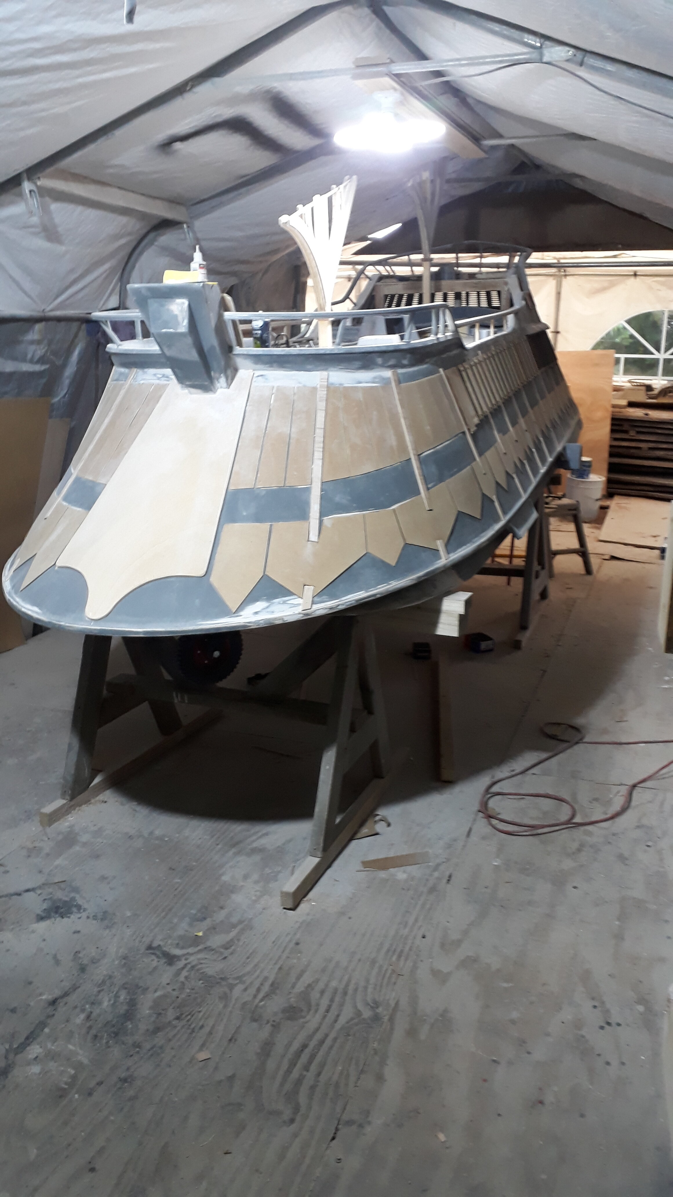

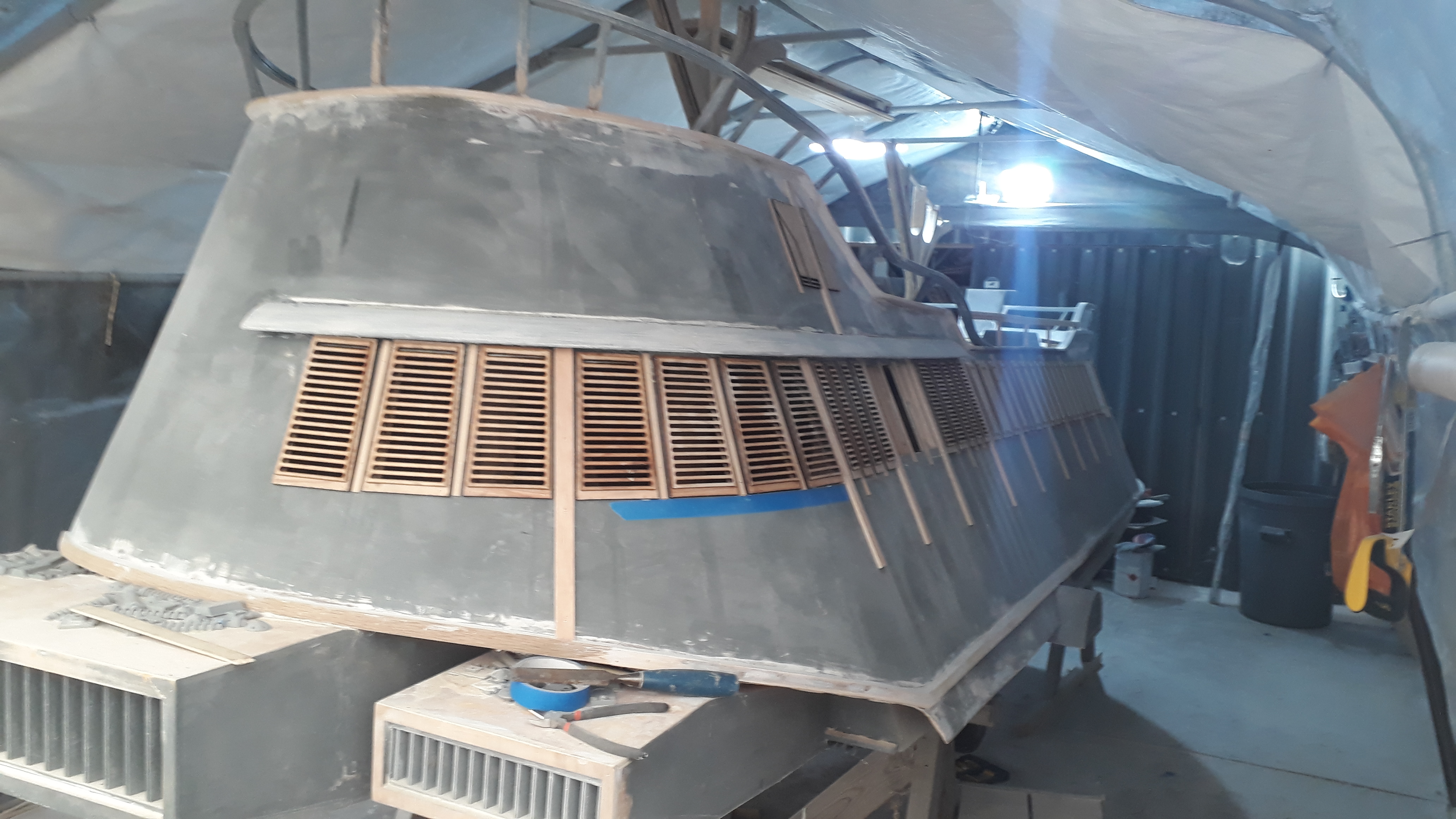

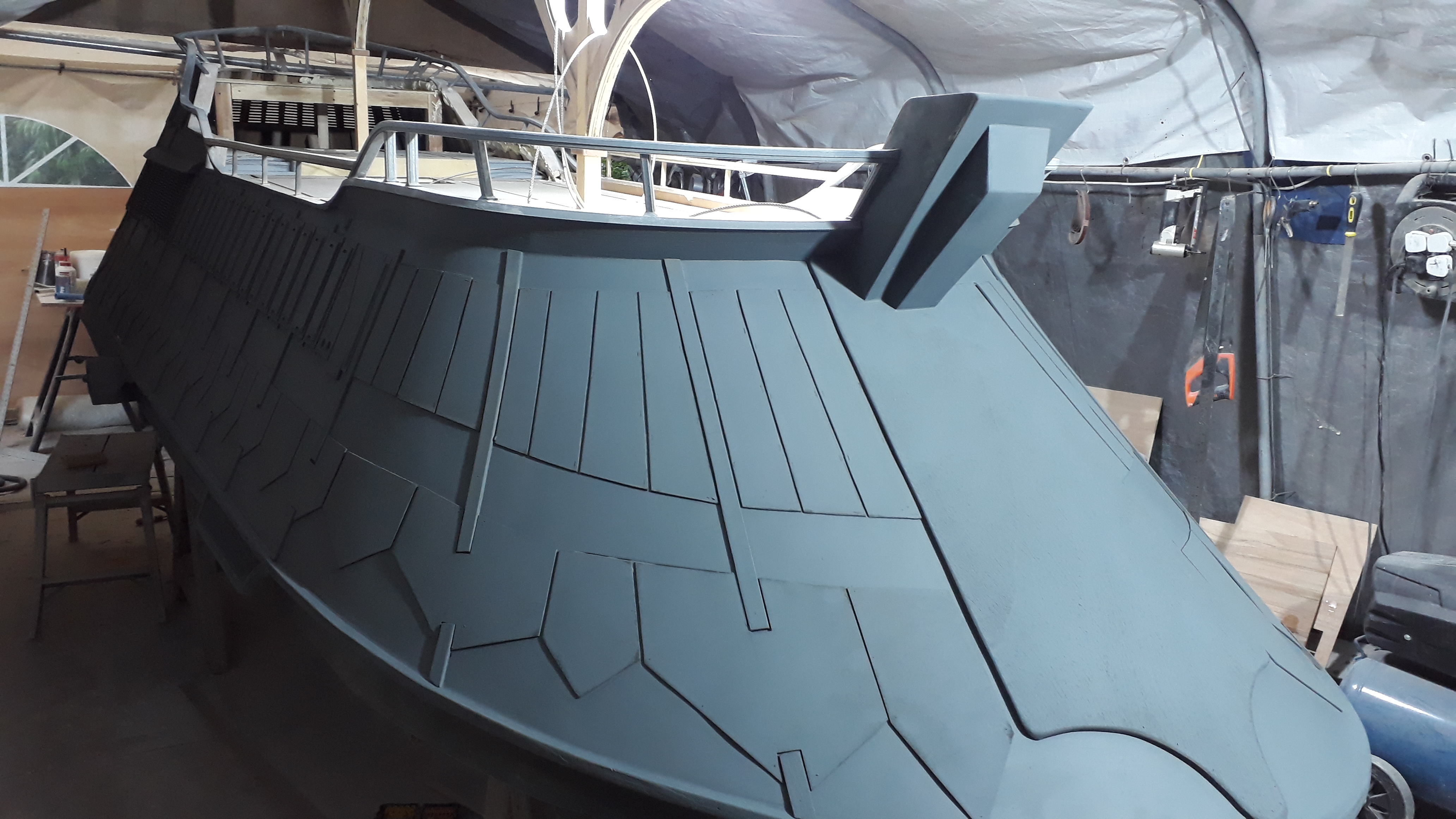

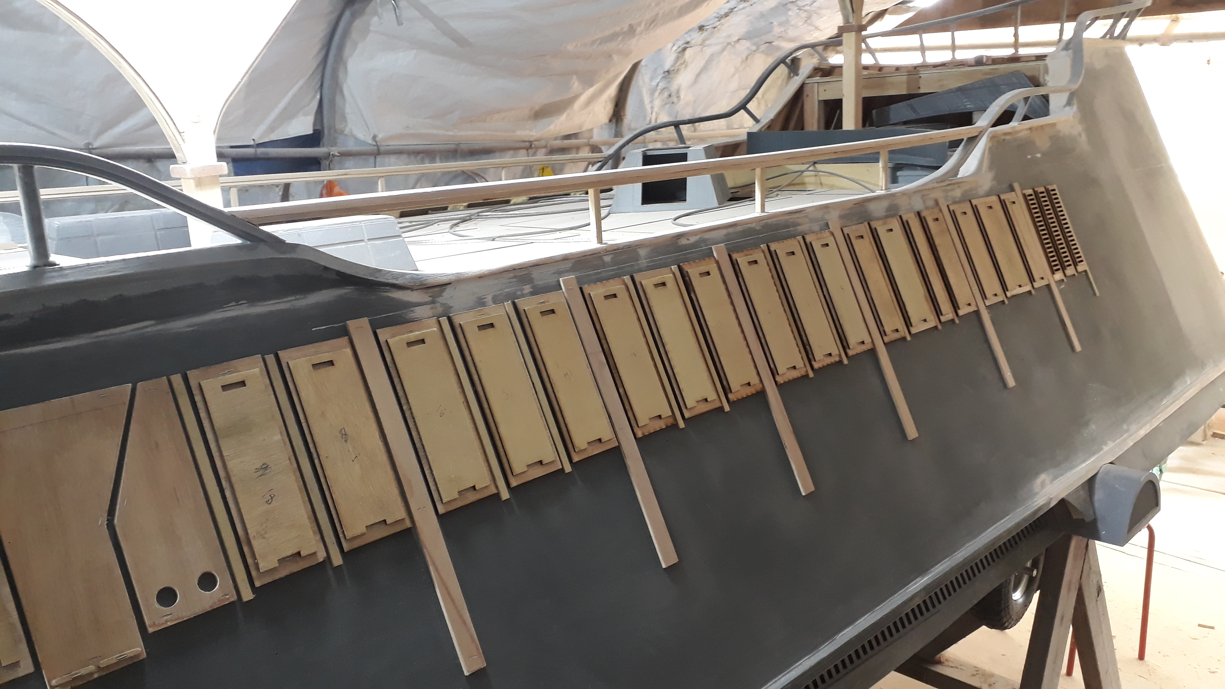

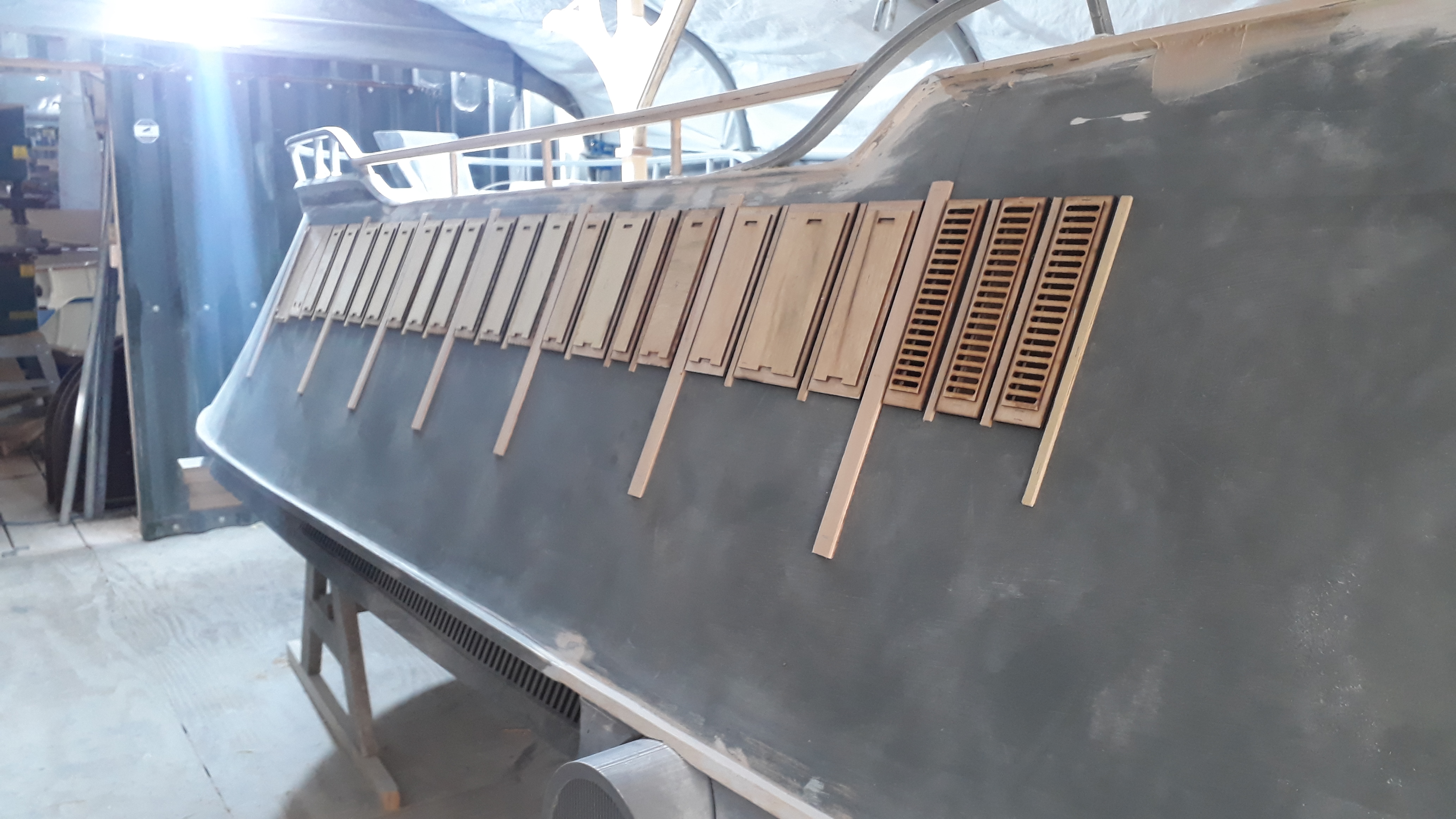

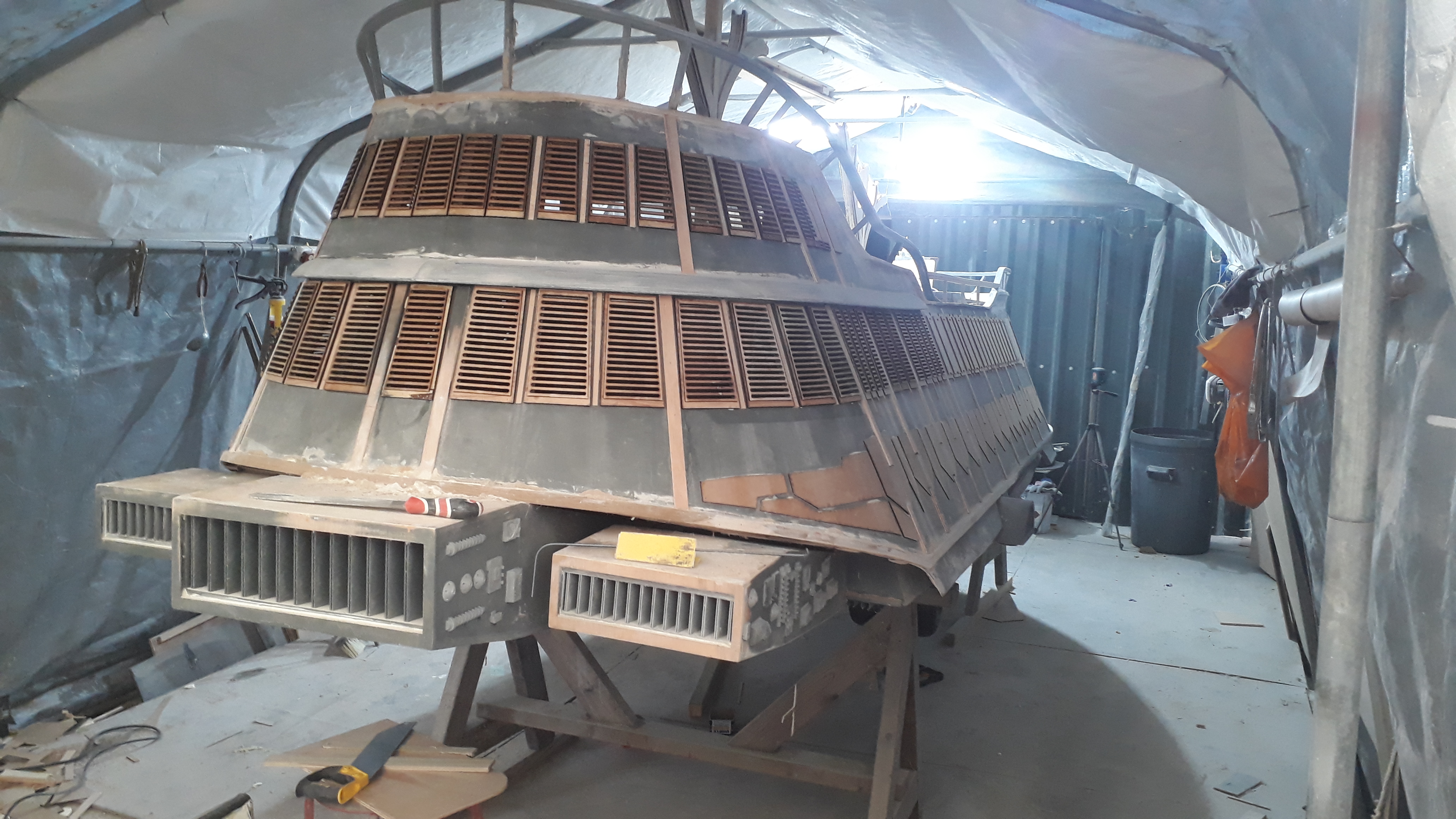

Ok so a bit more progress on the barge...started detailing the hull with the doors and windows;
View attachment 1466251View attachment 1466252View attachment 1466253
It never occurred to me before but there is no obvious way for Jabba to get in or out of this ship?
Through the cargo hold?
oh this is starting to look awesome! really impressed with your huge builds as always! thanks for sharing (y)
Just found this! This build is absolute madness in the best possible way, truly truly epic, cannot wait to see the final product.
Are those window hatches made out of wood?
Yes, they're laser cut from plywood

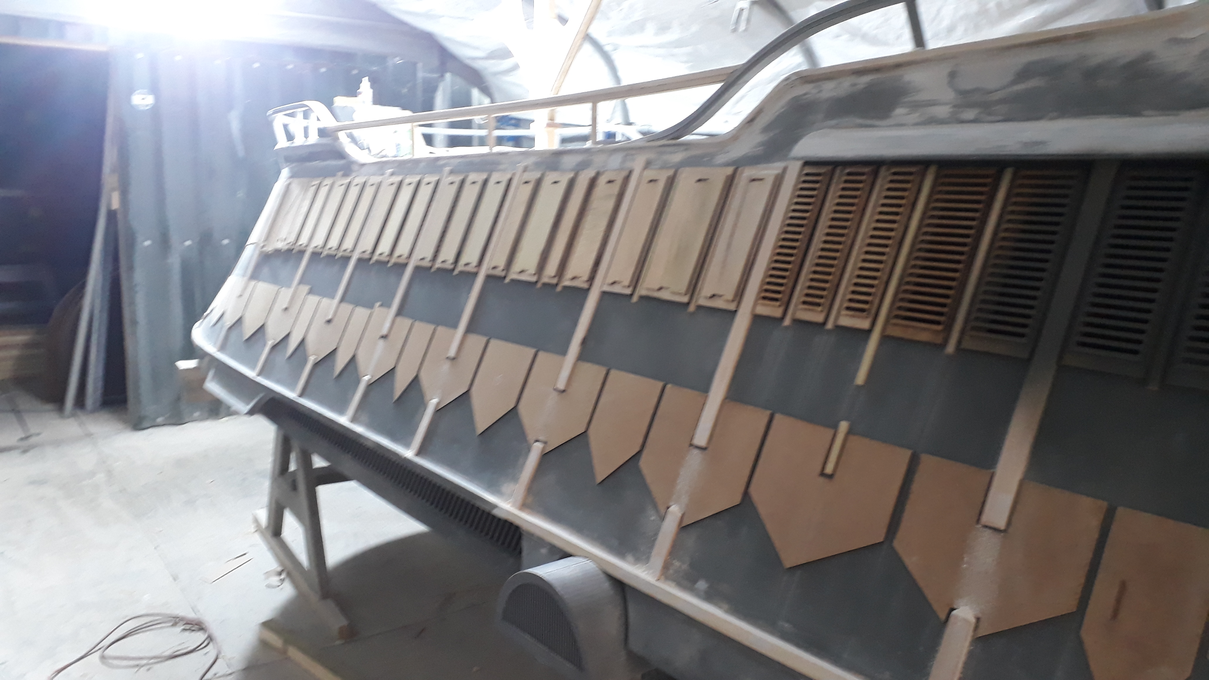

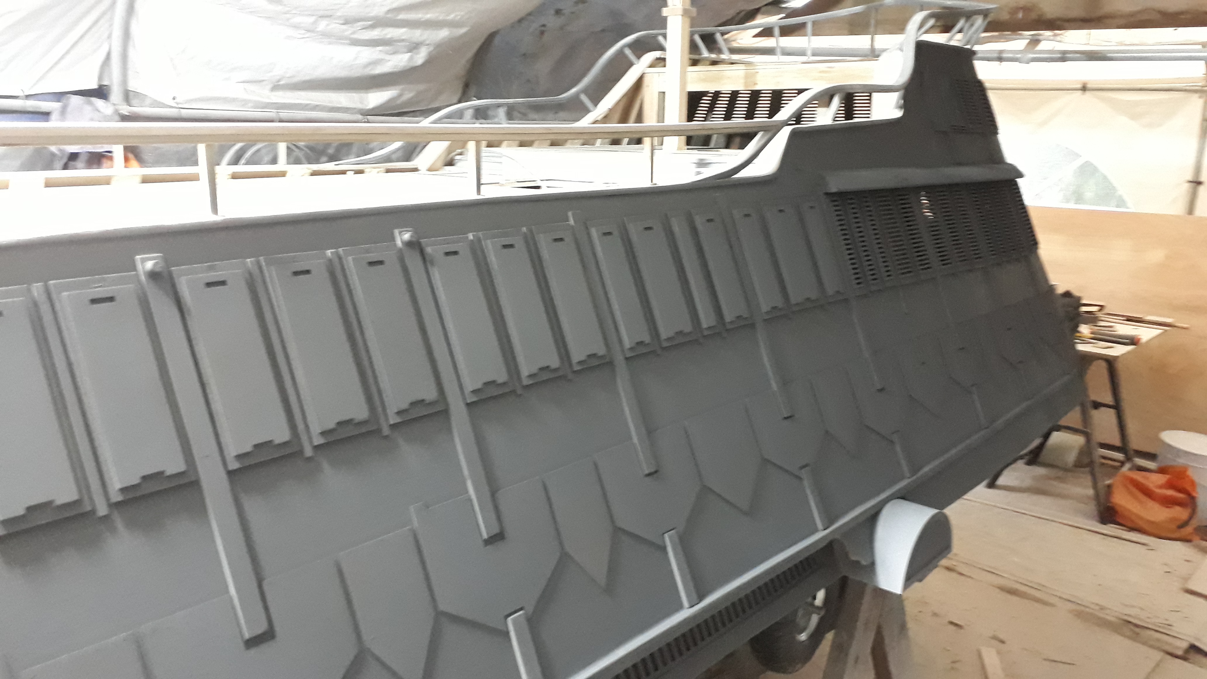

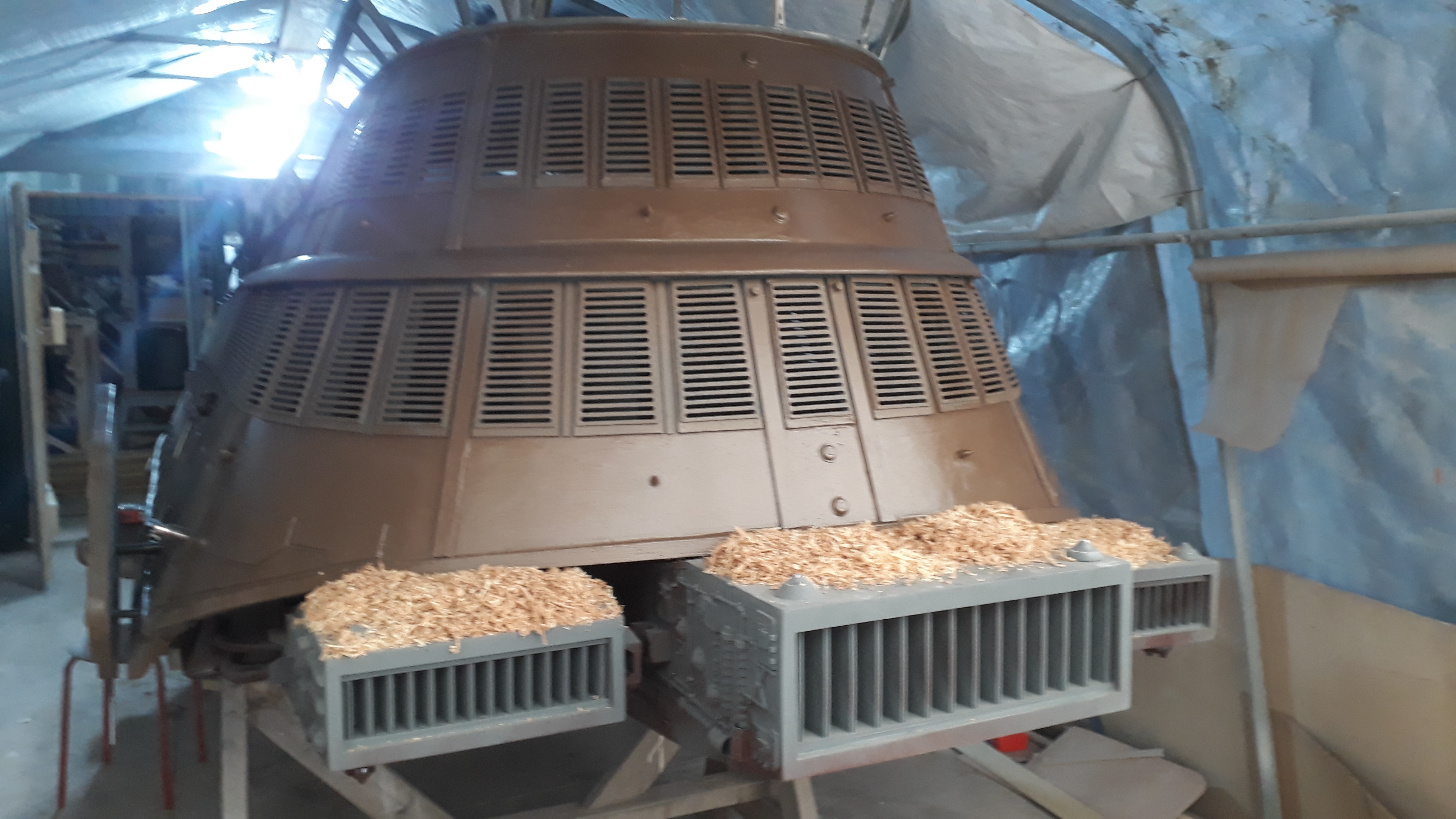

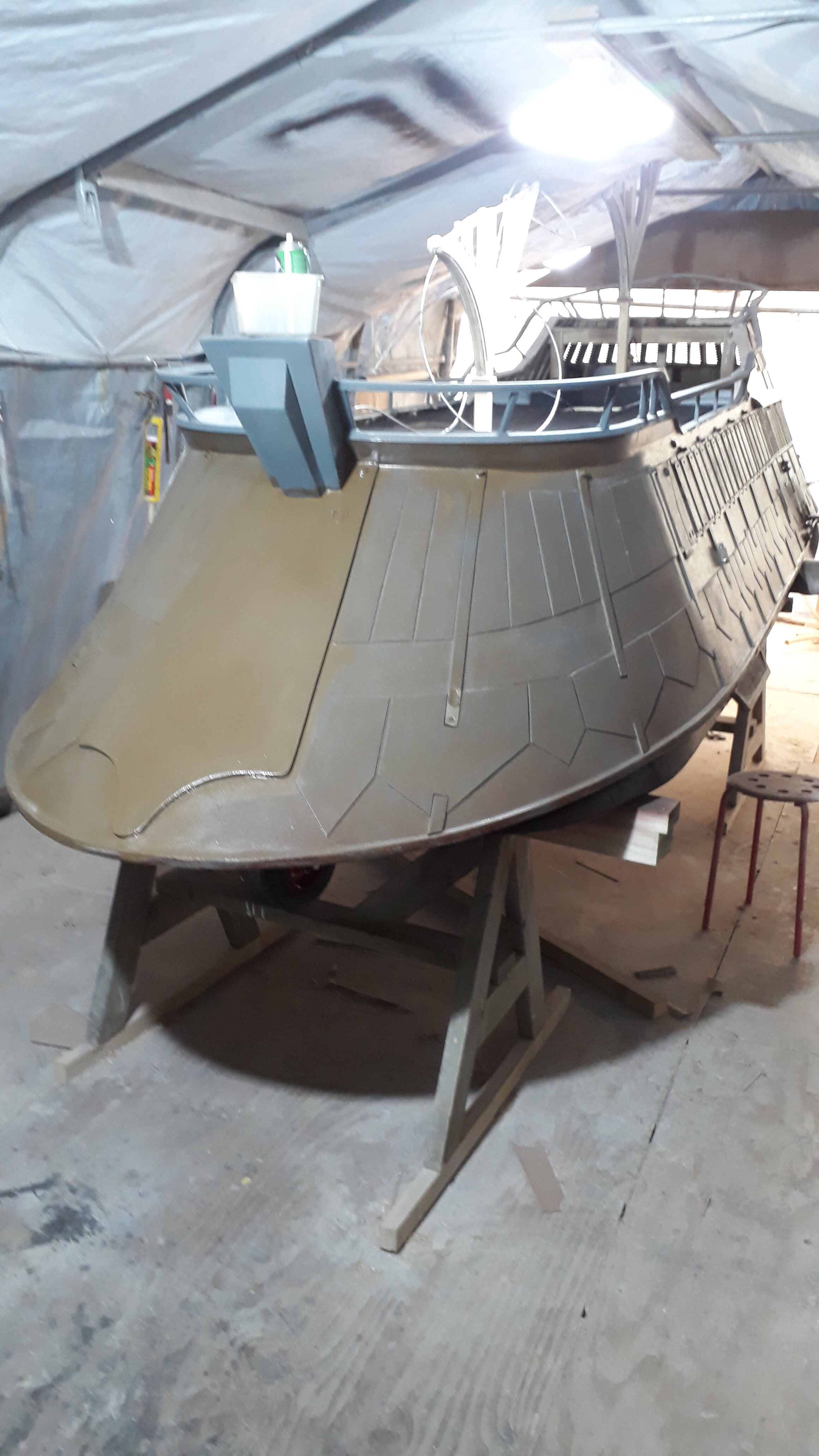

Ok, so I've finished detailing the hull;

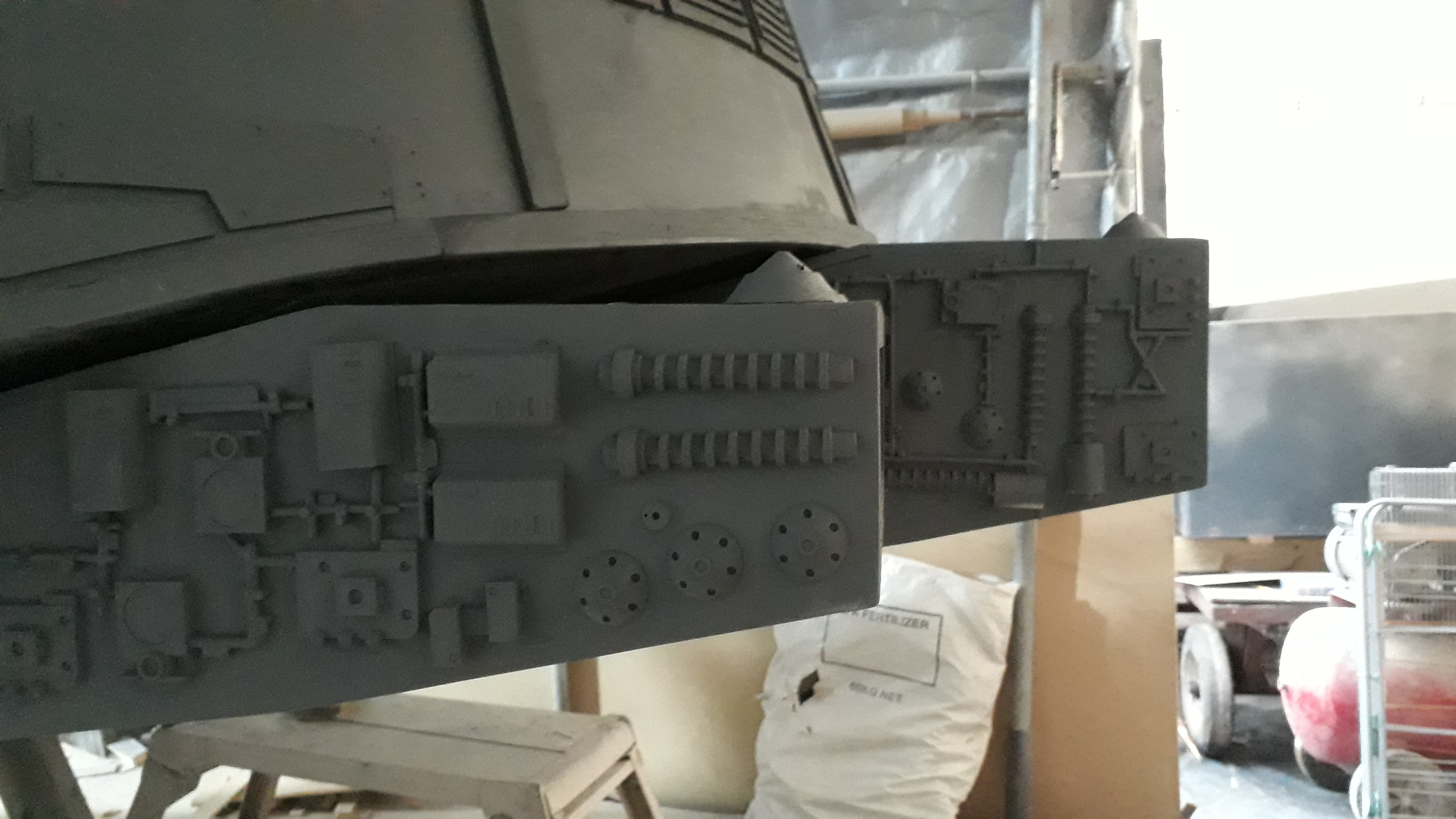

got the greeblies fitted round the engine boxes and primed it all for painting
Next to do is fitting the rudders and tackling the sail stringers

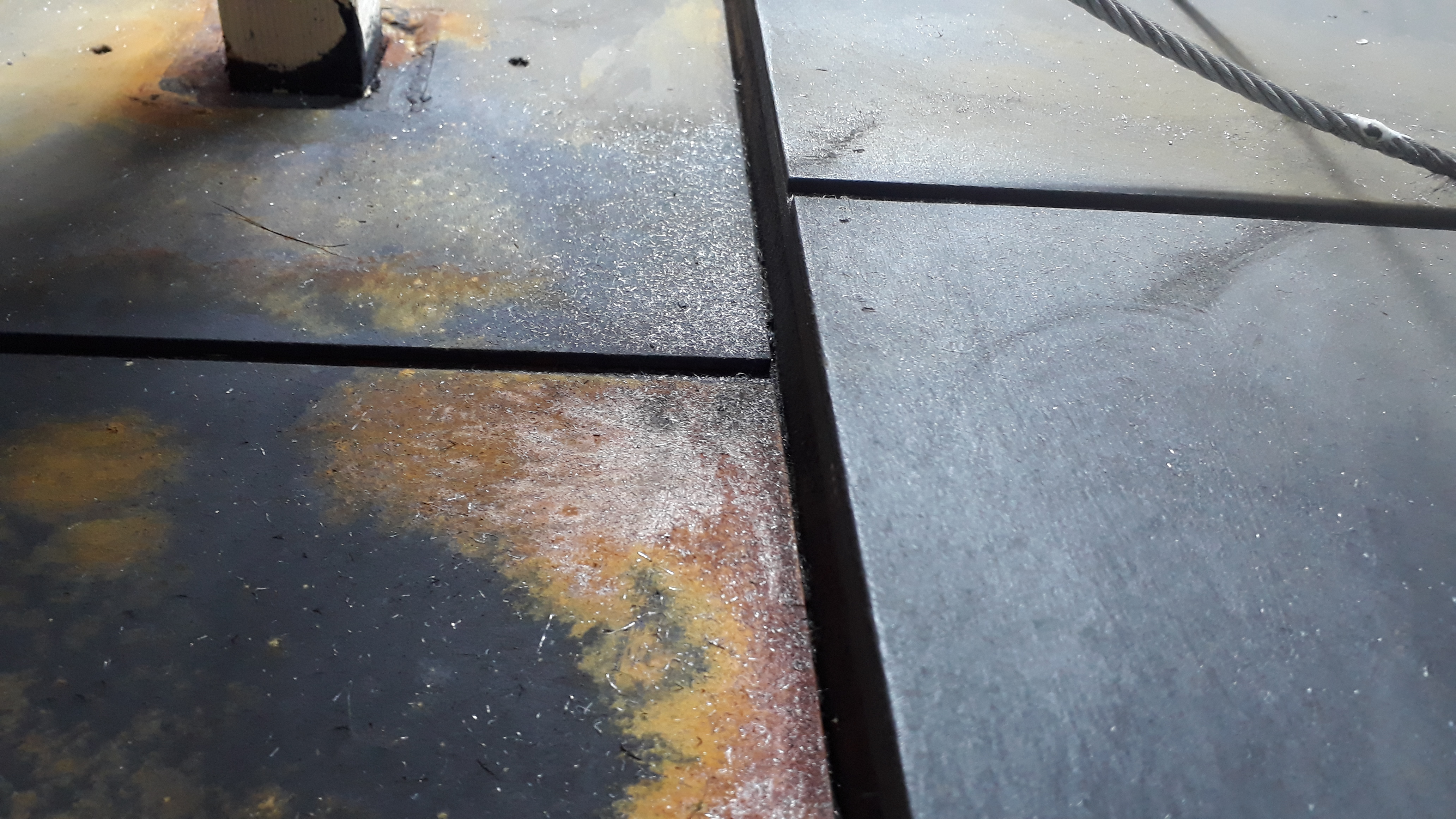

So, I am experimenting with paint finishes for the hull and deck

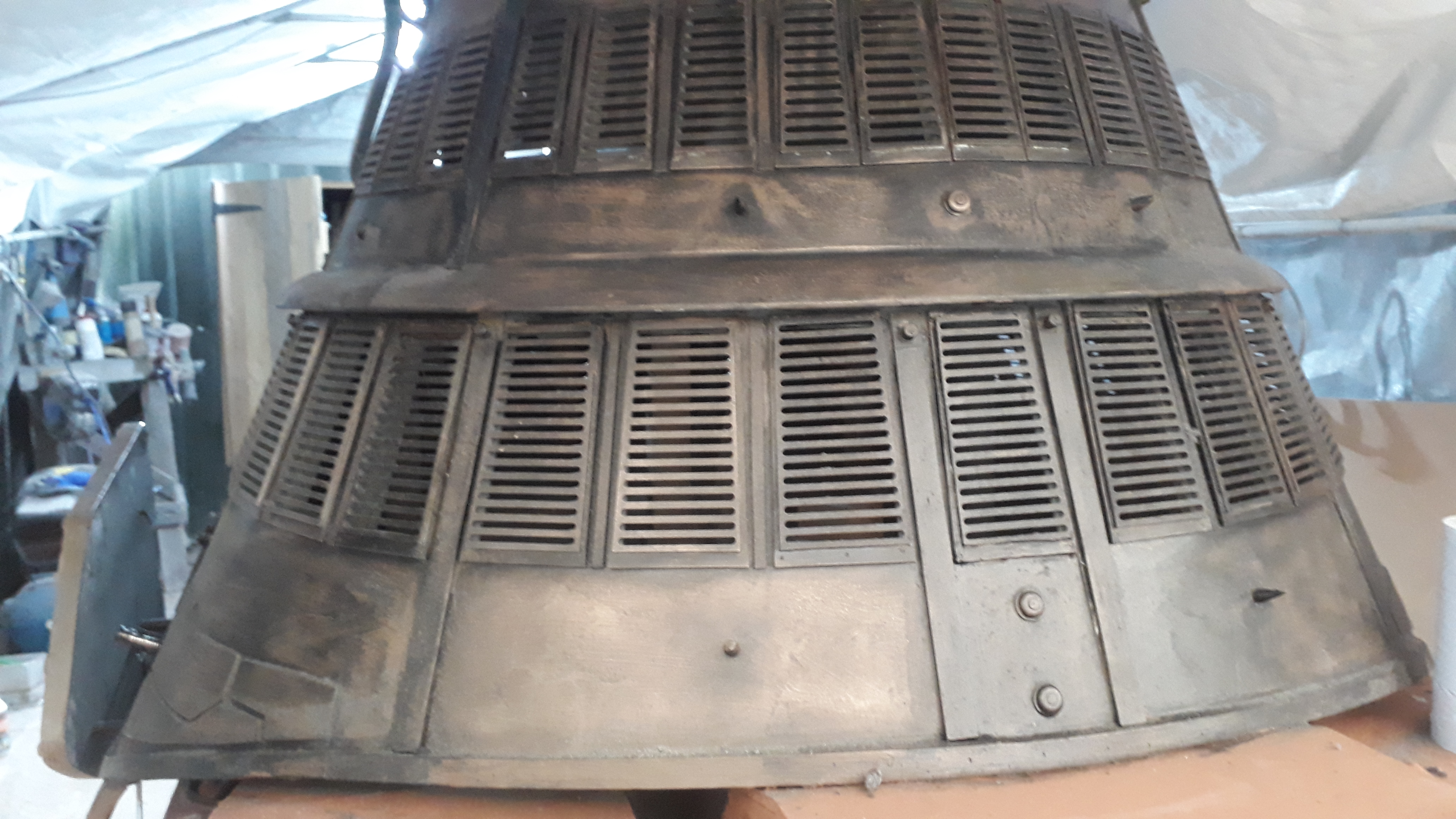

The hull is gonna be like an aged/rusted bronze effect...I've loaded polyester resin with cold casting bronze powder and painted it on. Then poured ammonia into sawdust to create the fumes that will hopefully tarnish and darken the surface which I will buff back with wire wool

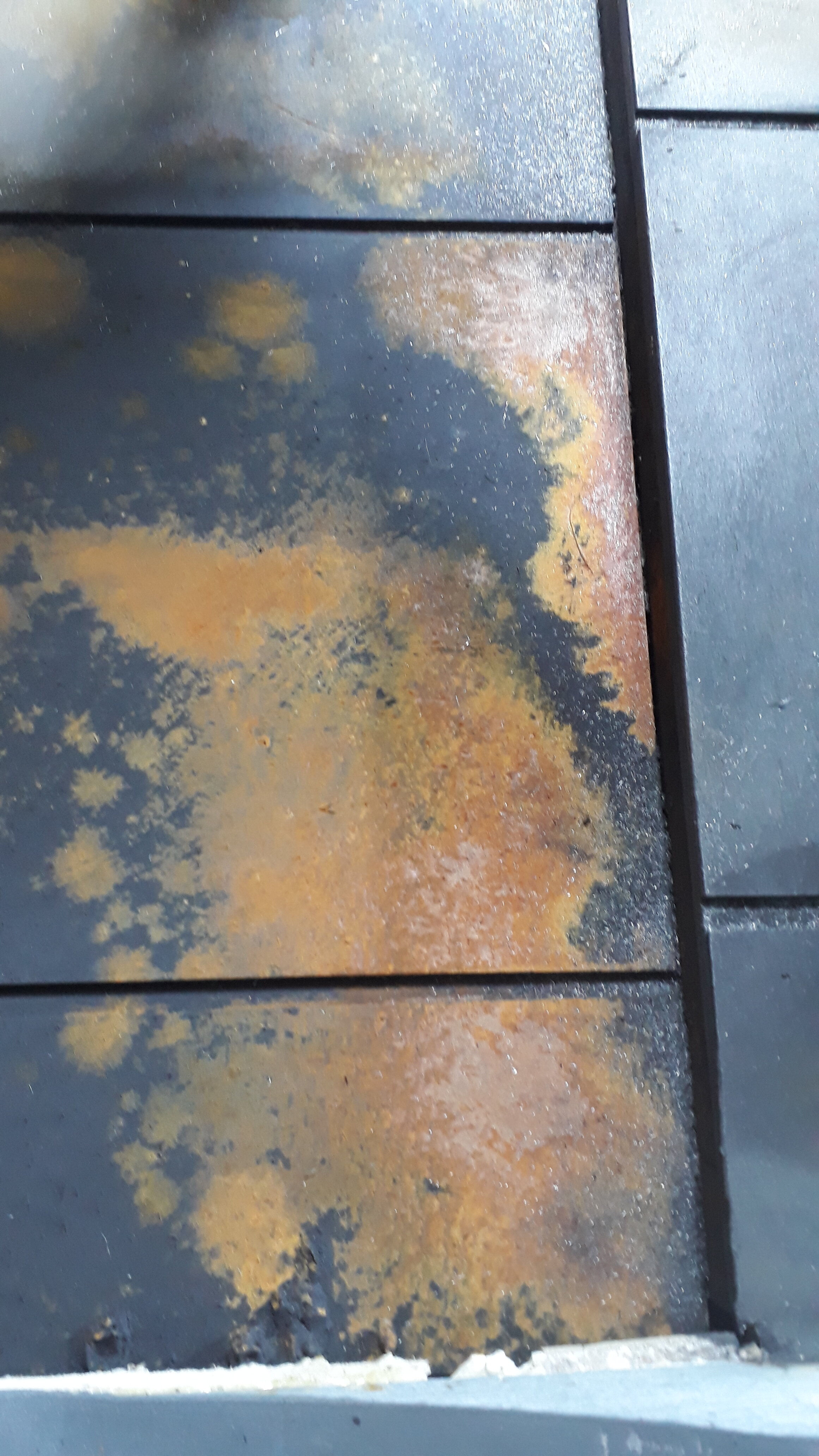

With the deck I want to achieve a distressed black metal effect. So I added Iron Oxide powder to black acrylic paint and applied it to the deck. Then spritzed it with lemon juice as a catalyst to bring out the reactive element in the paint
I'll post some pics in a coupla days when it's had time to react

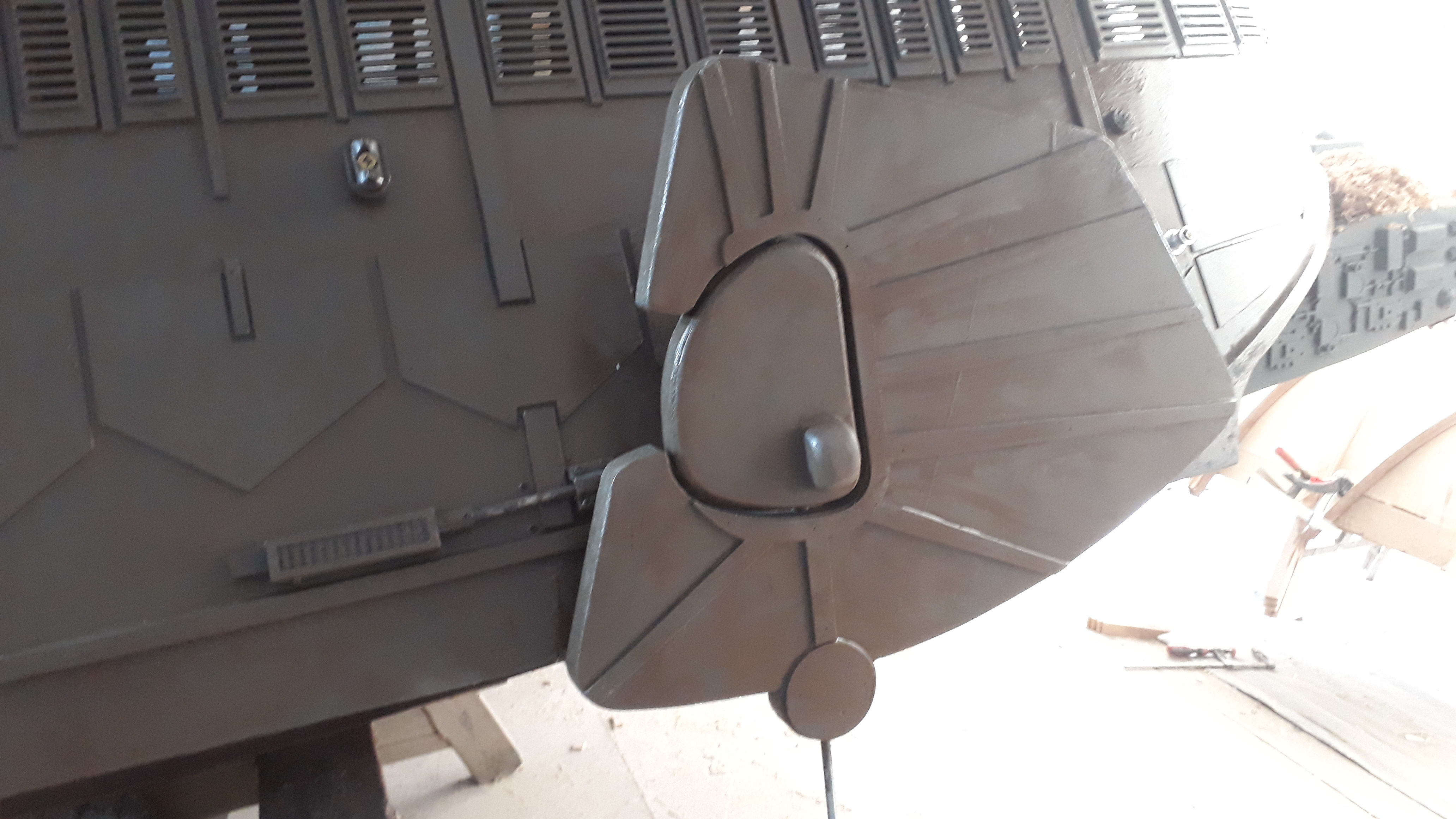

Also fitted the rudders

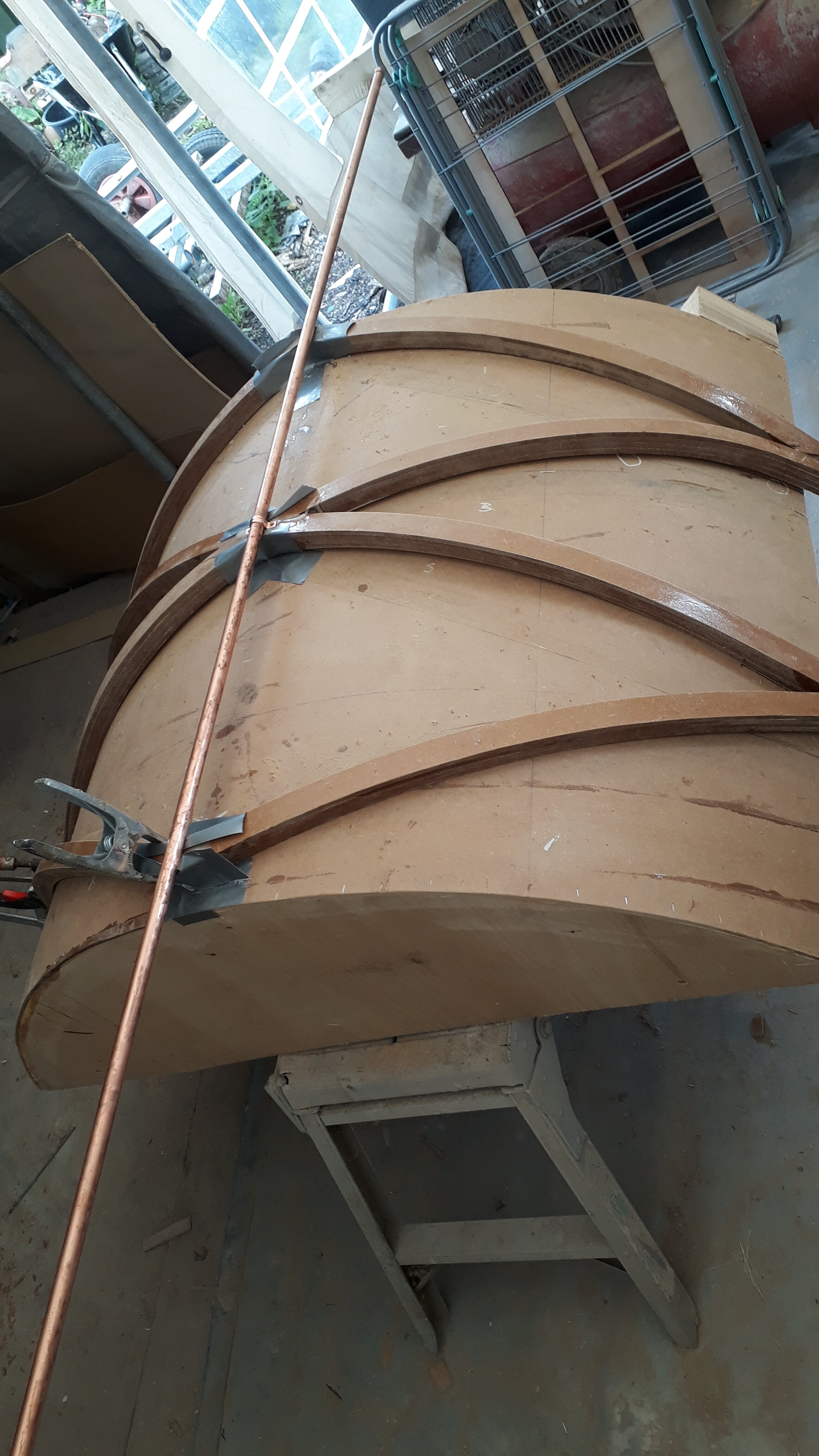

And got my head around the sail stringers. I started by steaming Elm battens but they really weren't gonna be strong enough, so I switched to laminating with ply and epoxy
Yep, another of my fix mate:p(y)(y):notworthy::notworthy: Love the way you're approaching that paint job to imitate various metals. Interested to see the reaction of the lemon on the paint!

Interesting use of wood shavings & saw dust.
I am sure you will, but when using a large container of NH3, make sure the opening is above your nose. As a student chemistry lab assistant years ago, I opened a large container on the floor to fill the small eye dropper bottles for the next class. This large glass container was half full and apparently in the sun coming from a window. I woke up on the floor.
Quick update; Iron oxide with lemon juice worked pretty well. I ended up just loading black acrylic paint with the powder and spritzing that when it dried;
I will buff this back a bit but it will act as a base coat for the final deck
The Ammonia blackened the Bronze powder so I'm going at it with wire wool to expose the metal;
