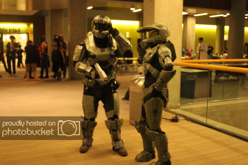

Now I have a week till BigWow in which im hoping to attend on sunday in this suit, but if not I got a spartan back up, and will for sure get this suit done by Fanime in San Jose.

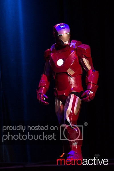

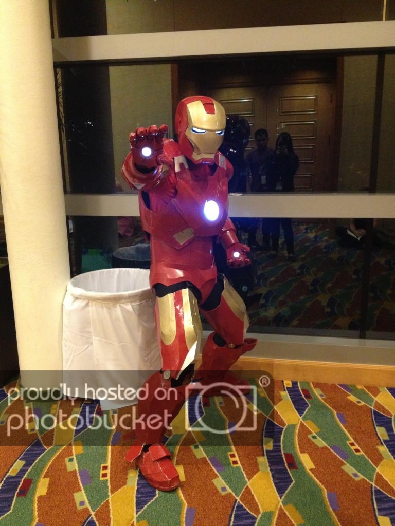

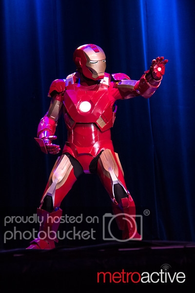

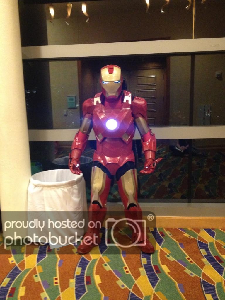

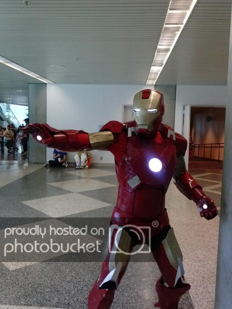

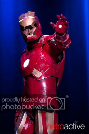

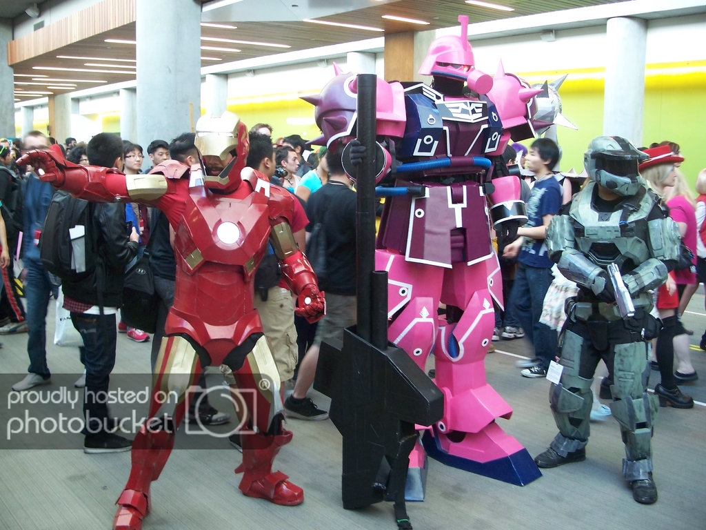

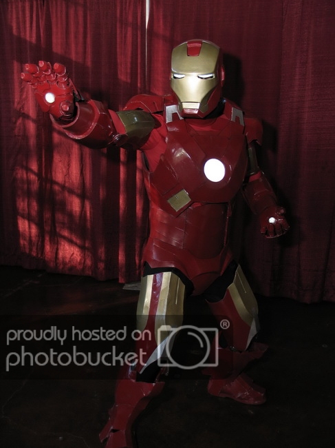

Well Fanime 2013 in San Jose California has come and gone, and i just barely managed to get my suit done, didn't have time to motorize anything but now that it's over I will continue to refine my suit. here are pictures and video of my walk on. compliments to the people that took the pictures! =)
so far this is one of my favorite shots taken
here are some fun shots from fanime:
