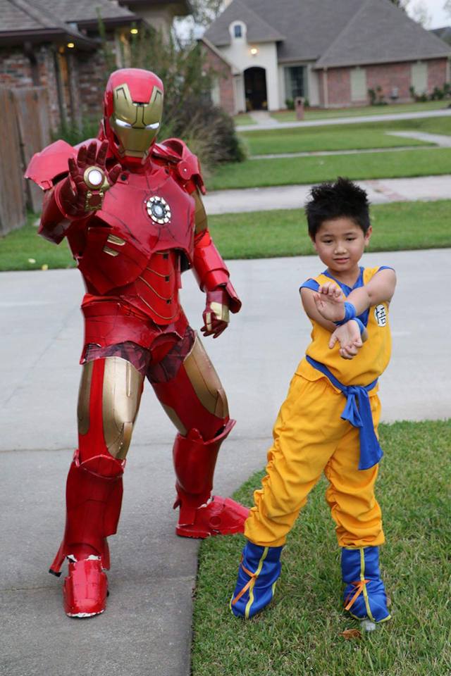

On top of my helmet there is a HD mounted Camera, center forehead. that camera is powered by a 12volt battery pack in my back cover, and will last 12 hours, and inside my helmet, I used my theatre glasses that has the led, 70" screen built in it. which allows me to see the camera view.
The camera has night vision up to 50 feet, and that is how i did it. works great, and nobody spotted the camera till
i told them where it was. The theatre glasses I had extended to long, and the face shield couldn't close, so i disassembled it and fixed it on the
Safety glasses so it sit flush behind the face shield, and mounted the LED light to shine through the eyes.
this was done in 2015, thought i share this idea to those who want to see through the LED eye.
Very cool! What sort of a field of view do you get? Do you find that you bump into things?
its off by a bit, as long as you look in the direction you want to touch or do things, you're ok, as you can see in the pic, i tilt slightly down to look straight. i guess similar to like iron man in the films. first 10 mins feels off, but once i have it on for 15 mins and on, i get used to it, feels normal.
This seems really cool! Can you provide a picture up close of where the camera is located? Also how expensive was this to create? Thanks!
