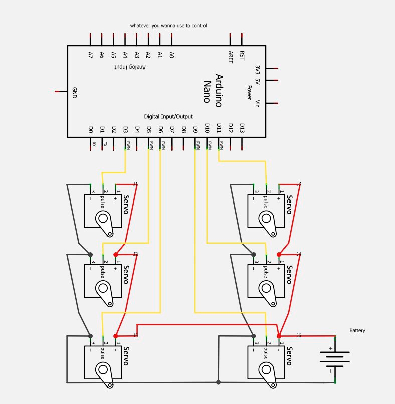

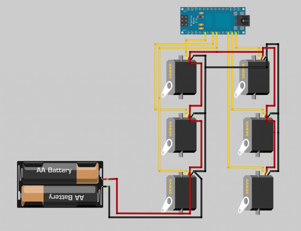

LOL, the 6 servos will need 4.8V to work. They will be linked to the battery in parallel.
1 servo = 4.8v
6 servos = 4.8v
290 servos = 4.8v
over 9000 servos = 4.8v
follow this:
A more graphic version inside the spoiler
@JWMines
1 servo = 4.8v
6 servos = 4.8v
290 servos = 4.8v
follow this:
http://i3.photobucket.com/albums/y87/oozi/alltheparanaue_zps0d4b15ae.jpg
Thankyou so much! Yeah sorry about that not to experienced with electronics but this really helps out thanks! :)
