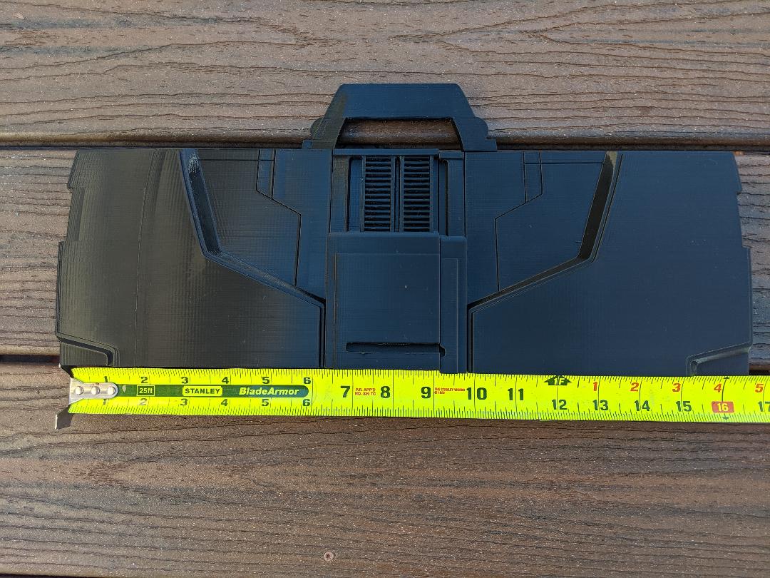

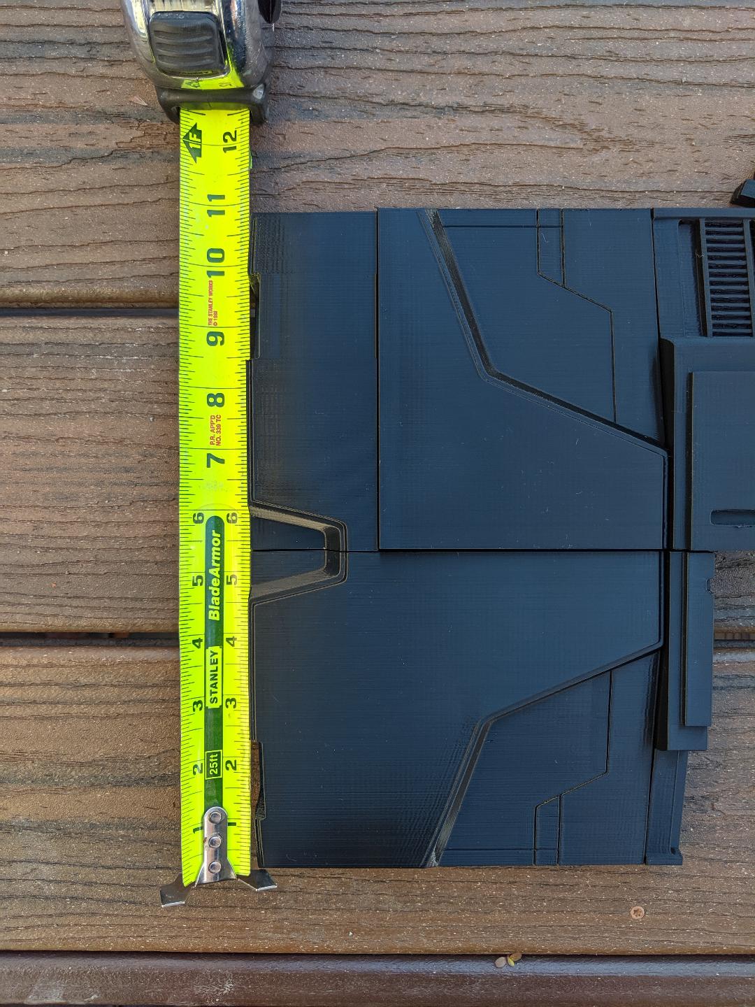

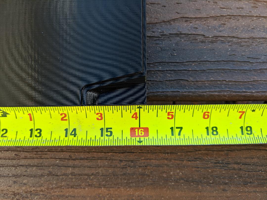

So I started to 3d print a Iron Man MKV briefcase and after the top half was done it seem too small. After looking at screen shots from the movie it seemed really small.
