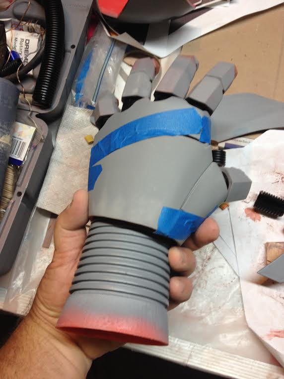

I had disassembled the back armor that I previously tacked together with hot glue dots. This was done to make sure the chest lined up properly. Anyway, I've been slowly smoothing the back panels and now I'm putting them all back together. I found that a hot glue gun works wonders when attaching large parts that only have a small connection. You can almost weld and glue the parts together at the same time. I used super glue to align them, then weld/hot glued them from the back to create a super strong bond.

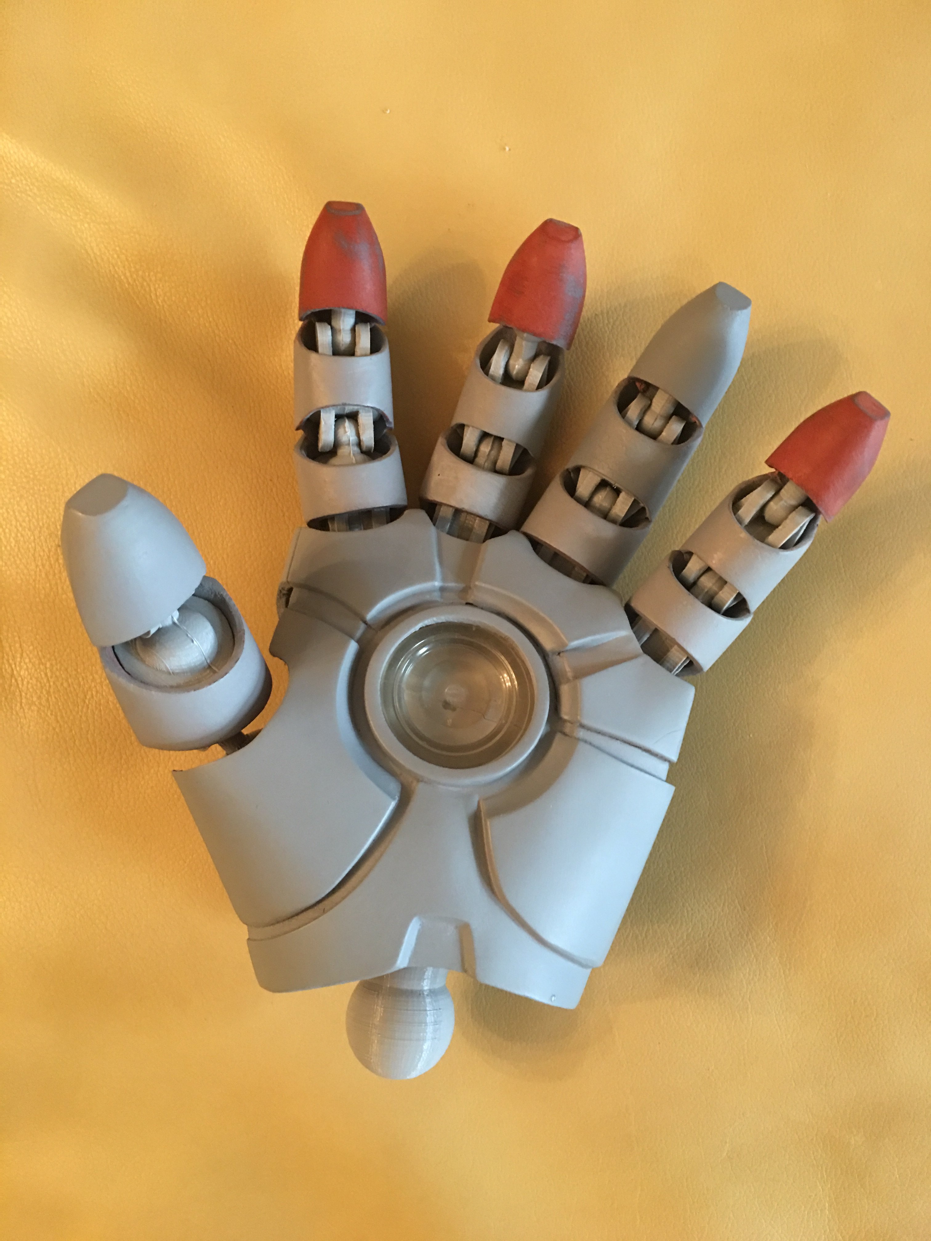

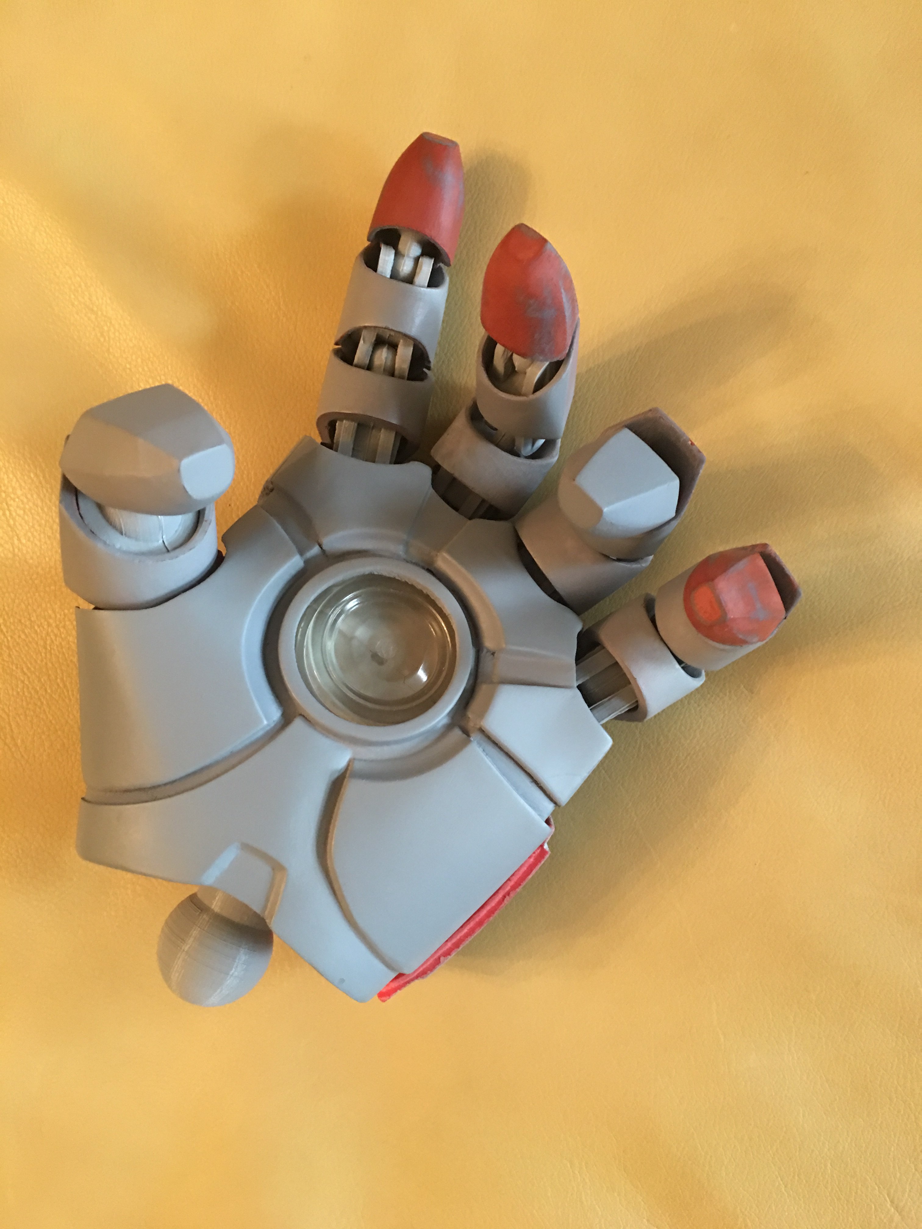

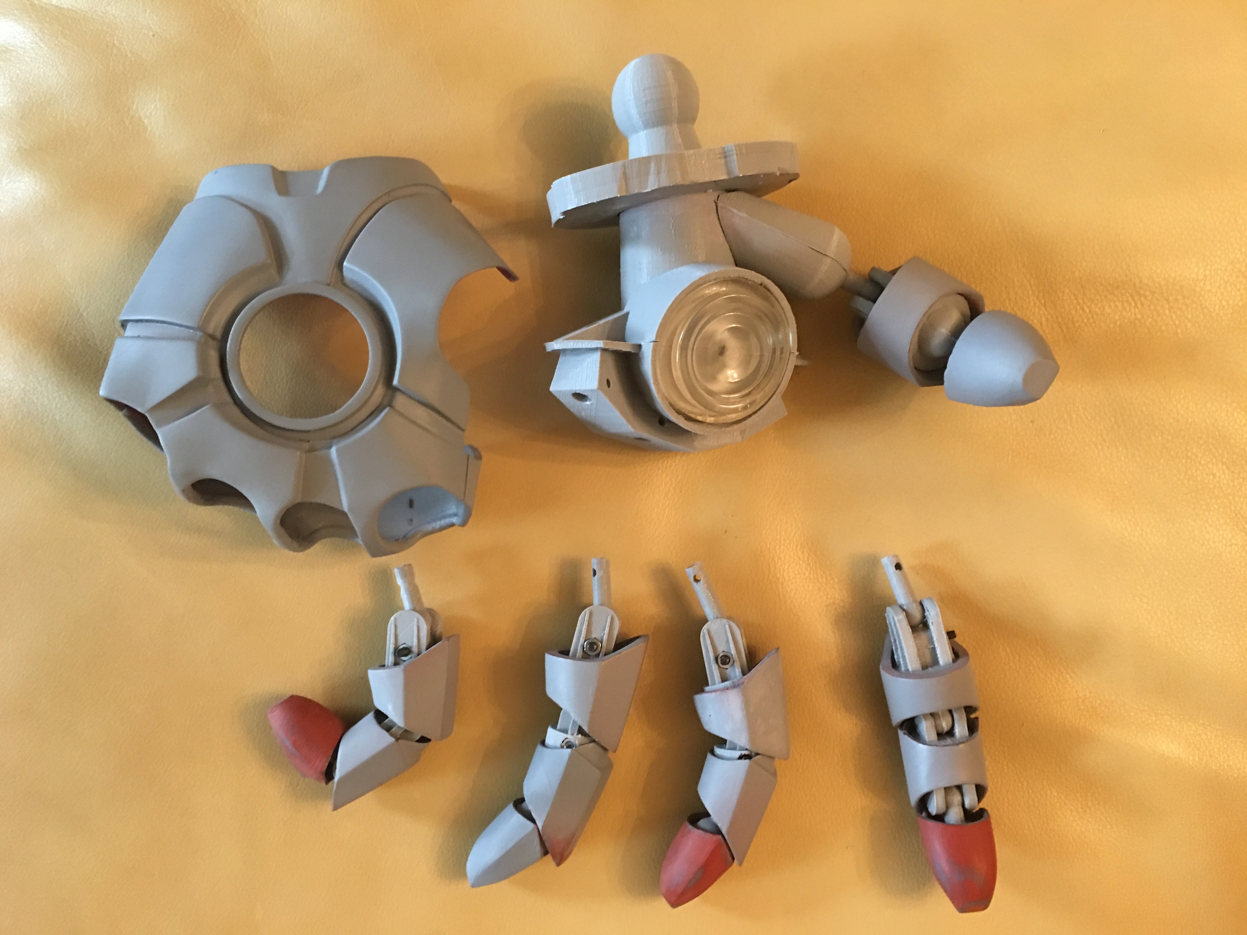

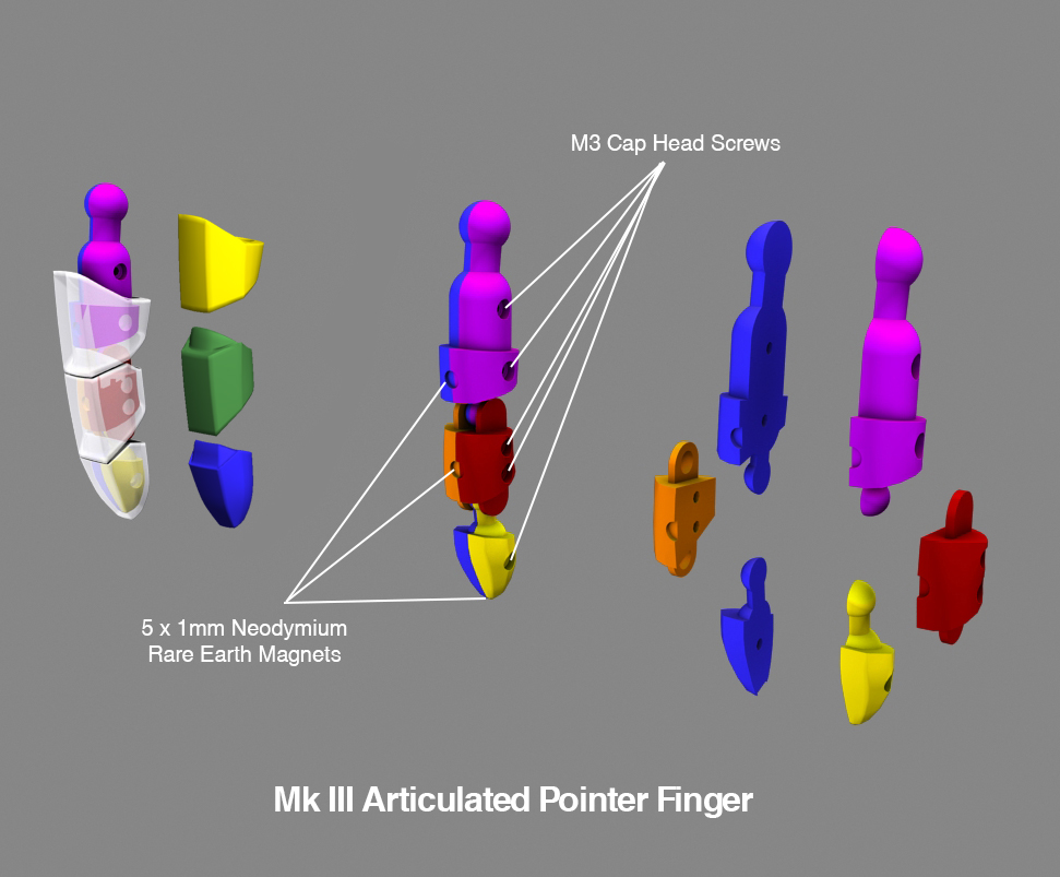

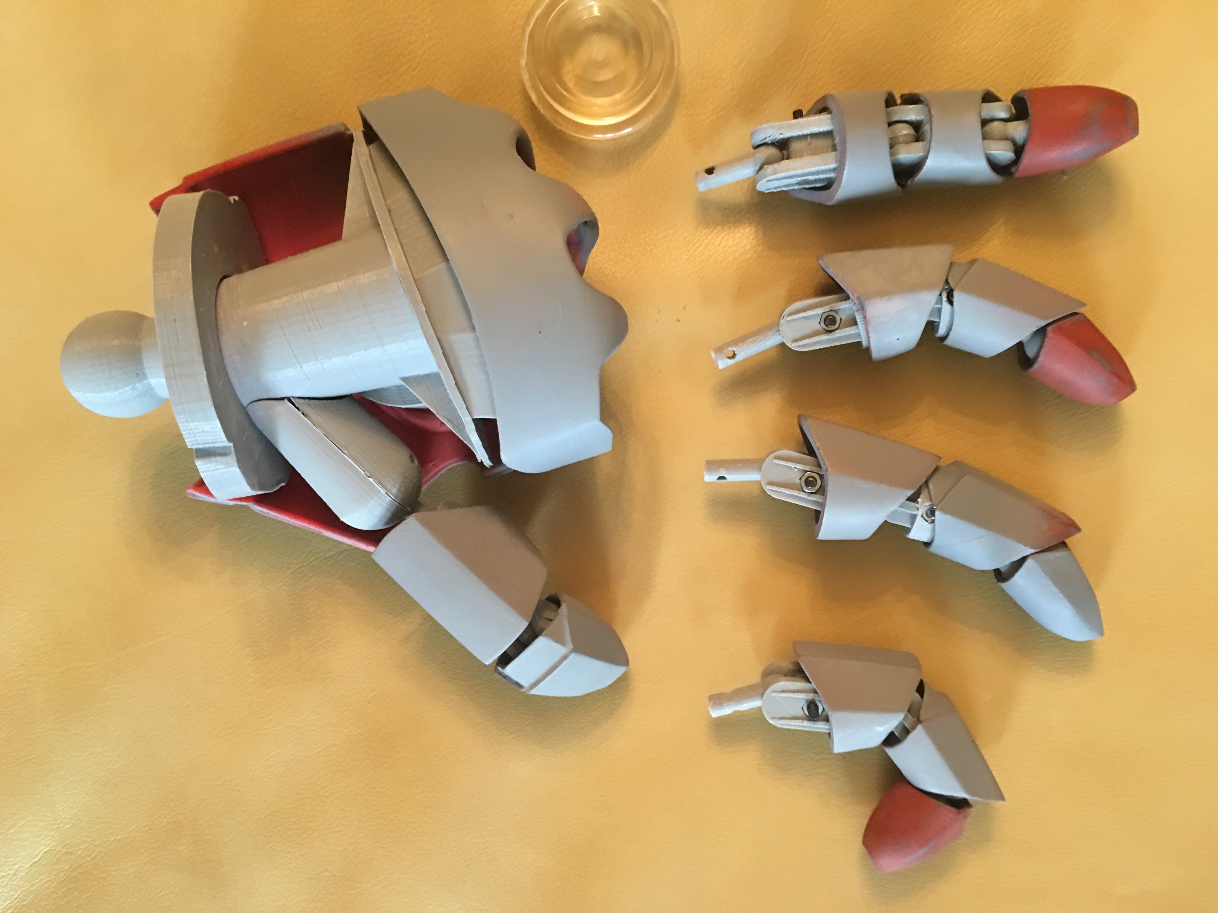

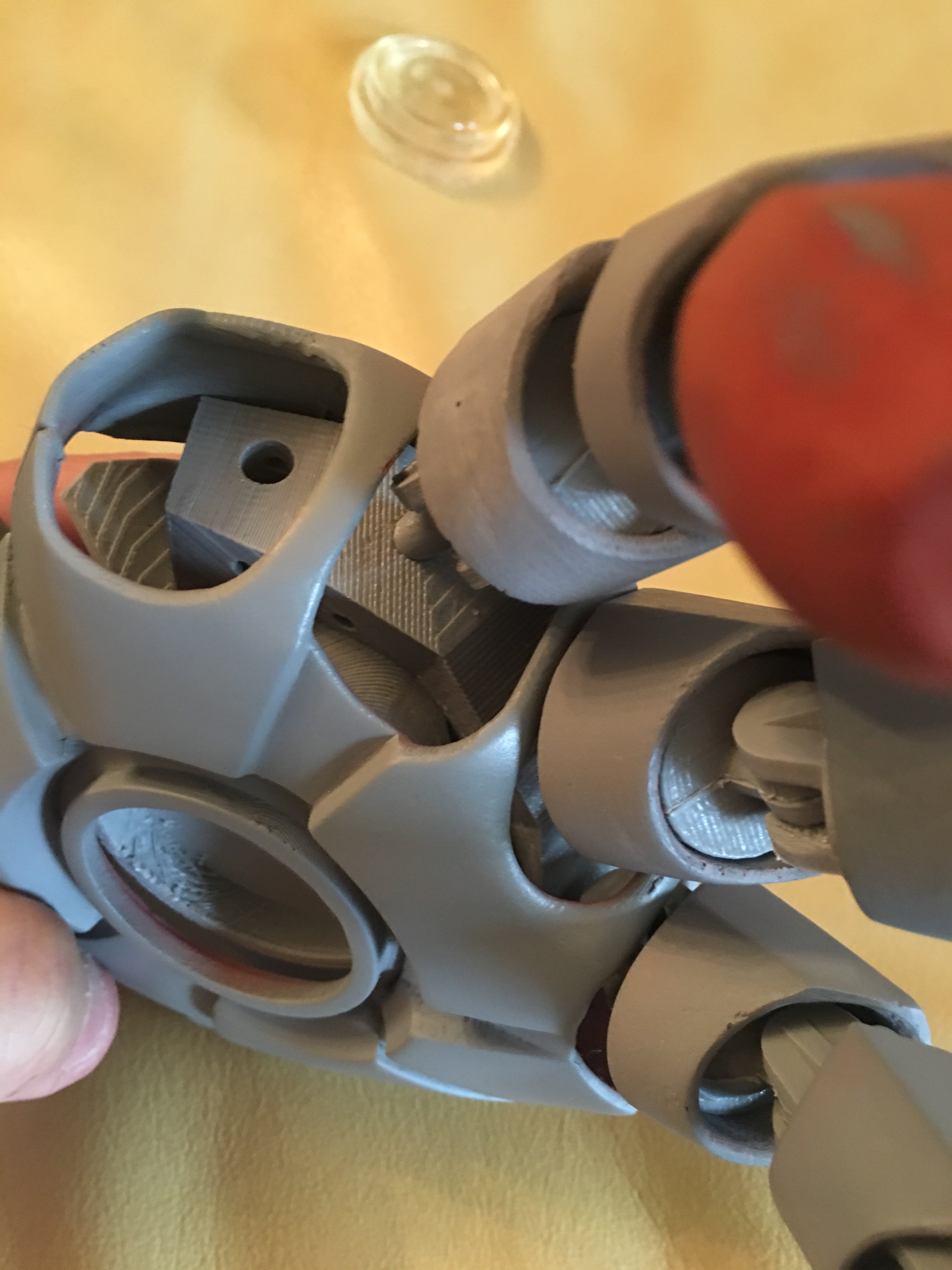

ALSO: Since my new printer arrived I decided to upgrade the skeletal structure. As shown a few posts up, I was using wood and wire for the fingers and hand. This is ok, but I found that the wire would slowly lose its bend not to mention I would have to glue the armor to the skeleton which I'm kinda hesitant in doing. I'm going for a full size action figure display here, so why not make it as articulated as I can? What if I get sick of the pose?... So I started working on printing out a tight fitting skeletal structure that include little neodymium magnet. So far it works great! I plan to have fully poseable fingers/hands with the lighting built in to the palms as well.
Here's a render of the pointer finger. I'll post actual photos or video soon.

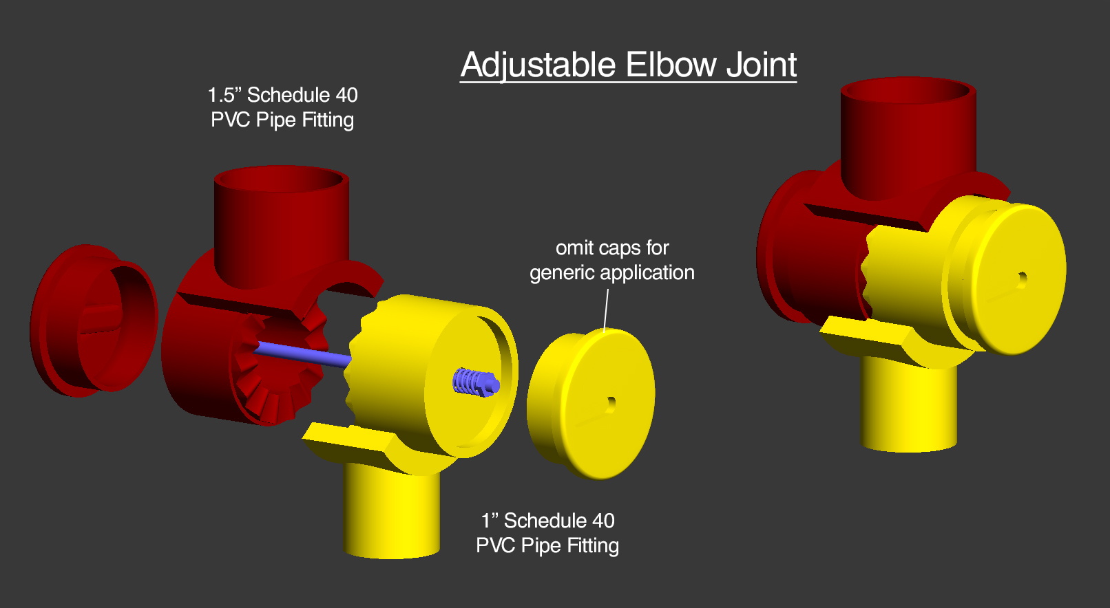

So i guess after the hands are done, I'll move on to upgrading the other joints with 3D printed parts that still utilize pvc pipe as the bones... stay tuned.
