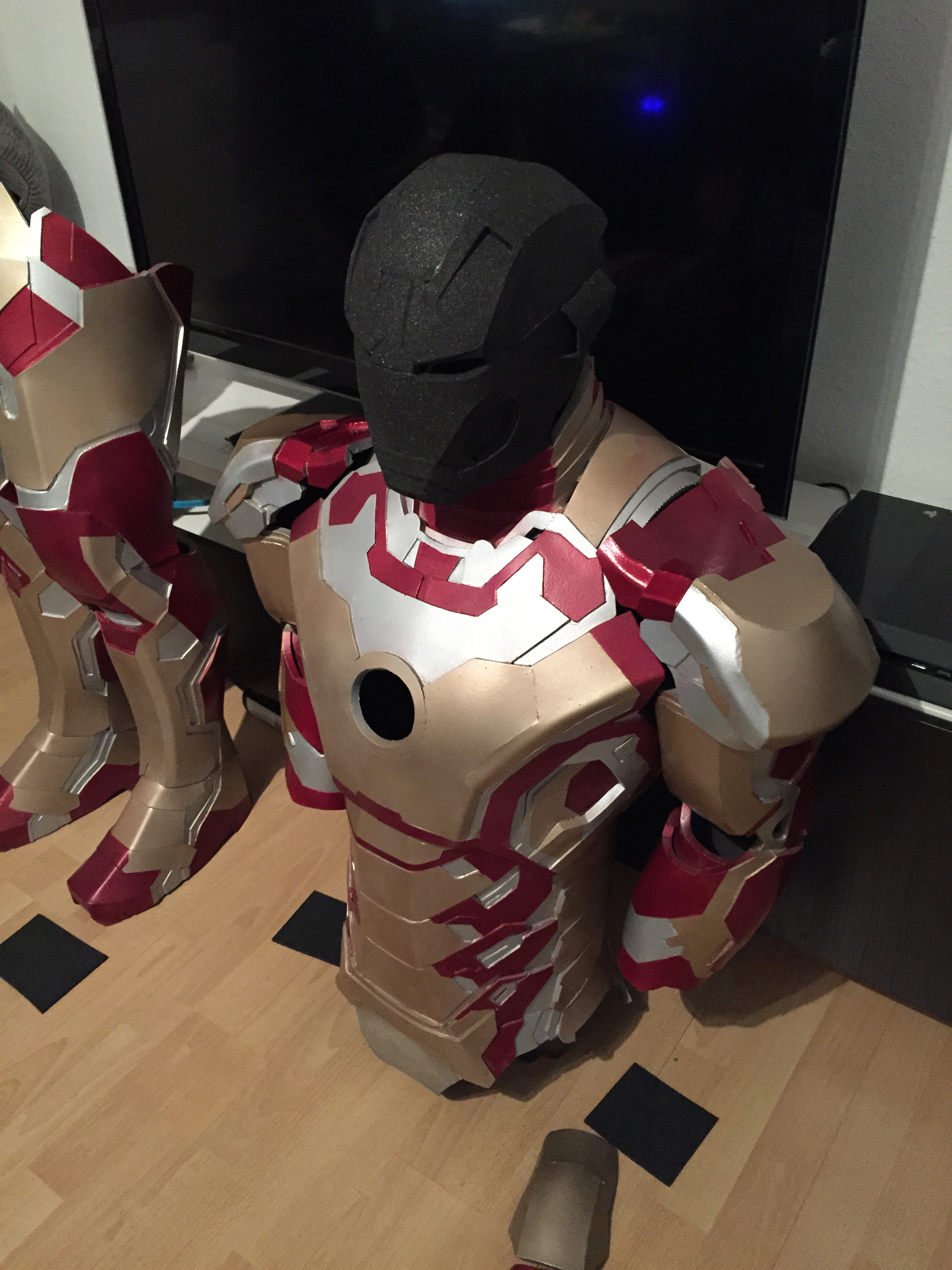

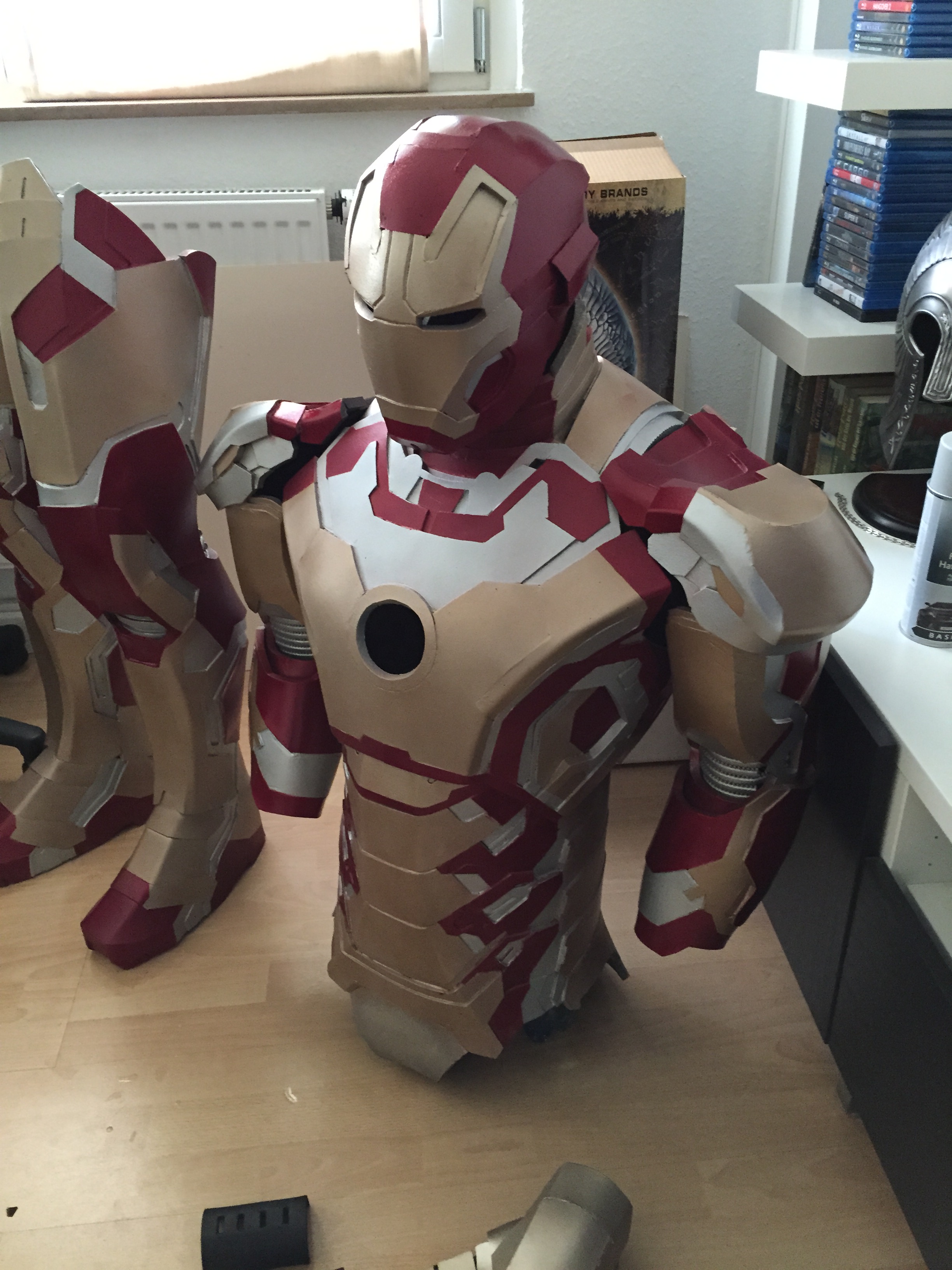

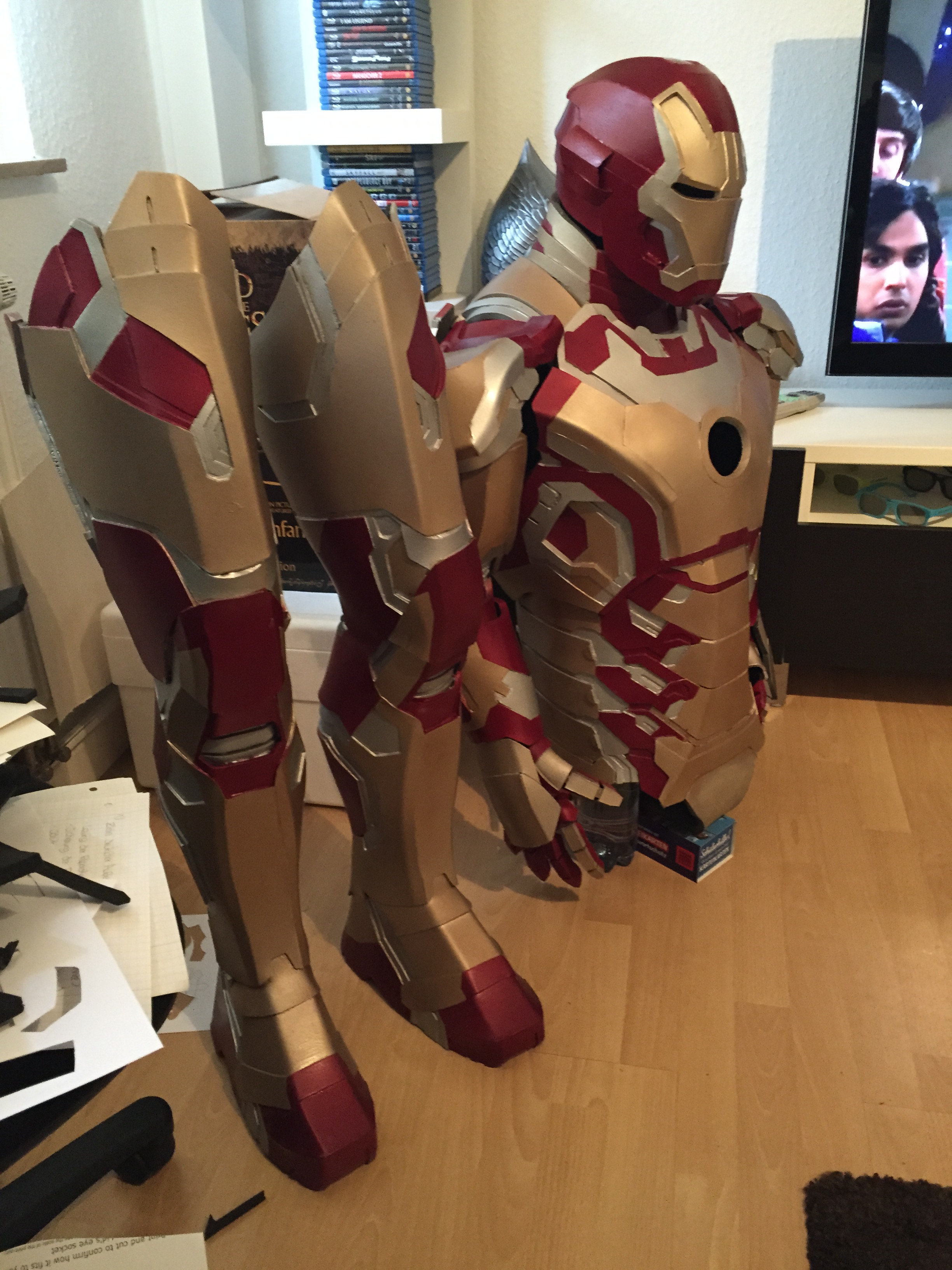

Yeah but first I will finish the suit completely :D I made some test fitting but the end result will be way better. I build the helmet now, it´s ok but I think i will make a new one. Also the arms are now temporary attached to the main body. As always I hope you like it ! :D

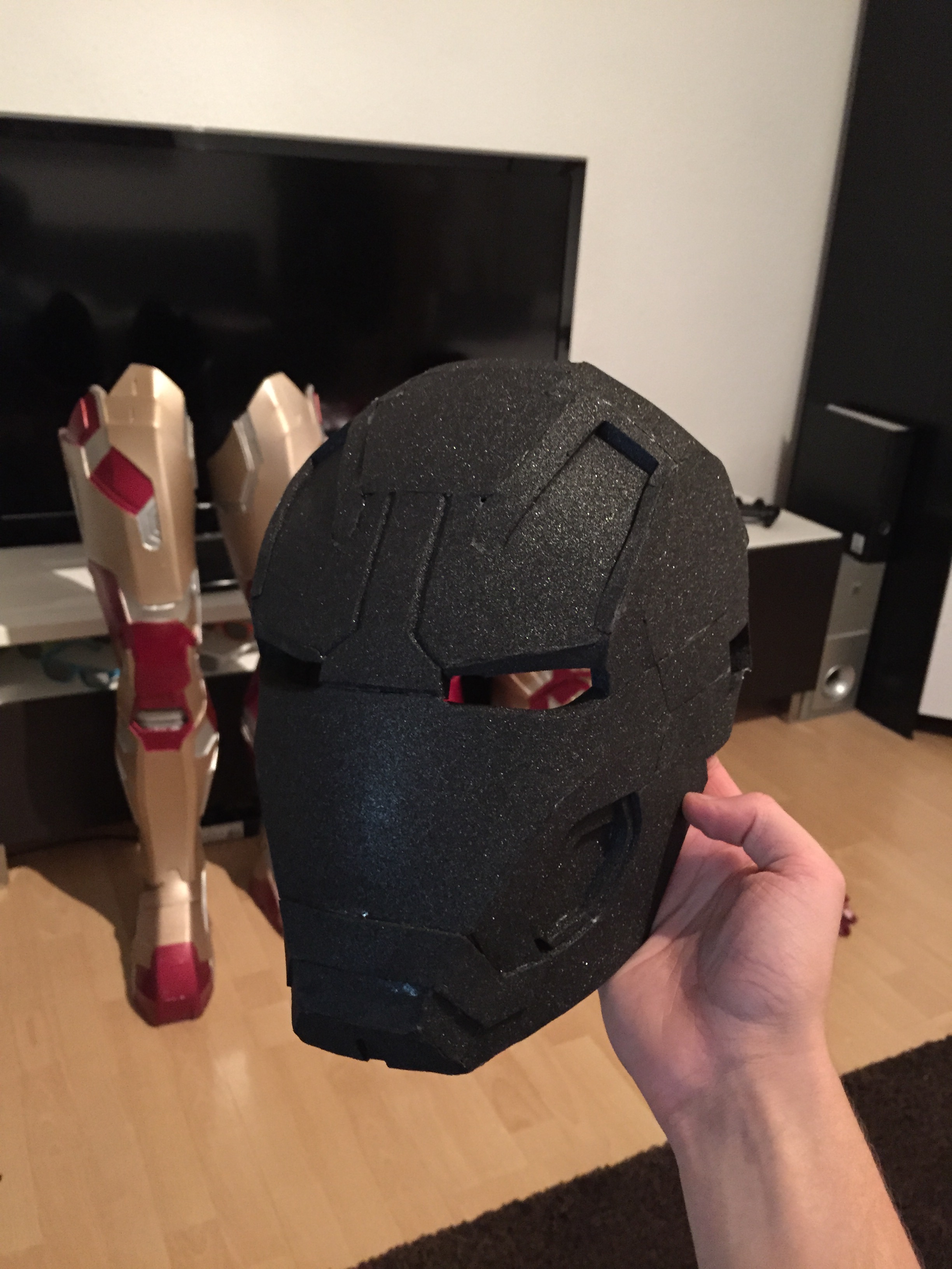

Helmet also finished :) Only the right hand left to do. Than install lights and I have finished. I think the helmet is ok. It´s foam and it´s wuite difficult to get a good helmet out of foam. I am quite happy with my one I hope you also think so.

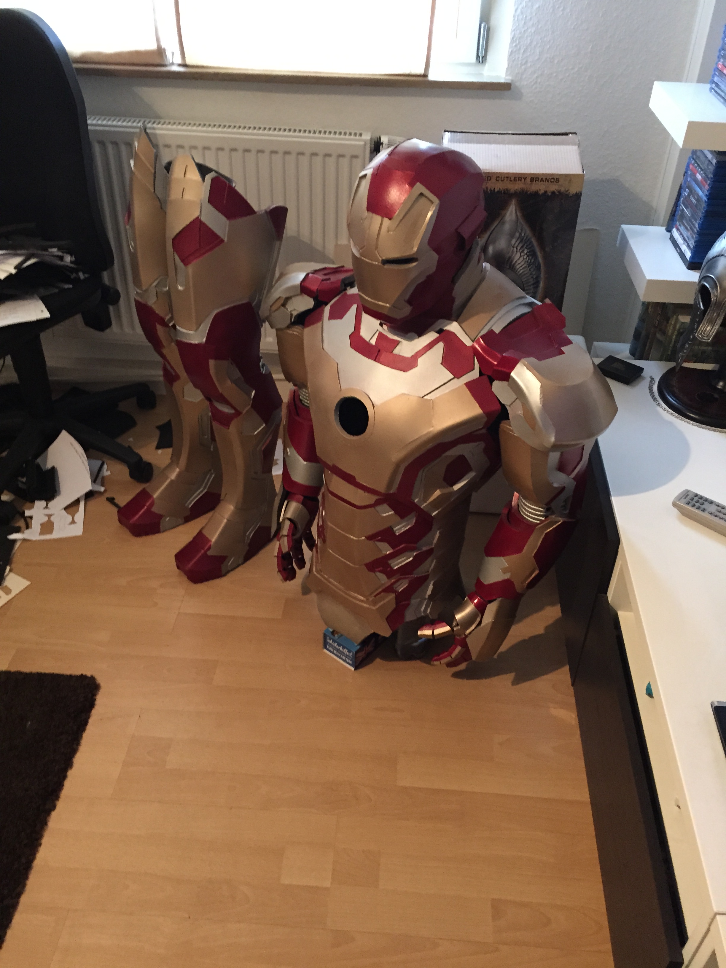

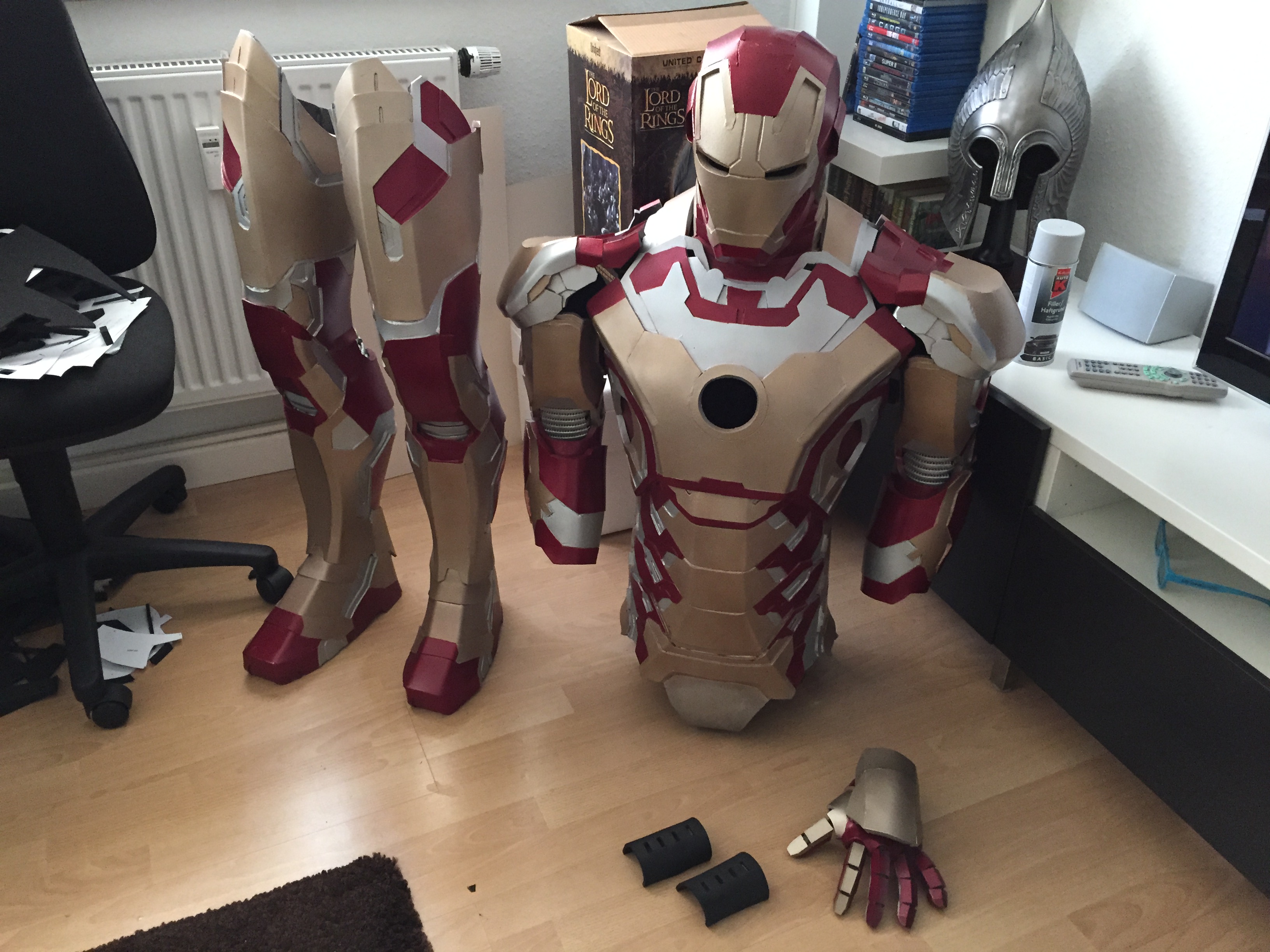

Now the only thing left is install the lights :) Both hands are finished and look very good. Almost done haha ! It was a long way but it´s coming to an end now :) I hope you all like the suit so far

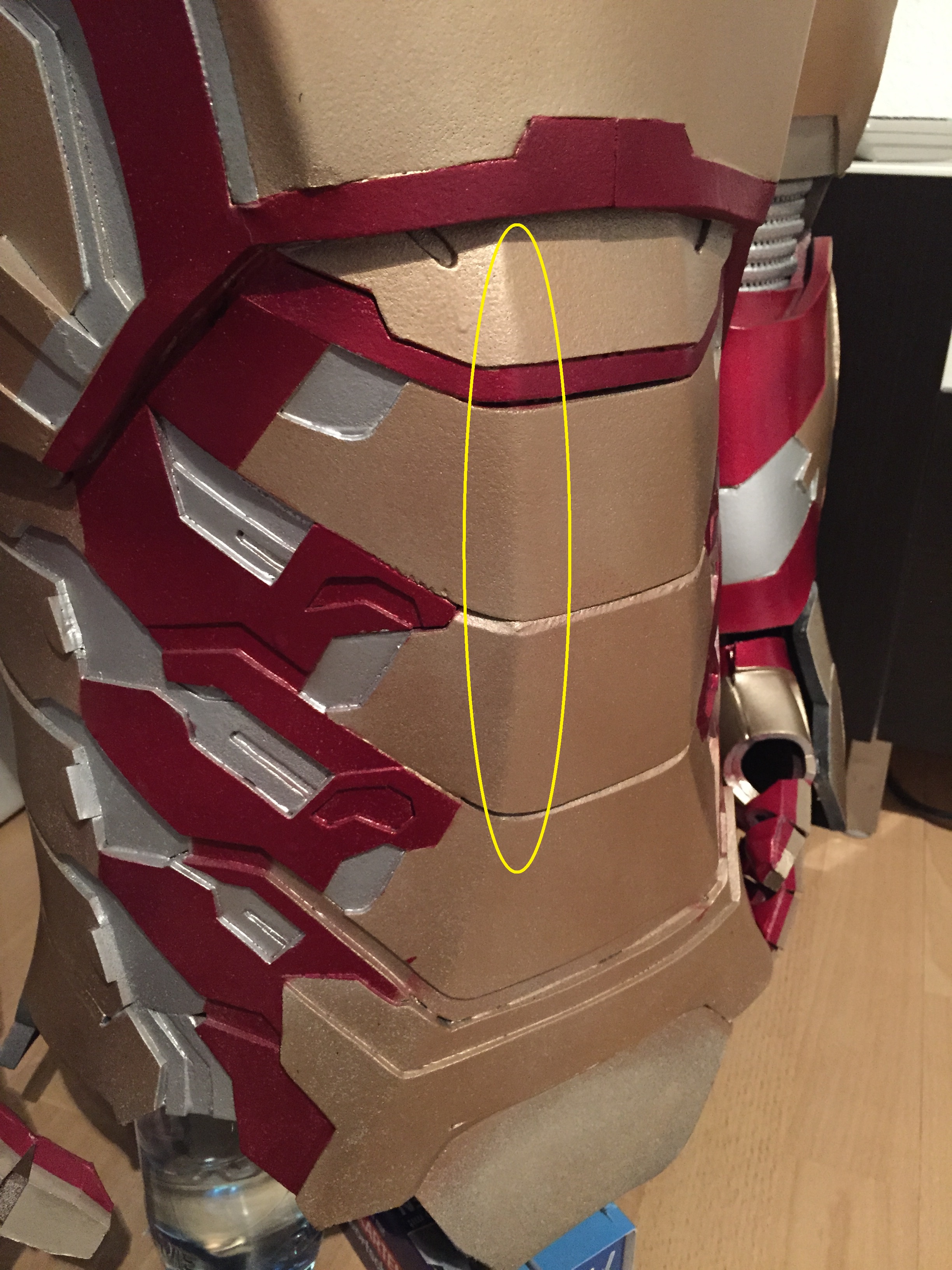

Awesome thanks man! I've never done a foam build but I'm actually thinking about it now :) is heating it with the heat gun how you made the verses on the abs etc.?
Re: Iron Man Mark 42 (Foam). !!UPDATE!! 28.10.14
Thank you Bandiet. Yeah with the right foam you can have almost the same results as with pepakura or cardboard except for the stability :) Thank you again for your feedback

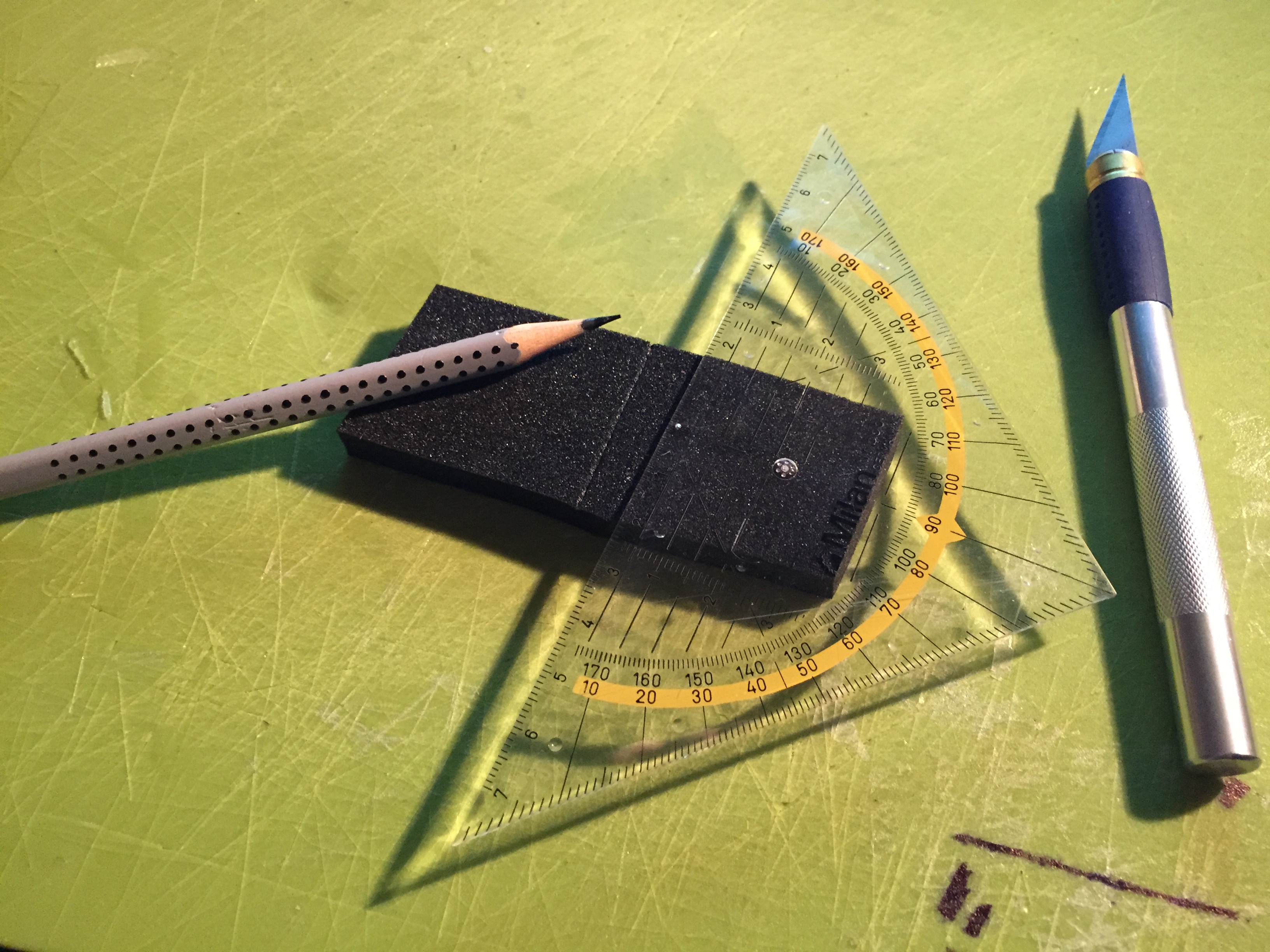

You mean the sharp line there ?
Awesome! Thanks :)

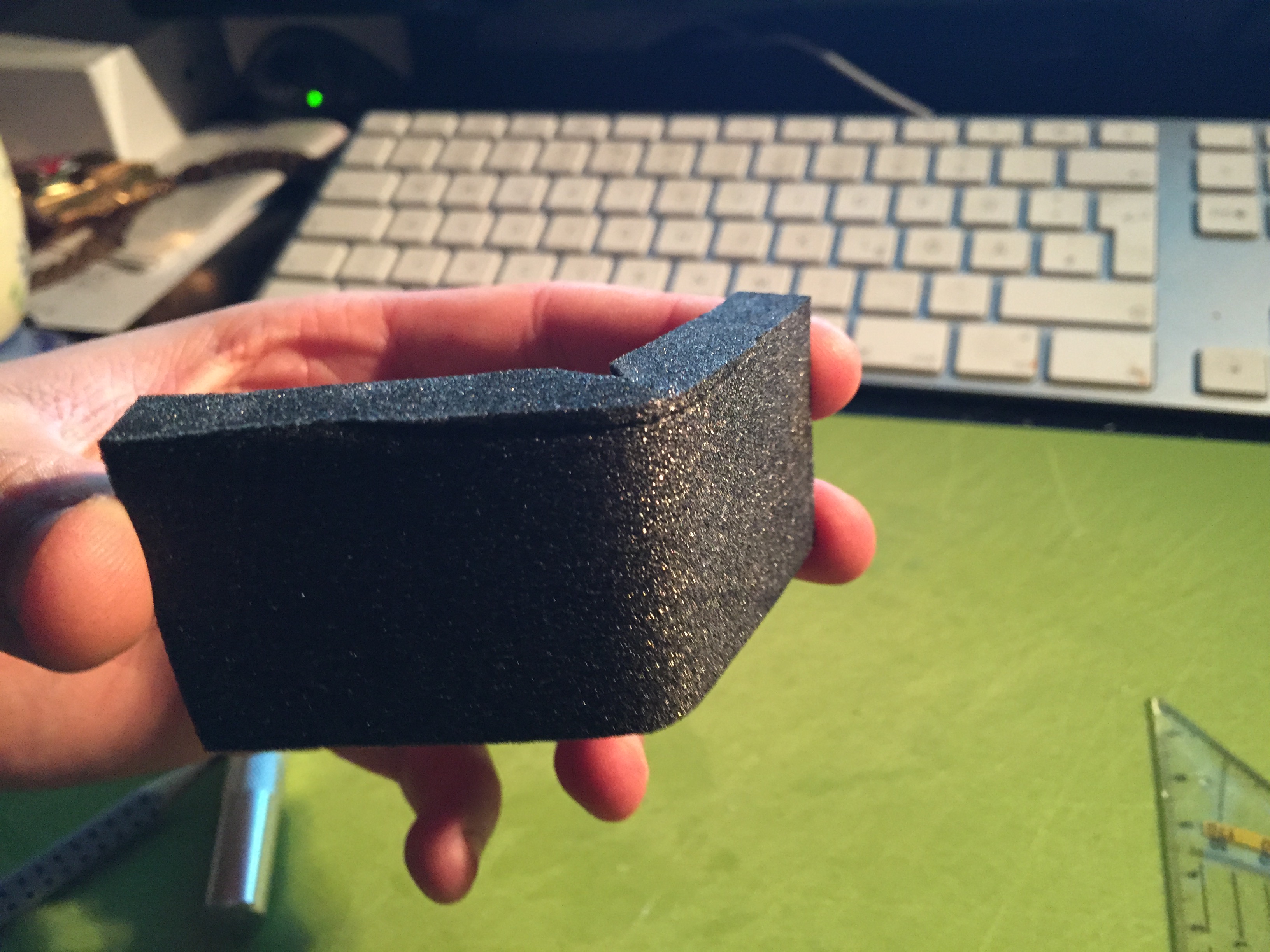

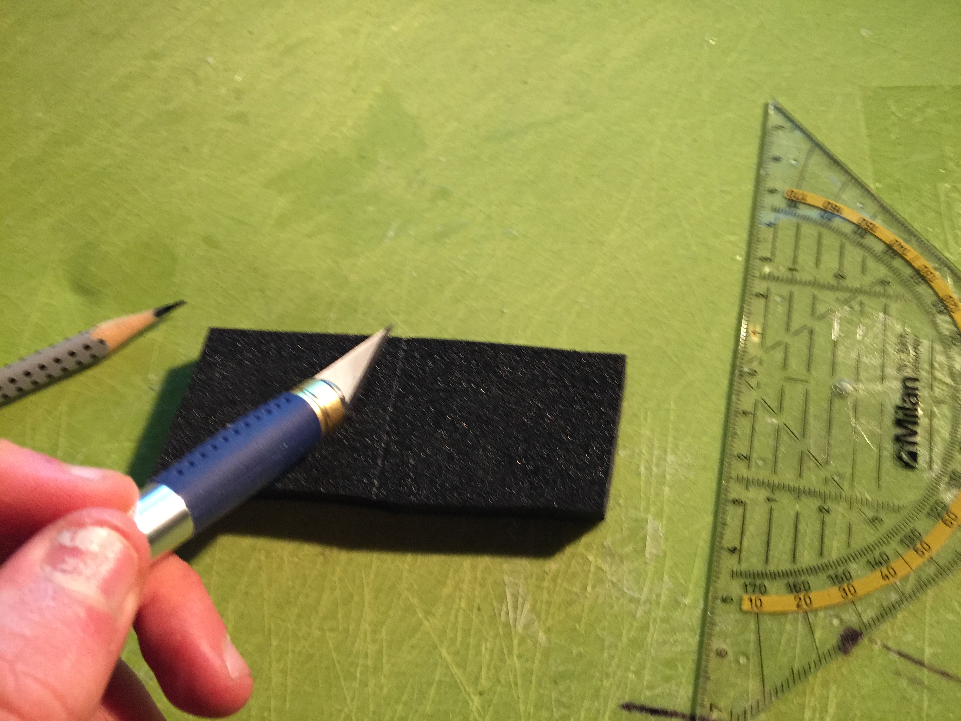

I only have this small piece of foam left but it also works with this :)
1. Step
You have the foam piece and make a line with a pen where you wanna have this kind of sharp line on your suit :)
2. Step
You cut out an triangle out of the foam like shown in the photo below :)
3. Step
You have cut out the triangle and the then you put some hot glue into this triangle and glue it with the angle you want it to be together :) Finish :D
