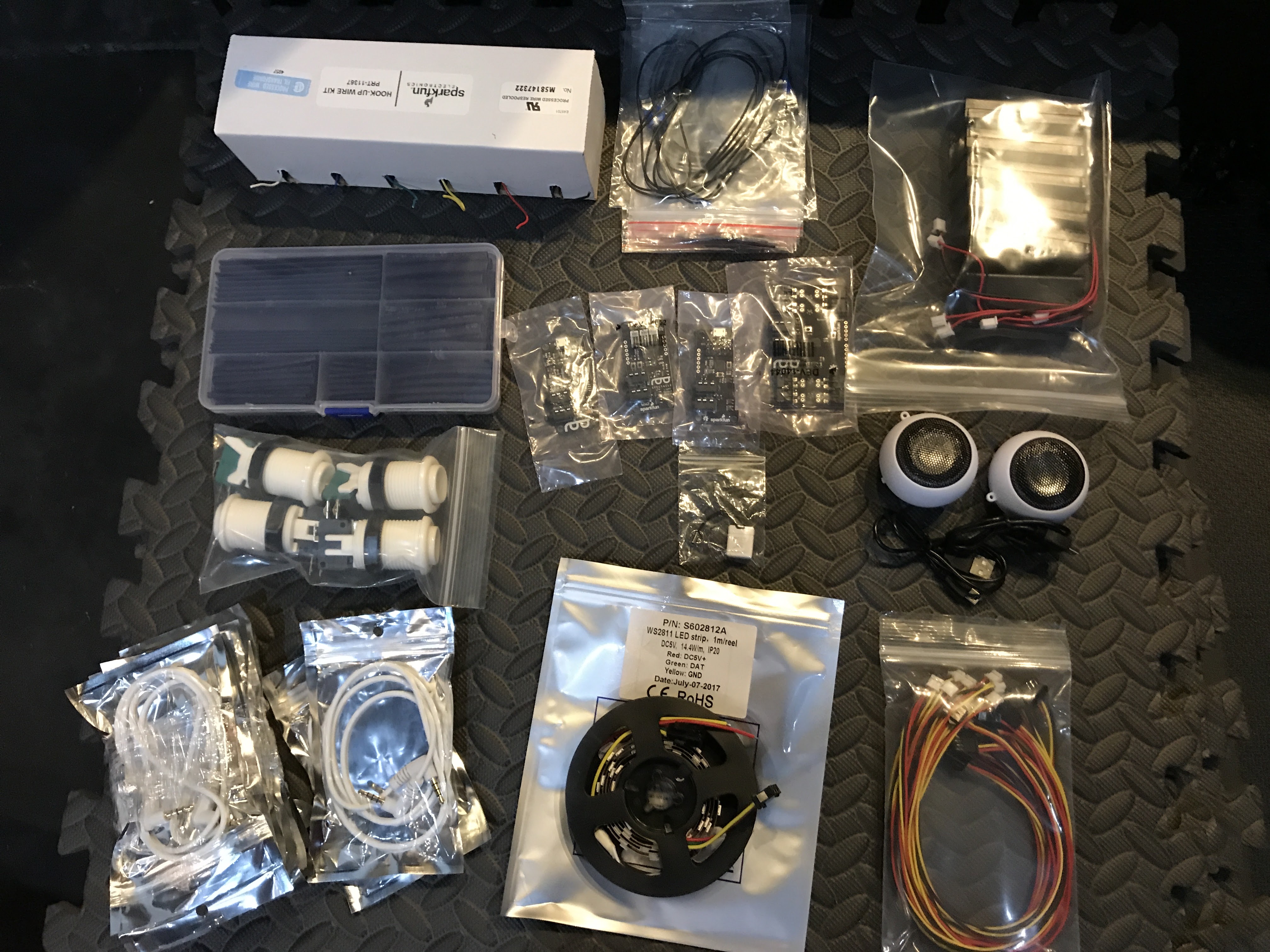

So I took that all out. I ended up replacing it (and all the other LEDs and wiring) with stuff I got from Sparkfun.com. I found this ecosystem called Sparkfun Spectacle, which is basically for people who want some effects but don't want to take electronics as a hobby! I'm definitely no sandbagger so there is no way I could do any of that stuff. The easy way is the way for me!
I ended up getting a bunch of extra wiring, some servos, an LED strip, the director board, light board, button board, motion board, audio board, a couple powered speakers, and some other stuff. Even just some battery boxes with switches in case none of this worked!

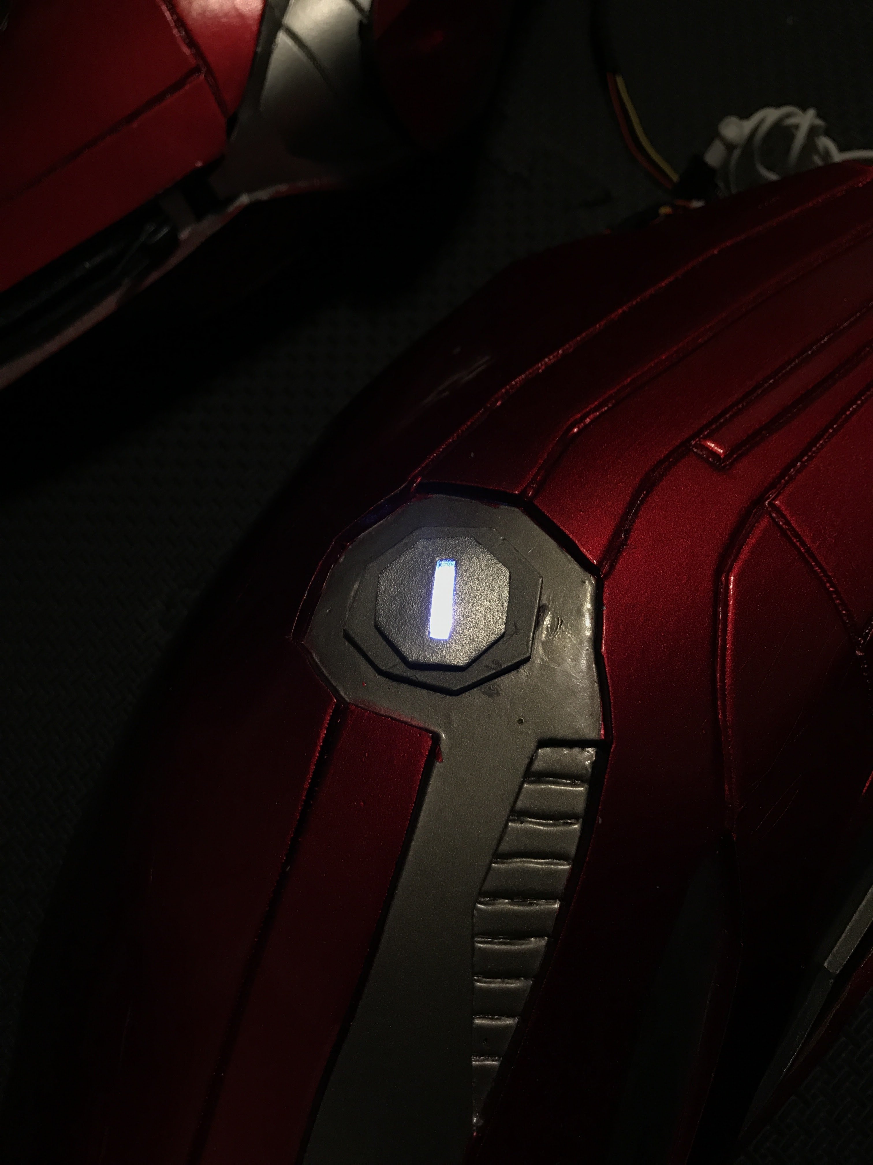

After a couple weeks working on this all, including teaching myself how to solder and cutting up the LED strip, I could add the LEDs throughout the suit. That took a good amount of time, wires, and JST or JST-SM connectors, but it looks great. I also ended up making little foam hexagons with a milk carton jug as diffusers all throughout the suit for the little light-holes on the MK46, which I think is an improvement until I get a 3D-printed version.
Old:
New:

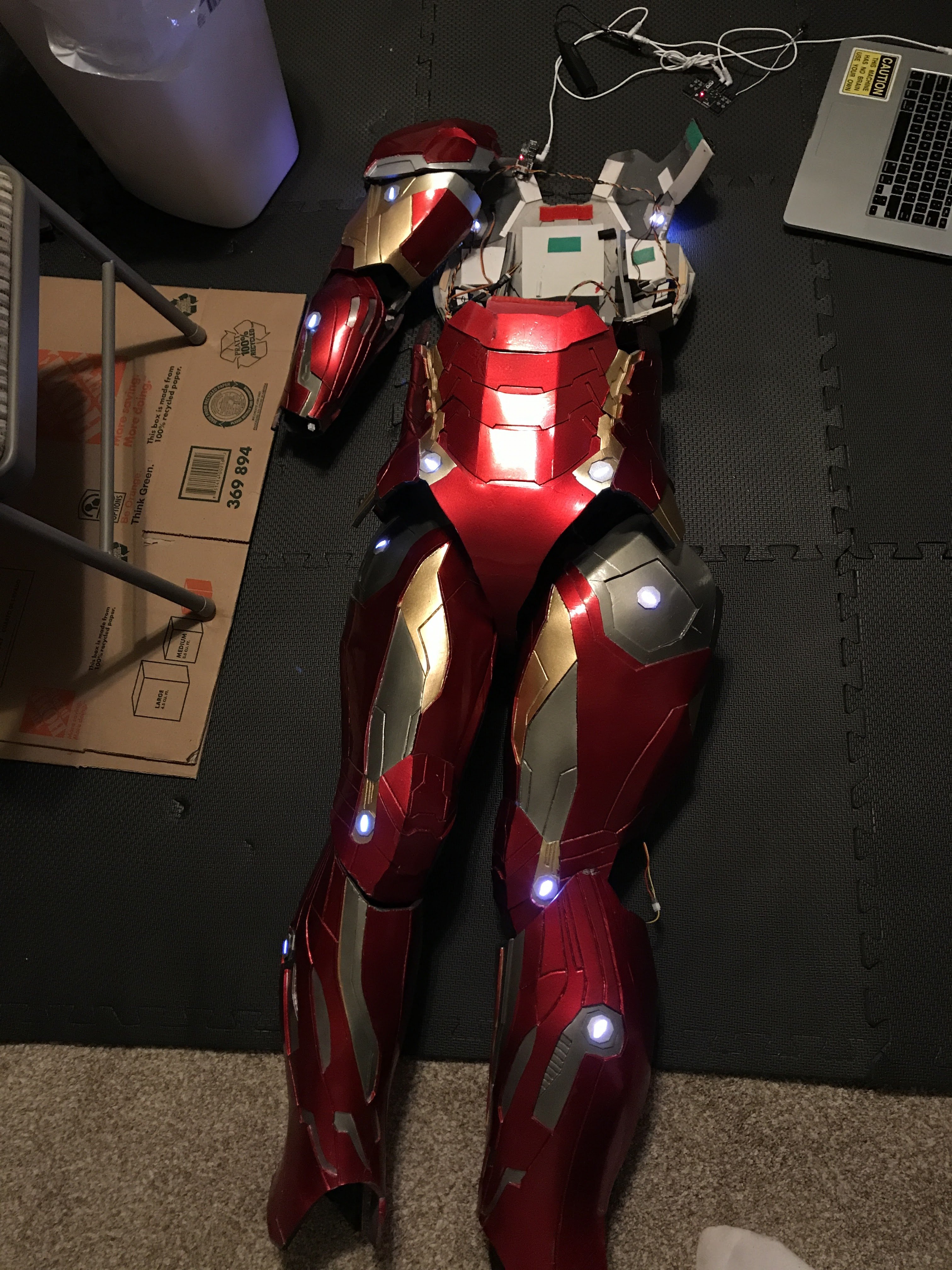

Overall:
So far, I have some really cool functionality for the suit. I figured out how to control those back servos (and replaced a couple of them), figured out how to easily separate and solder wire to LED pixels, and wired up an LED disc which was difficult but is a perfect arc reactor after making sure it's behind a frosted "window" and you're protected from the heat it generates. I've also grabbed some sounds off of a post here on the RPF which I'm trying to make work, but for now I just have some good progress.
