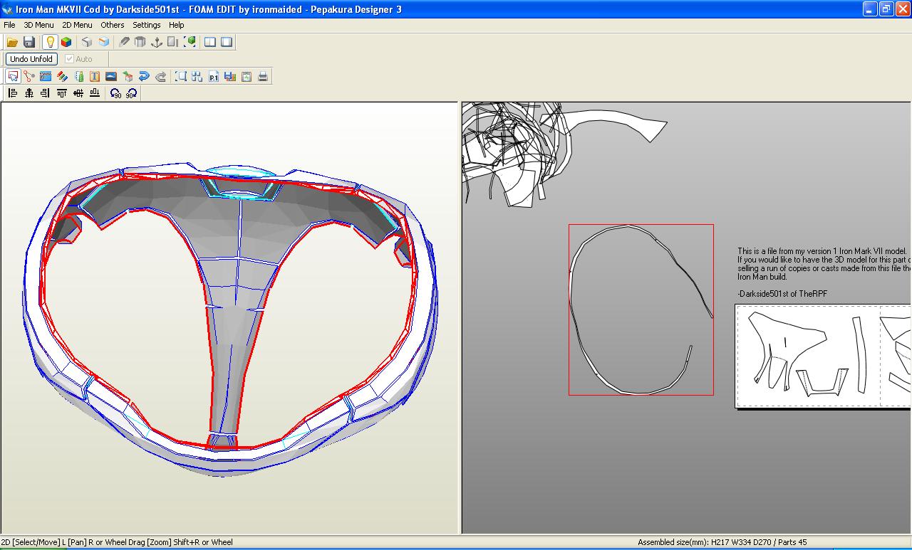

One suggestion I can give is open the foam mark vii cod file and find the large circular piece...
(seen here: codpiece.JPG .)
It's a circle for around your waist, but you don't even need to cut it out; Just print it and measure it with a string to find out the length, and measure your waist. Keep scaling/printing (you can even do it on the same paper) until you find a match.
You can also use the measurement tool in Pep Viewer/Designer to measure from hip-to-hip.

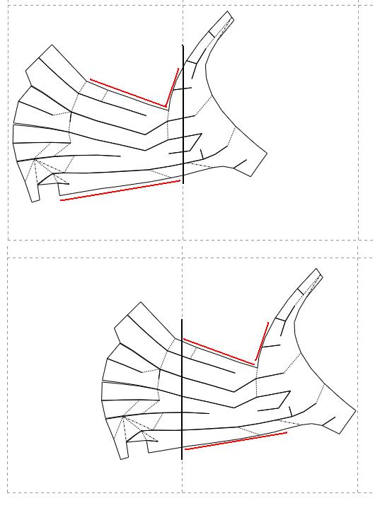

At some point, you're just going to have to print one piece on two pages.
Say you have a really long piece... The way I do this is I move the piece as far to the left of page 1 and print page 1. Then I move the piece to the far right of page 2 and print page 2. I cut both out, overlap them, and secure them together. The red lines are where they'd overlap, the black lines are where they'll cut off the page.
Like this: overlaps.JPG
You can also use the join/disjoin face tool to just cut large pieces into smaller pieces. It will automatically create flaps to hook them back together.
