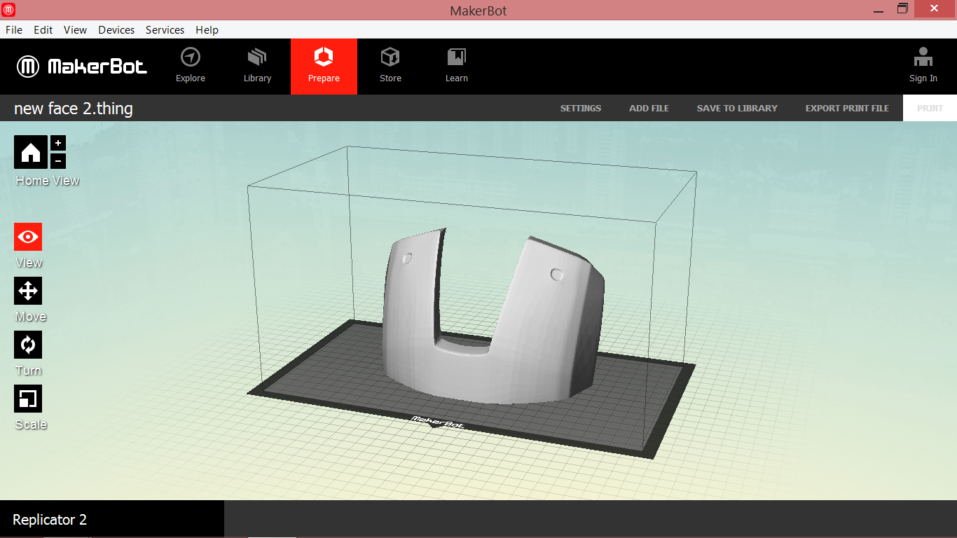

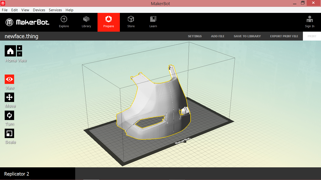

Ghost Minion sent over some parts he has worked on thus far. I was able to scale up the faceplate to the proper size (I hope so, I used other faceplate measurements as a generic basis of comparison) I was then able to slice the plate in half to fit on my 3d printer. This is what I have thus far.

I'm still having issues with the rest of the helmet but It's coming along. I really need a PC with tons of ram because my laptop lags at times when I work on some of this.

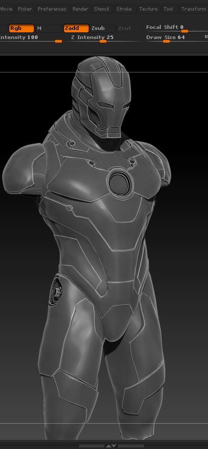

Also, for those who are working with me on this know, the files have many intersecting parts. The upper body is no different. The good news is that I figured out a way to separate the parts and have them ready for the next step of making them pepakura friendly! As I break them down, I'll post them on my first post of this thread.
View attachment 397625 View attachment 397626

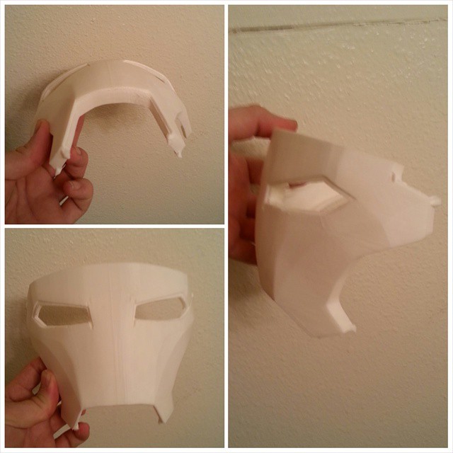

Printed the lower faceplate last night. Sizing looks about right but I won't know till I try the rest of the helmet
