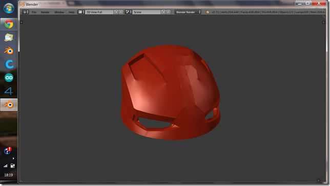

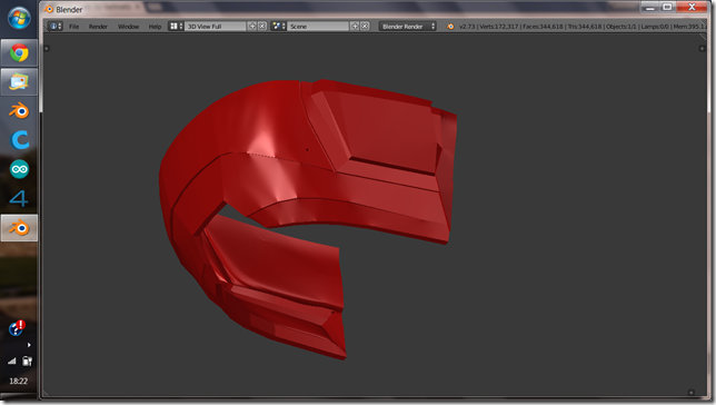

Yep I am still working on the best way of getting them finished, but basically...search for a good pep file; like Dancin' Fools MK3 files. Open it in Pepakura designer. If you like it convert it to an Object OBJ. file.
Then open it in Blender. Scale it, Solidify it and Smooth it. And then probably split it into parts small enough to fit on your 3d printer. I'm using an Ultimaker 2 at the moment but I have started building my own oversize machine (gulp!)

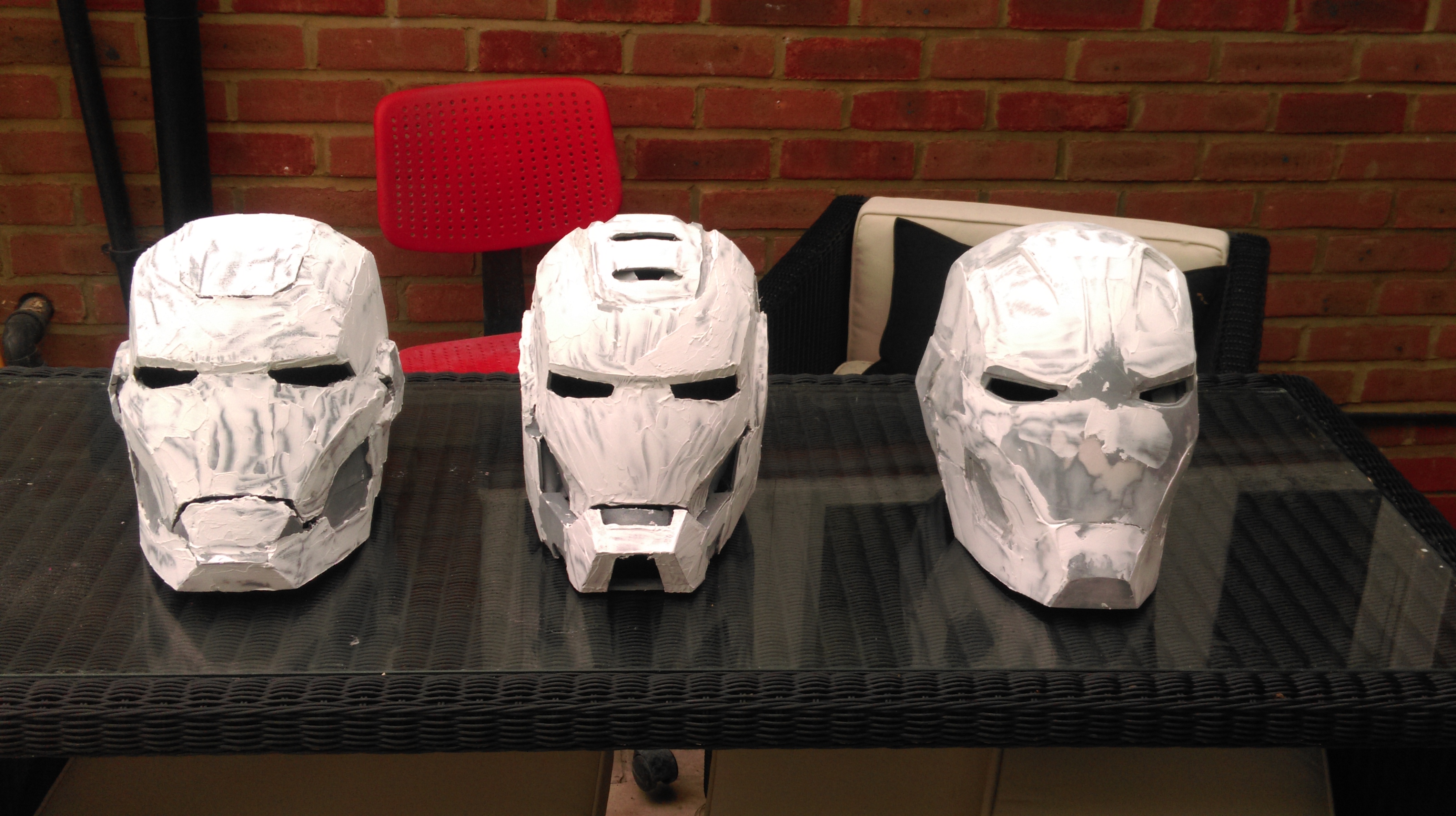

Once you have all the parts, warps and all, glue them together. Then comes the joy of filling/sanding, Bondo/Rondo usually, literally for days and days and days until you are happy with the surface, which will seem like never!

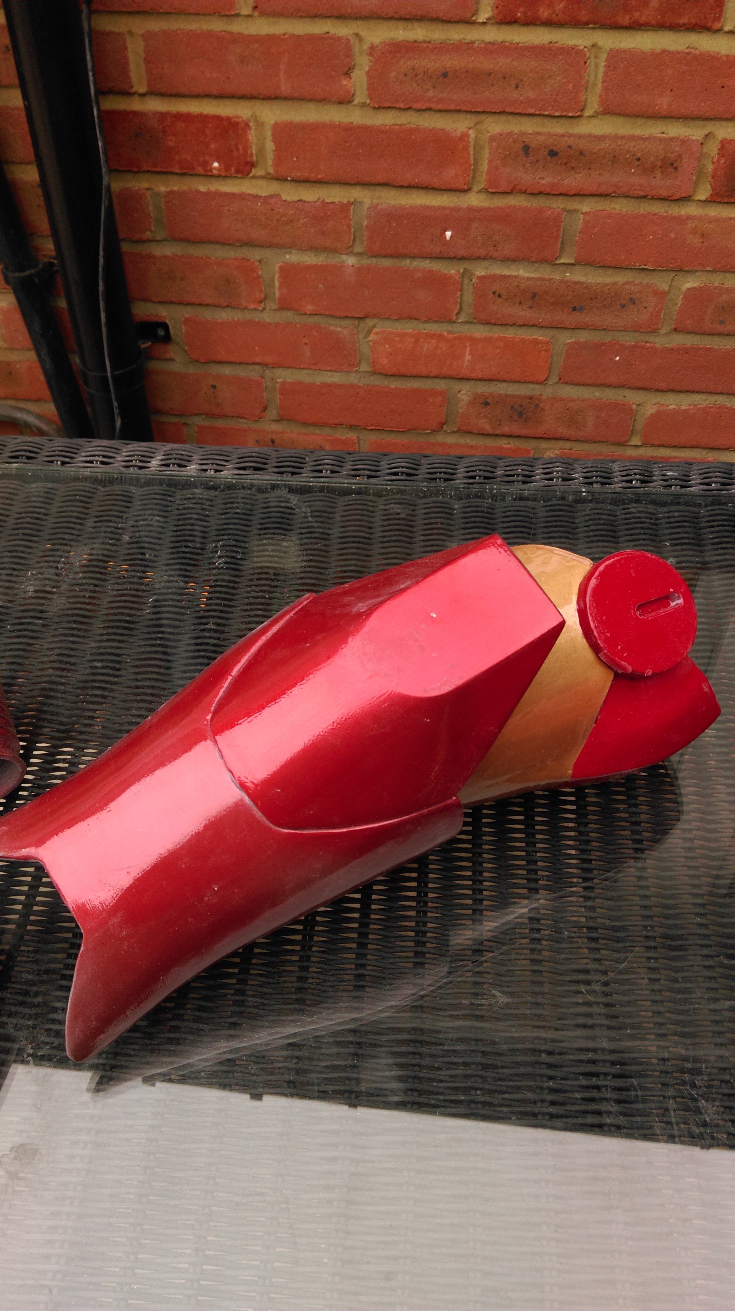

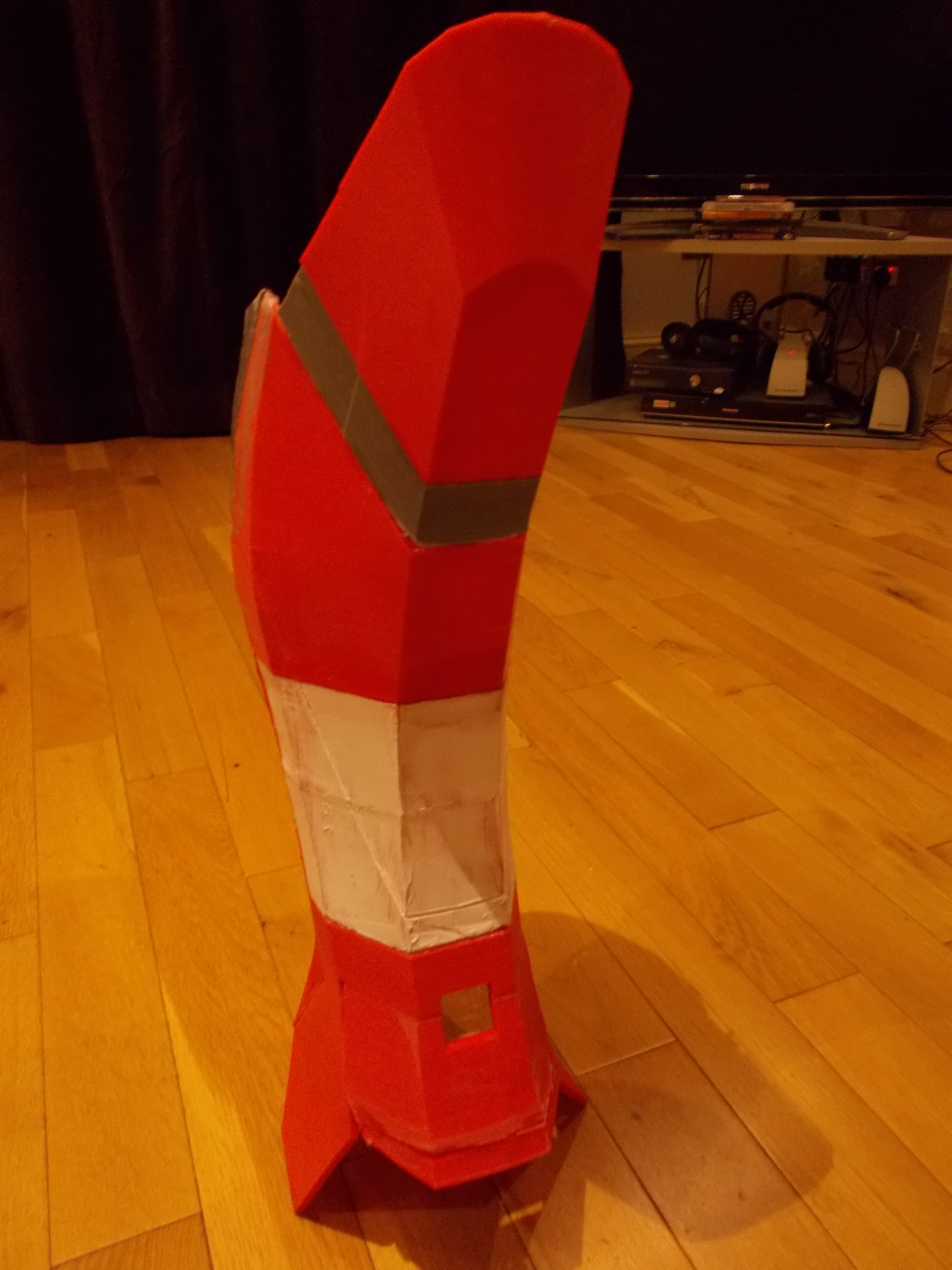

Hey guys, so here are some pix of my MK3D build;
STARK REACTOR 001.jpgSTARK REACTOR 002.jpgSTARK REACTOR 003.jpgSTARK REACTOR 006.jpgSTARK REACTOR 007.jpgSTARK REACTOR 008.jpgSTARK REACTOR 009.jpgSTARK REACTOR 010.jpg
I have focused on producing most of the large parts and post processing them the usual way. Has anyone else tried XTC from Smooth-on? I thought it might well be the best thing since sliced bread when I got it but after several applications, I'm not convinced it is a worthwhile shortcut to achieving the perfect finish, we all crave :angry

Obviously, these models are too big to print in one piece on anything but a giant printer, so I have split them up into either helmet parts or just 4 quarters to then re-assemble afterwards. I found that because of the blasted warping I get from ABS I found the individual helmet parts did not align enough. So I mostly went for the 4 quarters option. I have the separate STL files for those if anyone wants them
So credit goes to Robo3687 via JFcustoms for the original pep file. I have separated the various components of the helmet for printing but the main head part may need splitting again, depending on your printer...let me know if you need the split stl parts

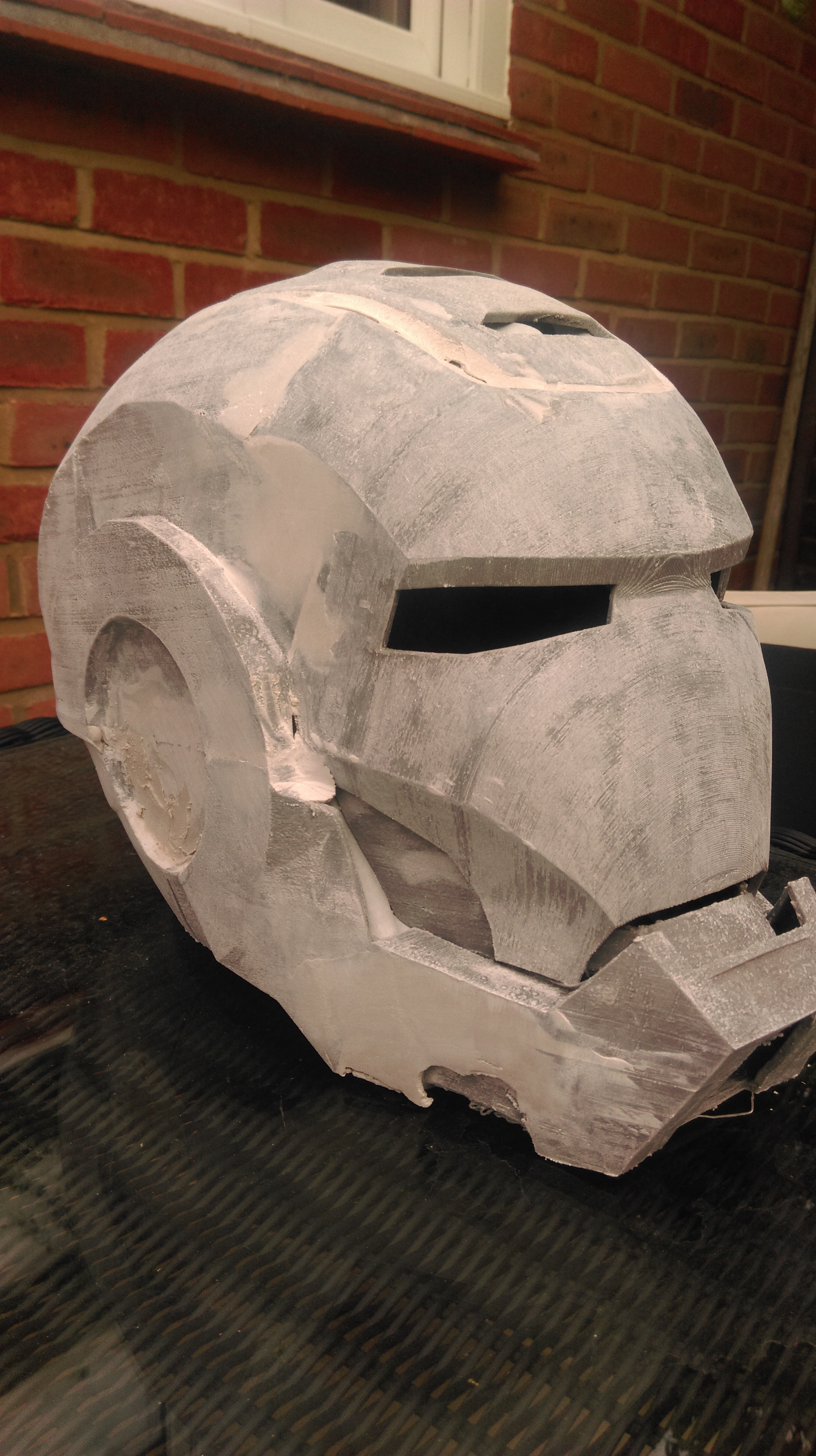

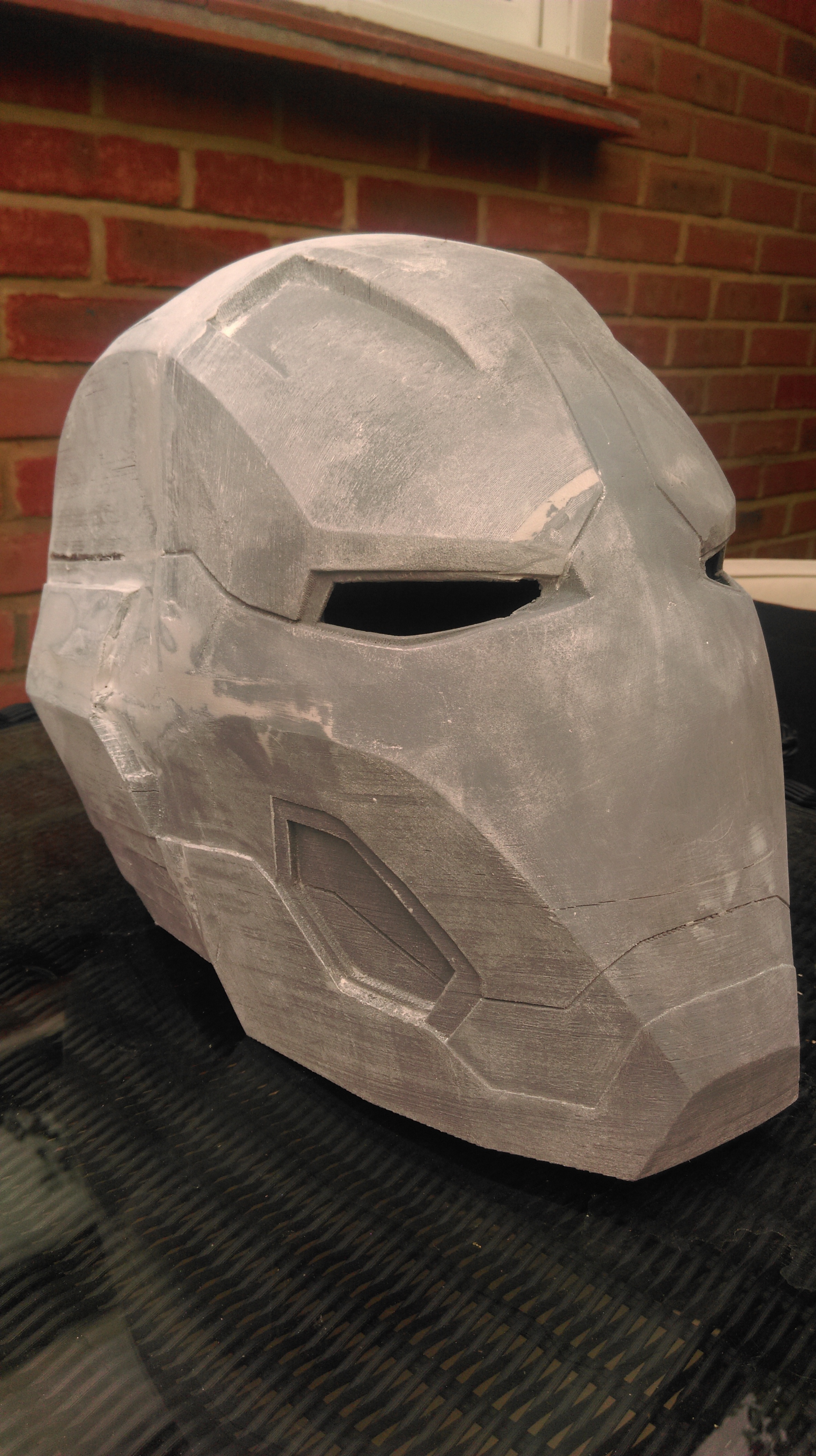

A bit more progress on MK45, IRON PATRIOT and WAR MACHINE...but there is still terabytes of sanding to do!

I just used XTC smooth on for the first time. While it isn't the savior that it totes itself to be, it did a decent enough job on the parts that I used it on. I used that, a filler/primer spray, then 3 coats of good old rattle-can paint. I'll try to get some pictures up of the parts I didnt use it on vs the ones that I did. Honestly, it's almost unnoticeable. I think if I printed in a finer resolution (.01 instead of .03) it would make a different. I've also found the orientation of the part makes a different when trying to paint without using a filler. I try to print everything vertically.
Have you come up with any decent use for the raft/support material? I have been saving it and using it as build up material when I'm welding the parts together, otherwise I feel like I lose 1/4 of the spools to the scrap bin.
Hey ubcs86, Yeah, I think XTC is ok for small objects that are finely printed but it's pretty pricey stuff and therefore too expensive to think about doing a whole suit. I also experimented with various other products including Acetone, Polyester Resin, urethane and PVA, or mixtures thereof. None were as good as XTC but It's not the perfect 'shell' I am looking for. If anyone has any nifty 3d post processing tips, I'm all ears!
