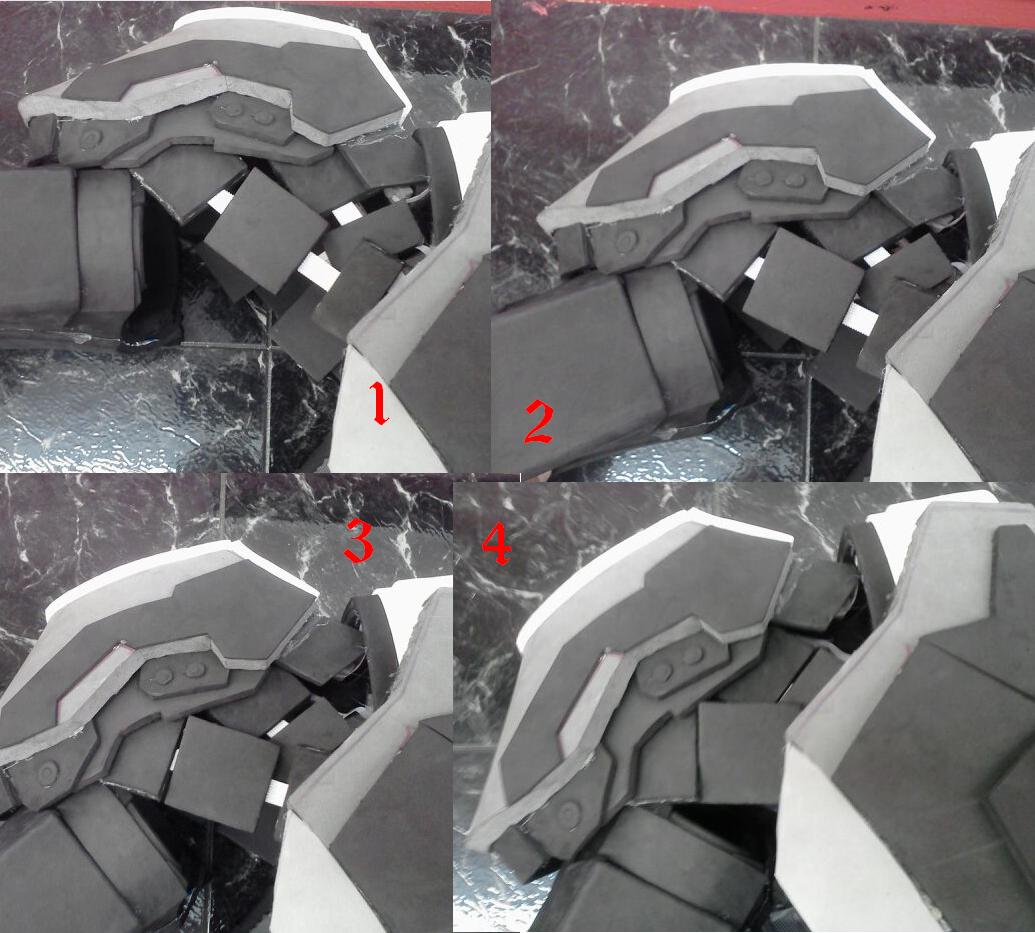

now i want function as well as looking good....so what i did with the elastic and foam.
i ran the elastic straping at the proper angles from the inner parts of the should cap to the inner part of the chest and the back
finding the proper places on the inside to attach the elastic is key. you wanna make sure there not to close to the edges so that a piece can slide along the elastic and tuck behind the outer armor pieces
by taking 2 pieces of foam and glueing them on both sides of the elastic together... without glueing the elastic to the foam. this allows the full stretch of the elastic between the foam pieces.
this method helps minimze any visable undersuit spots and the elastic helps realign the shoulder cap and keeps it where it should be in a relaxed position
i will upload videos showing the range of motion (which is ample)
i will soon create a little step by step tutorial on how i decided to do my arc reactor which actually screws into the suit
the video is gonna have to wait...but this pic should show the range of motion pretty well

That whole shoulder area is amazing!! Great work!!

Your way with using the elastic and foam together is awesome, man, keep up the great work. That gives me good ideas for my foam builds, thanks very much! :thumbsup
the shoulder explain left-right movement. How about front-back movement? Will it still okay?

The shoulder region does move front to back just as easy..and the pieces do realign....the main thing i was thinkin when i came up with it was can I reach the helmet and drink a beer
