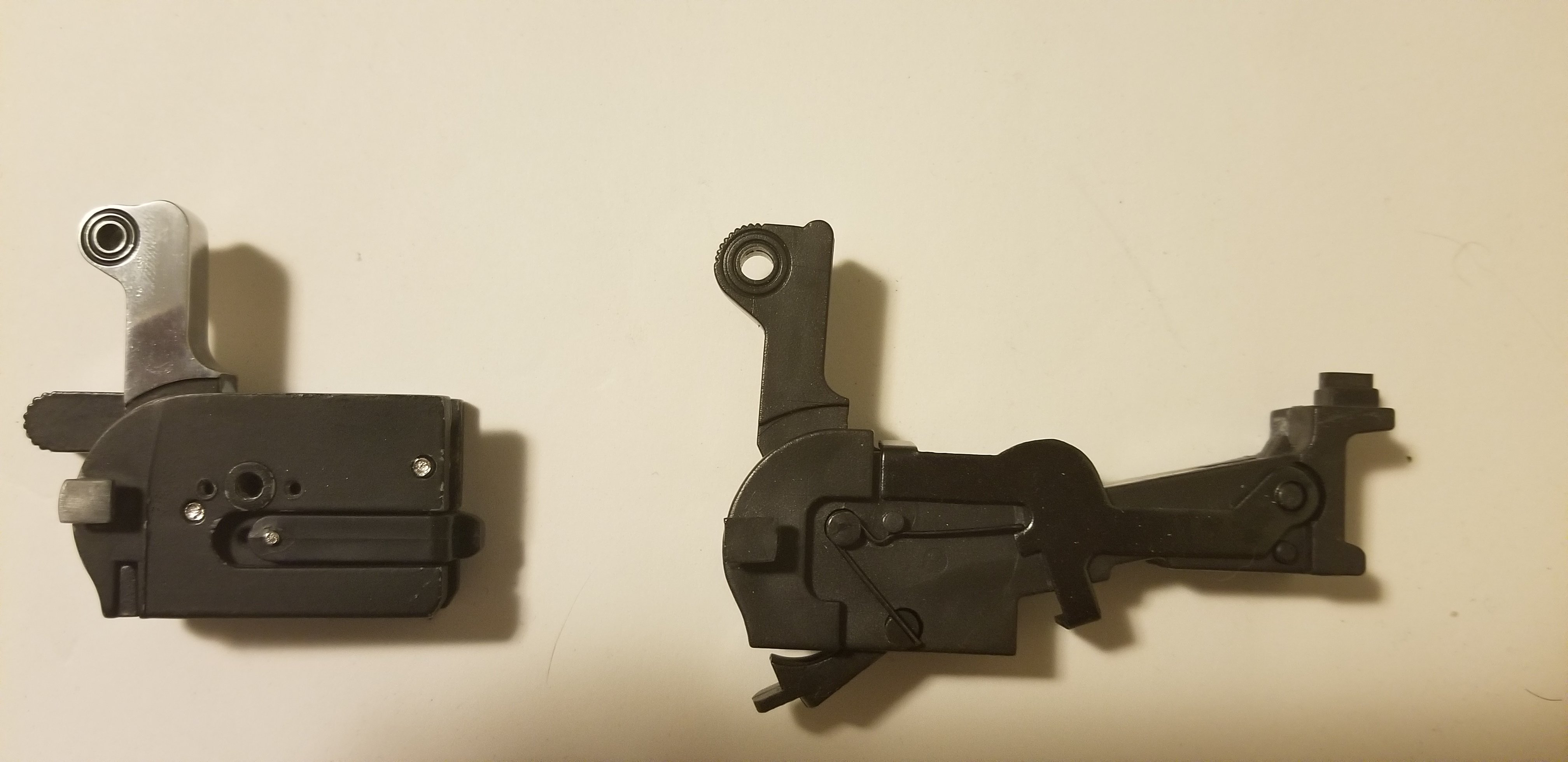

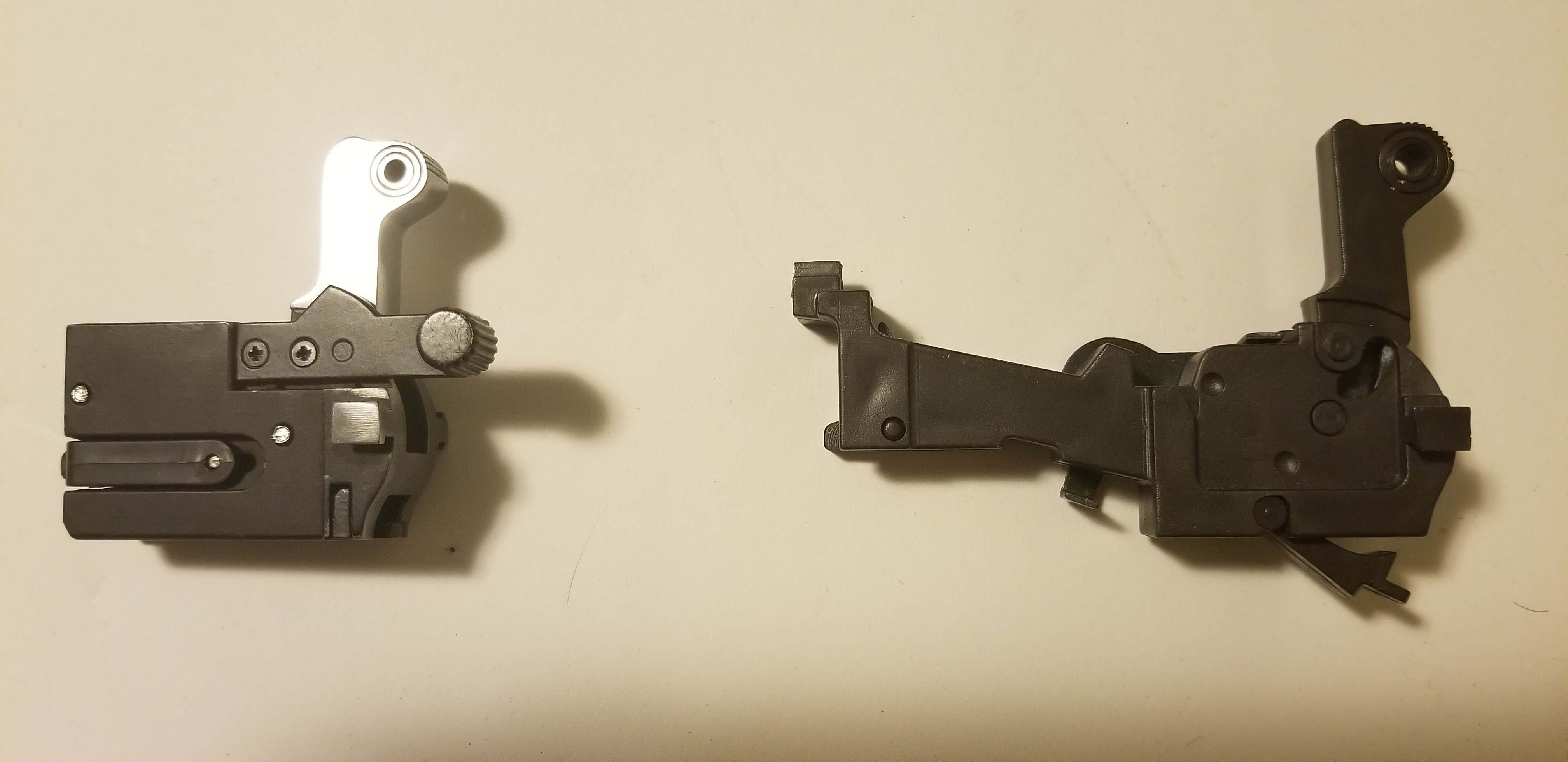

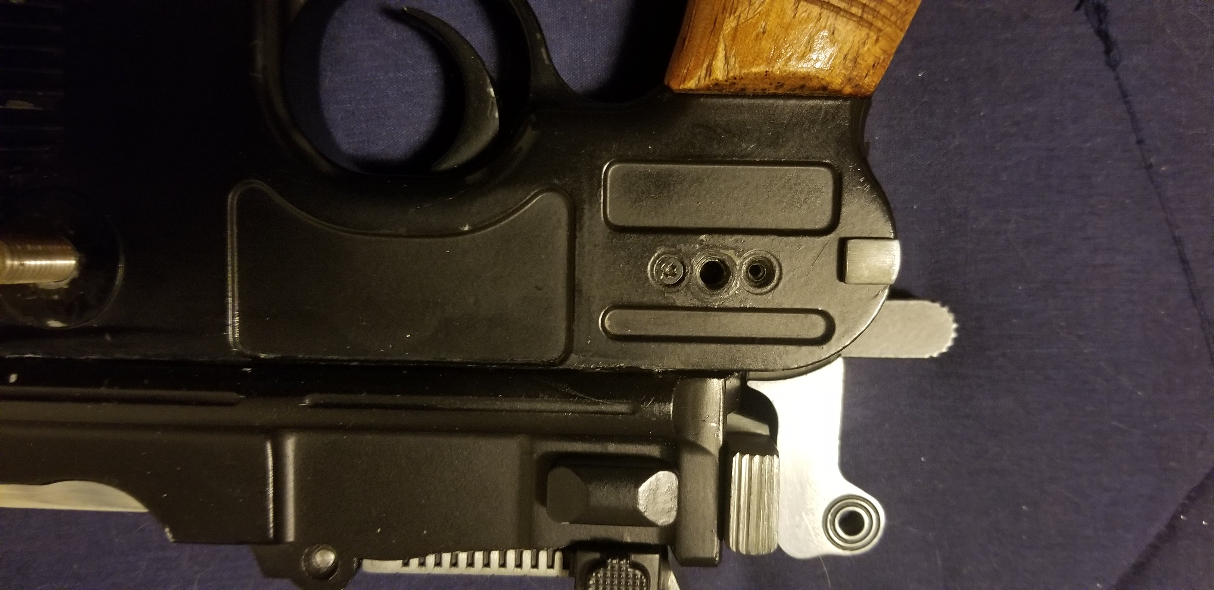

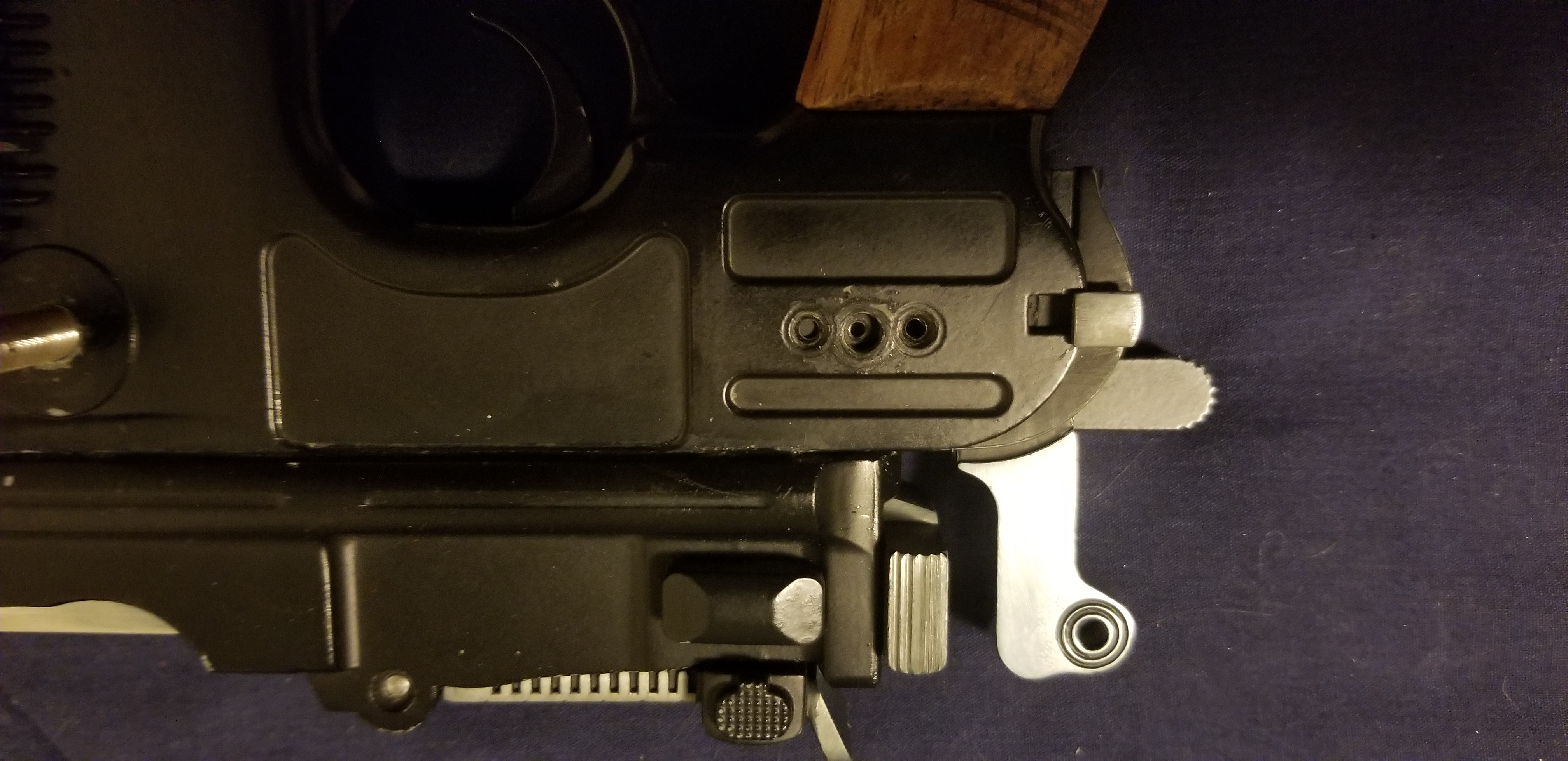

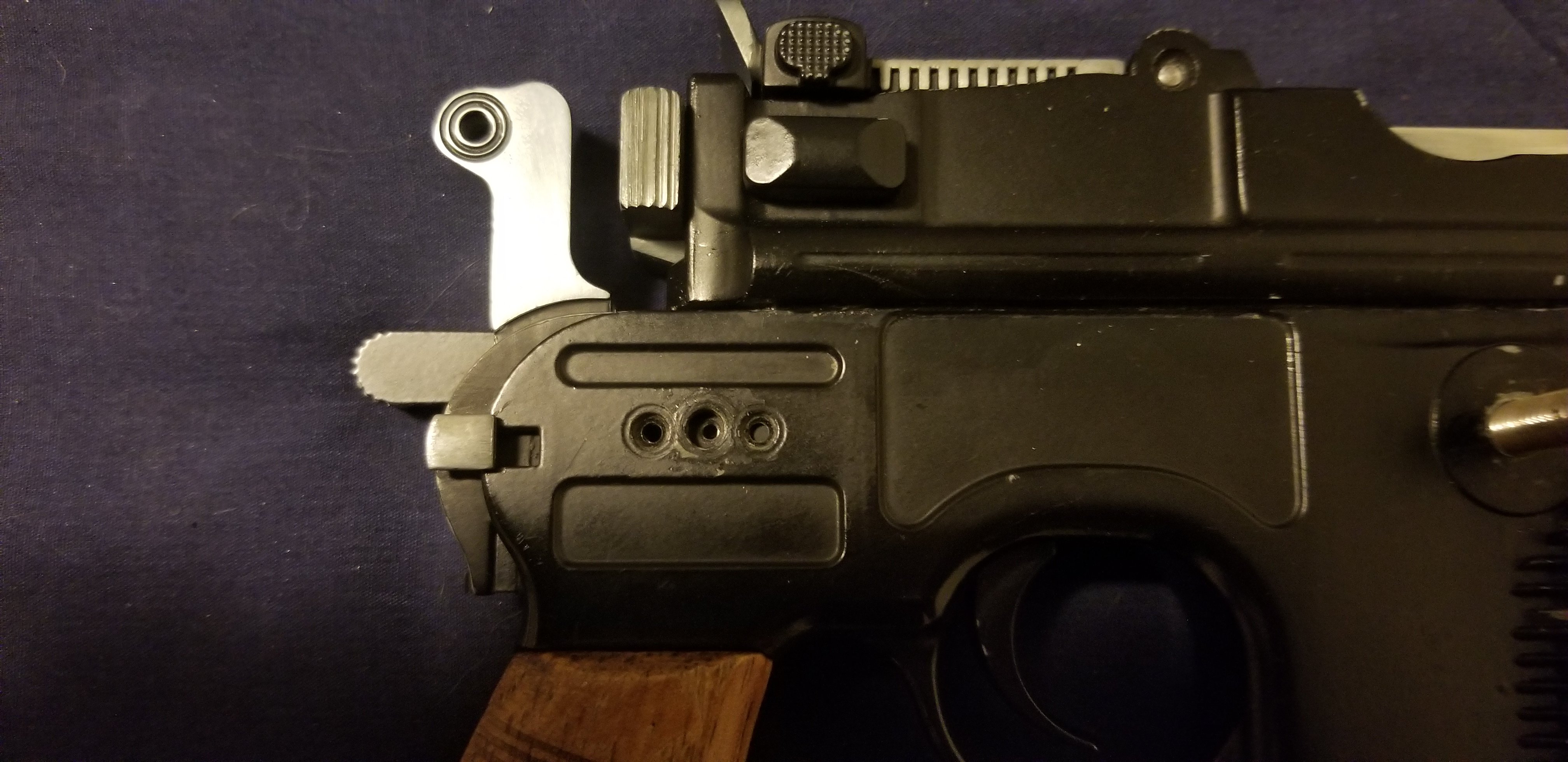

There are some quick pics I've take of my MR EE's internal frame. I can take some better/more detailed/disassembled photos tomorrow. (Note that the LE were literally just Denix; the EE were modled off of a real Mauser's frame.)
The internal frame is held in place with the screws underneath the crossbar's washer.
Pops right out once the screws are removed.
The EE's internal frame compared to an MGC's.

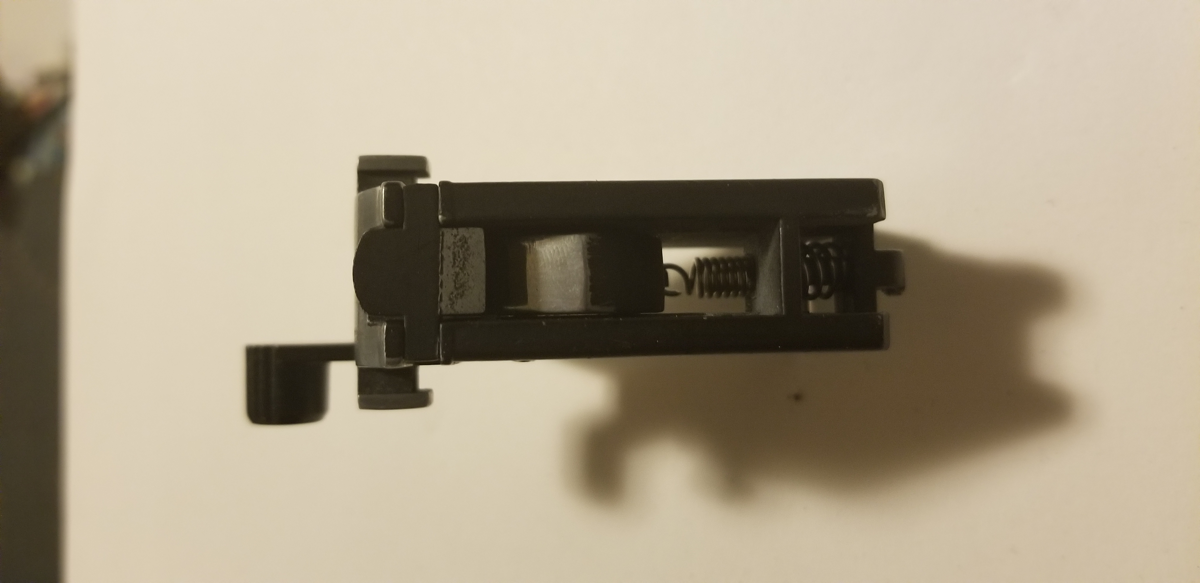

Quick snapshot into the internal frame - its basically just two springs that alternatively hold tension for when its drawn back and then another one to pull it forward when the trigger is pressed (I've personally tightened them to give the hammer a better snap). The safety is non-functional. The "tab" on the front is what the trigger presses on when pulled, and is what controls the hammer mechanism. (Not sure why some of the images are showing up upside down; sorry.)
