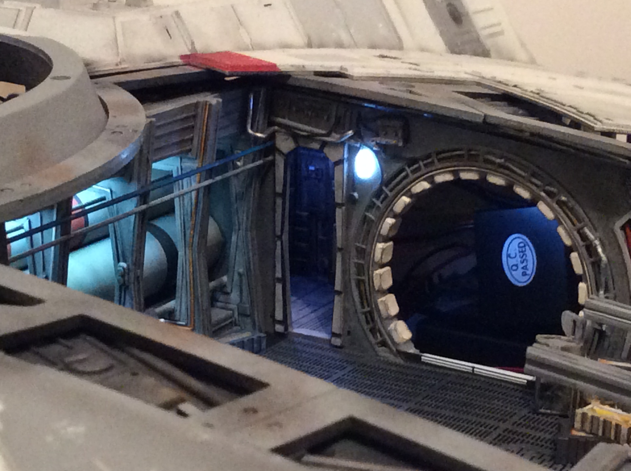

Talaris, I used Tamiya’s TS-7 on the Falcons Corridor’s cushions/padding followed by a clear Matt coat and weathering.
I’m certainly no expert regarding the Falcon’s basecoat but to my eye the Racing White is too white (almost cream like) when dry, but it’s your build mate so do what makes you happy.
I’ve added another pic (during my build) to show the contrast of it (TS-7) and the AS-20 (exterior hull) after clear coating and weathering.

I’ve added another pic (during my build) to show the contrast of it (TS-7) and the AS-20 (exterior hull) after clear coating and weathering.View attachment 1090471
It’s funny, to me from that picture they look like the same colour as the exterior, probably due to the lighting. Seeming as the fine molds 1/72 is the important one (and I don’t care about making an accurate replica from ROS), I think I’ll just use the 1/144 as a test and see how it goes.
