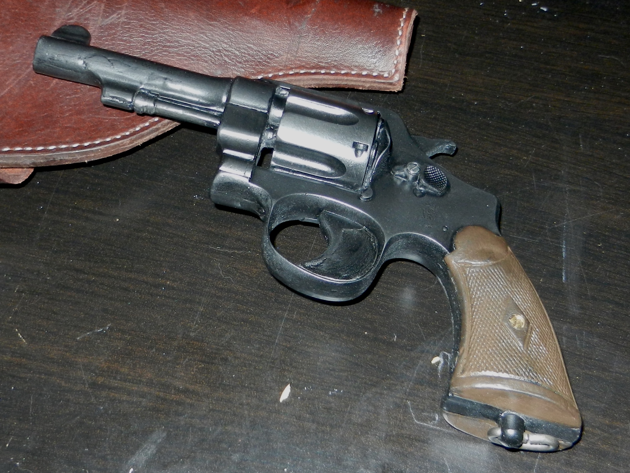

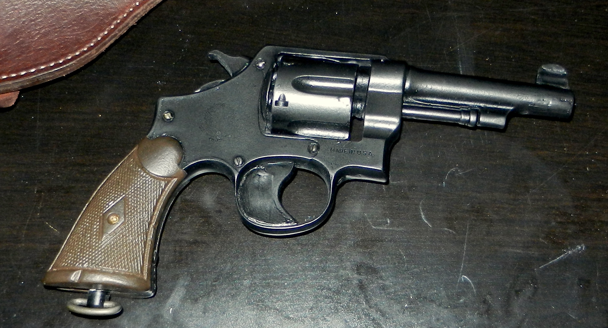

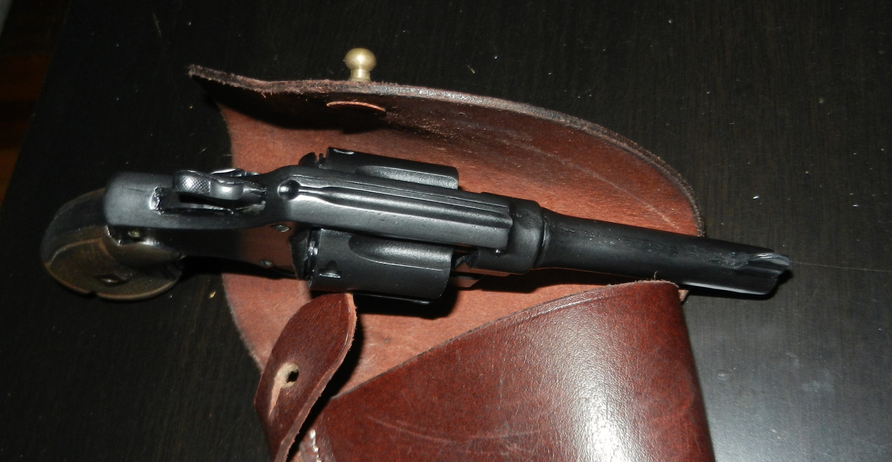

Okay - so I made some huge progress.
since the ink dried green, i tried to dry brush on some Krylon dark brown dura coat (hardware store find)...turns out its such thick nice paint it didn't dry brush on, it just brushed on! I tried to drag the brush through the semi-dry paint a little, and it gave it a nice effect, but the original casting had physical wood texture on the handle, so that really helped. I don't know how I would have done this on c96 MGC grips..
Took some time to drill/tap a lanyard loop in the handle. I used a "wood screw" mount from china
1PC-Short-1-PC-Long-Sling-Swivel-Screw-Rifle-Sling-Swivel-Screw-Studs-Base-Studs-Fits.jpg
and had to cut and bend a Colt revolver butt loop in there. The loop really didnt want to bend, like a D ring, so I cut it snd squished it in there, making the loop smaller and deformed, but it suffices :)
I then took an old drafting mechanical pencil, slid out the old thick "lead" and used coarse sandpaper to get a pile of graphite dust. I took my finger and smeared / buffed it all over the gun which turned it into a silvery gray! I even got some on the grips that I feebly tried to wipe off :lol then I hit the whole thing with a satin clear coat, which dulled the graphite but it still looks nothing like the original satin black paint finish. I like it! I was seriously surprised at the drastic change in the graphite layer
it was hard to photograph, but I think I got it.

Should the tip of the barrel be silver/stripped? I can use some silver Rub n Buff maybe..I already brass buffed the grip screw!
Very NICE!
It should be a little lighter as seen here: http://www.indygear.com/igguns.html You have the "Stembridge" version vs the "Bapty"(incase you didn't know;))
Although it appears that the version you have did not have the lanyard ring on the bottom, the one Indy carries throughout the rest of the film did though. I tried to link from www.imfdb.com for better/more pics to show the differences, but the page wouldn't load.
Aha thank you! I wonder how I can replicate that band on the front... I may try another layer of graphite, tho I have already sealed it
