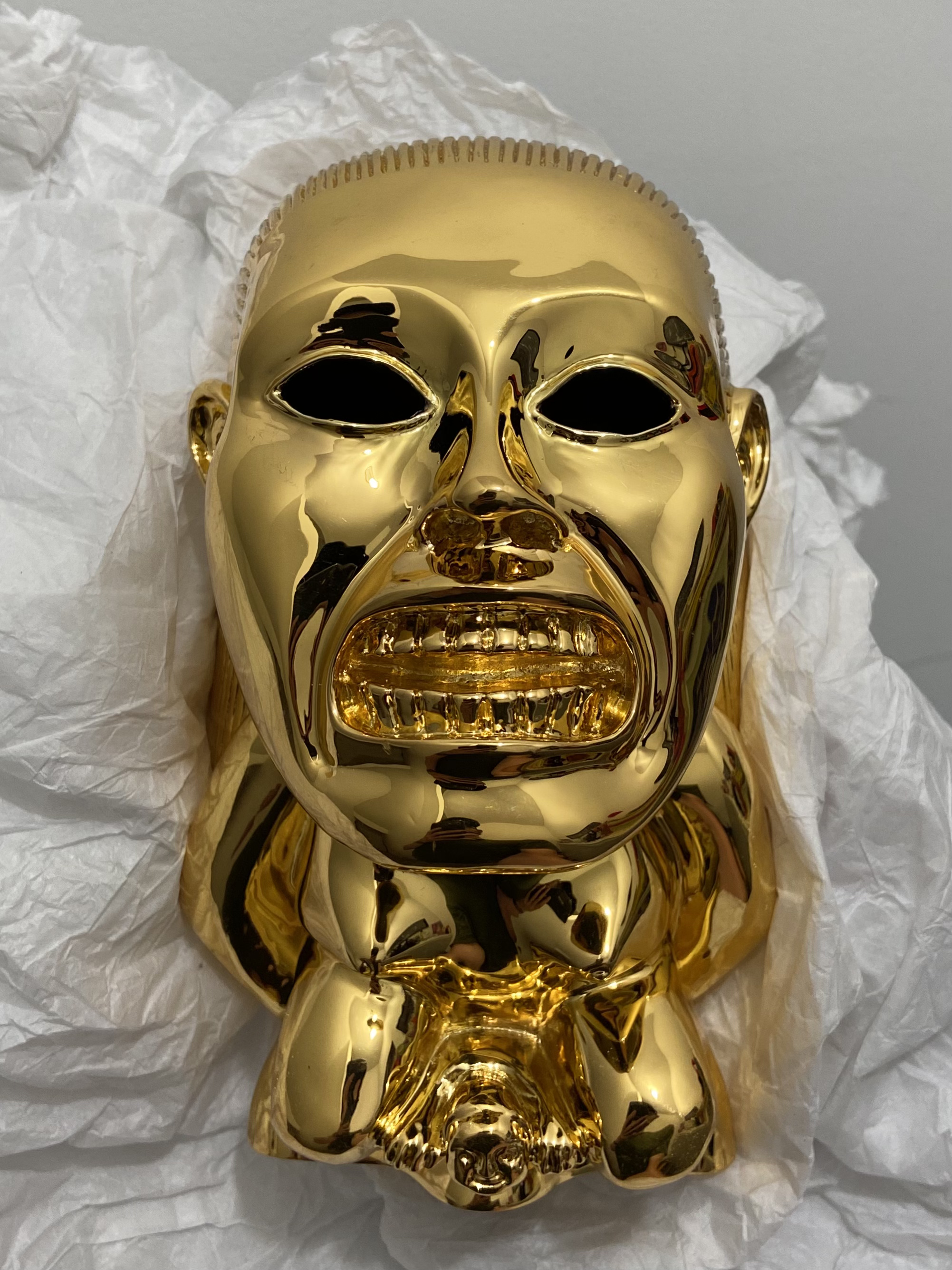

My order arrived today. They look fantastic, and I'm so happy with them. Thank you so much for such a great deal! The damage is barely visible, and I thinks it looks fine with it. Indy took a headfirst tumble down the hill to avoid the boulder, carrying the idol in his hand; so it'd make sense for the idol to end up with some bumps.
Again, thanks for everything! It's always an absolute pleasure working with you! Every time I order one of your items, it exceeds every expectation.

Wow! What a beauty! It’s got some damage on the back but nothing major. Really just looks like weathering. Really happy I was able to snag one of these. I didn’t get any eyes so I ordered a set of the eBay ones.

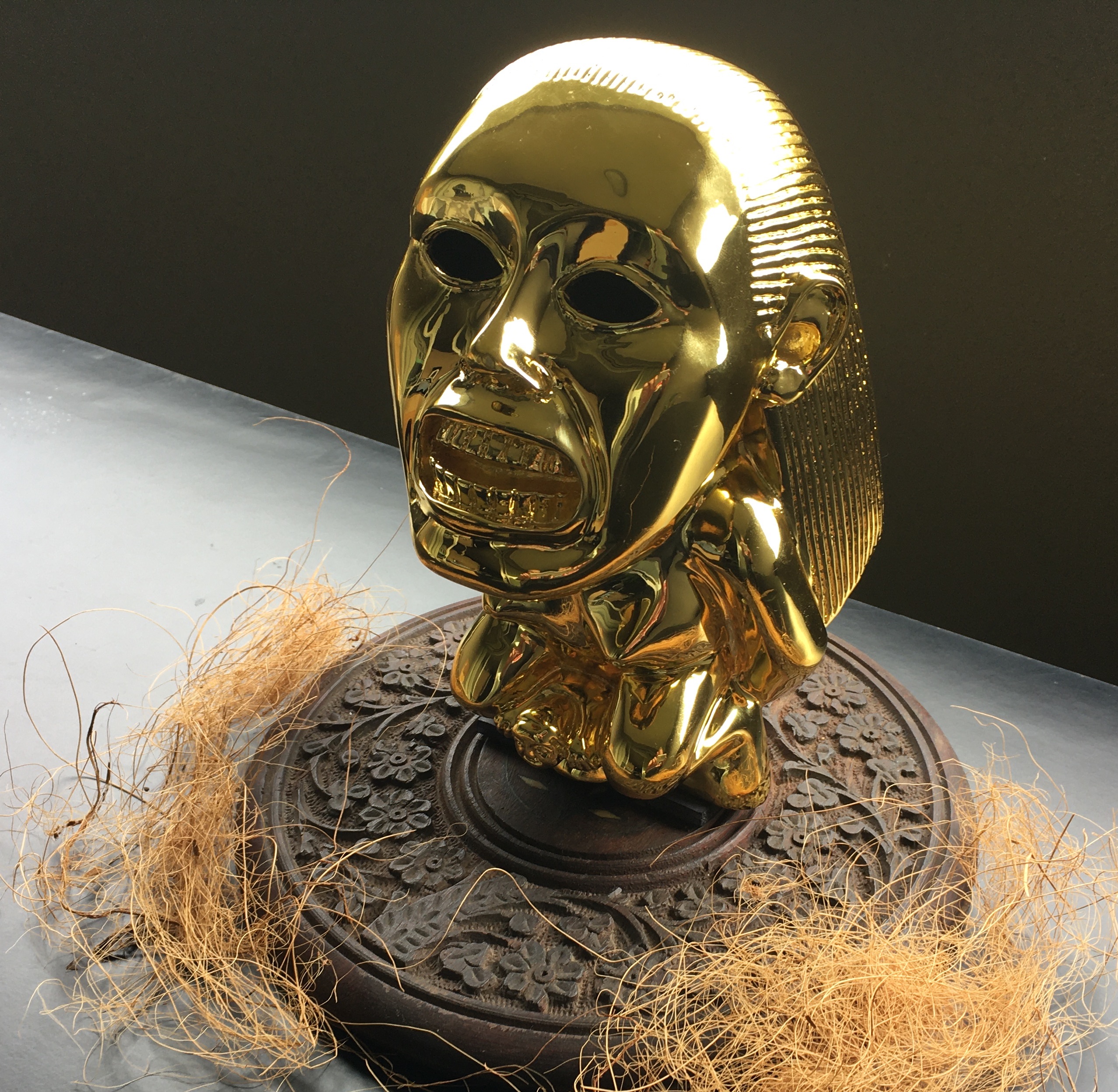

With all the reflections on the gold finish you can't really notice the scrapes and dings unless you get up close . I'll be adding a bit of weathering at some stage after i get the eyes fitted so it should all just blend right in.(y)
There's a nice solid heft to it too which makes it feel like the real thing and about the weight one could imagine Indy's sand bag could have been too.
