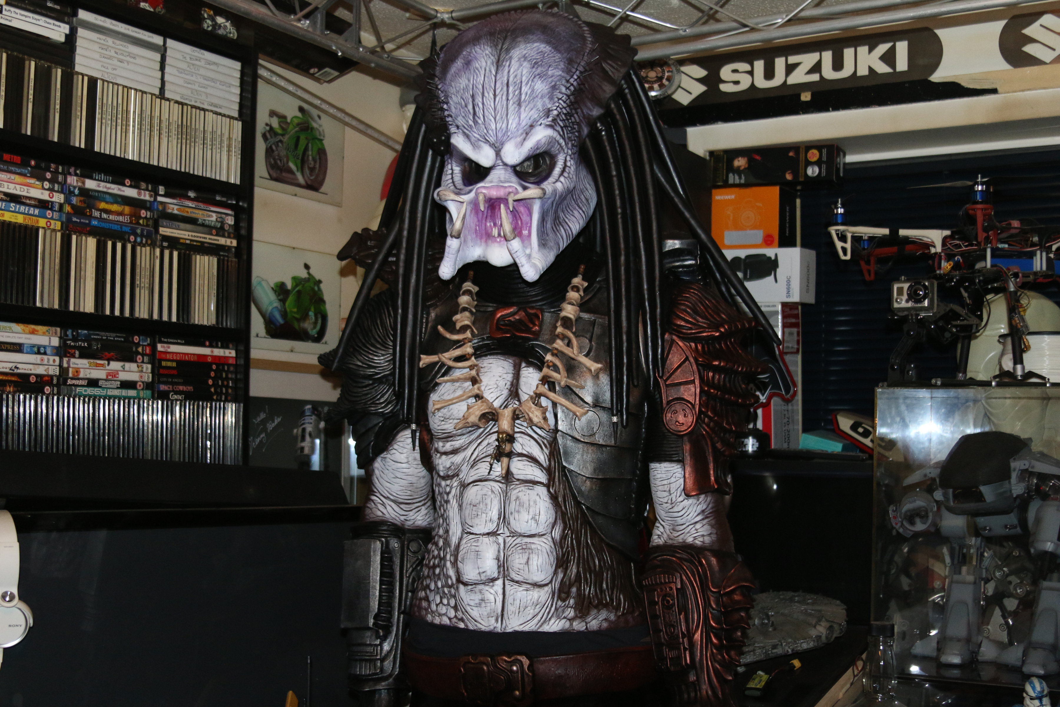

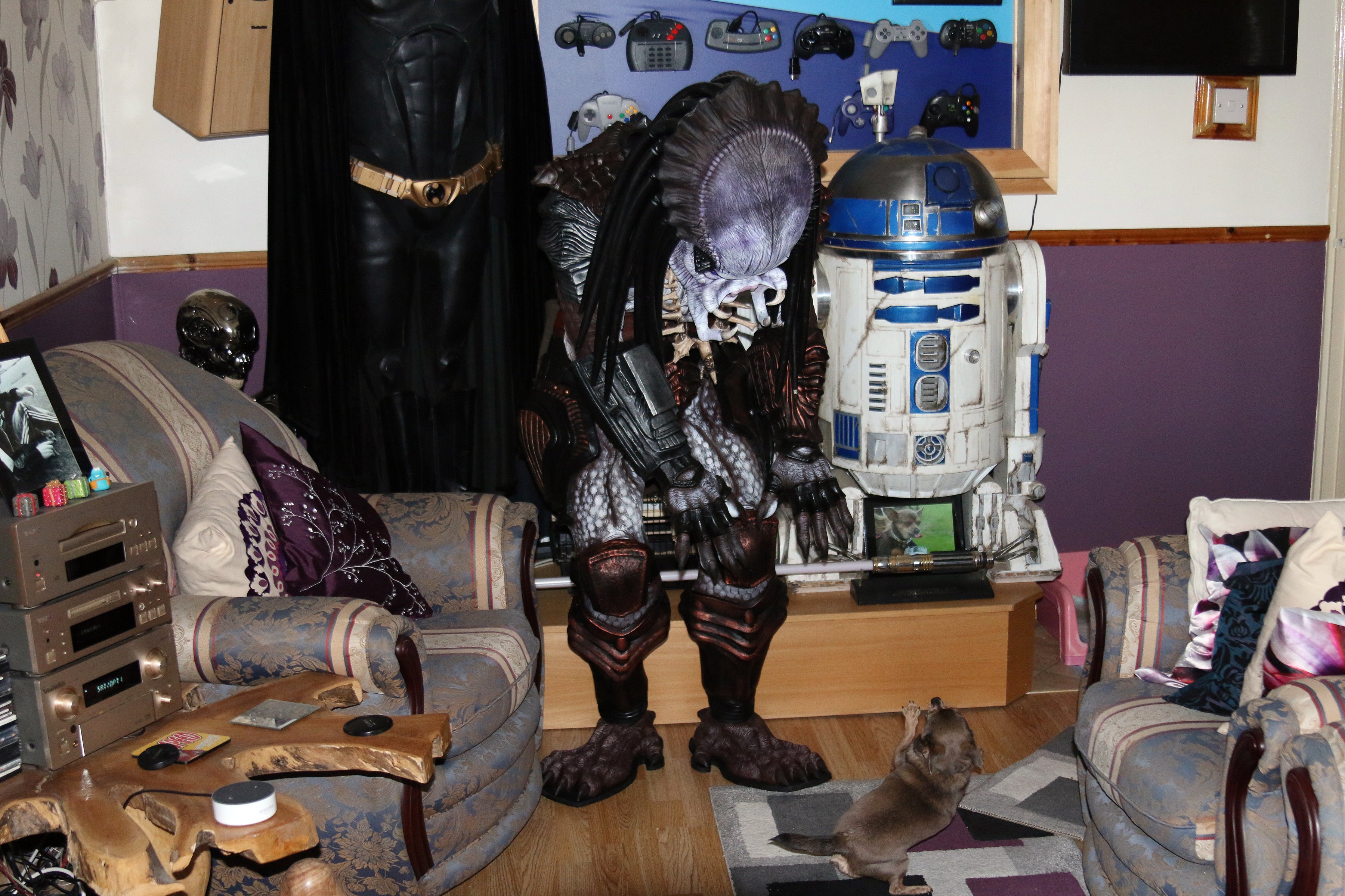

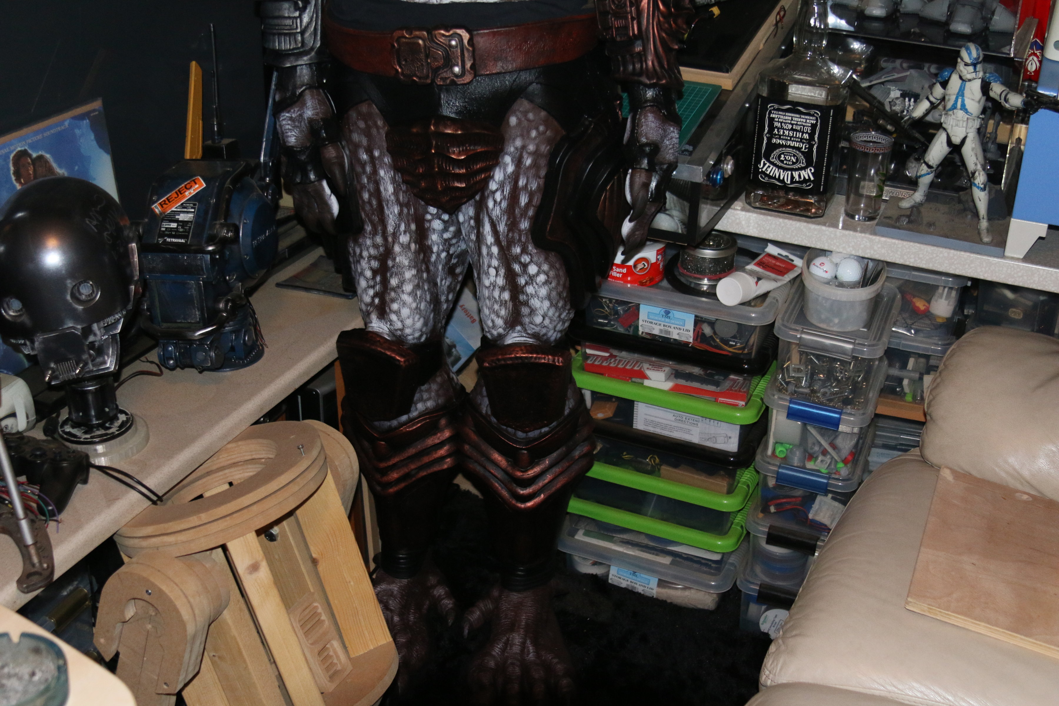

View attachment 267022 View attachment 267023 View attachment 267024
Haha, awesome, mate! And little trophy on the last picture is so nice :D :D
