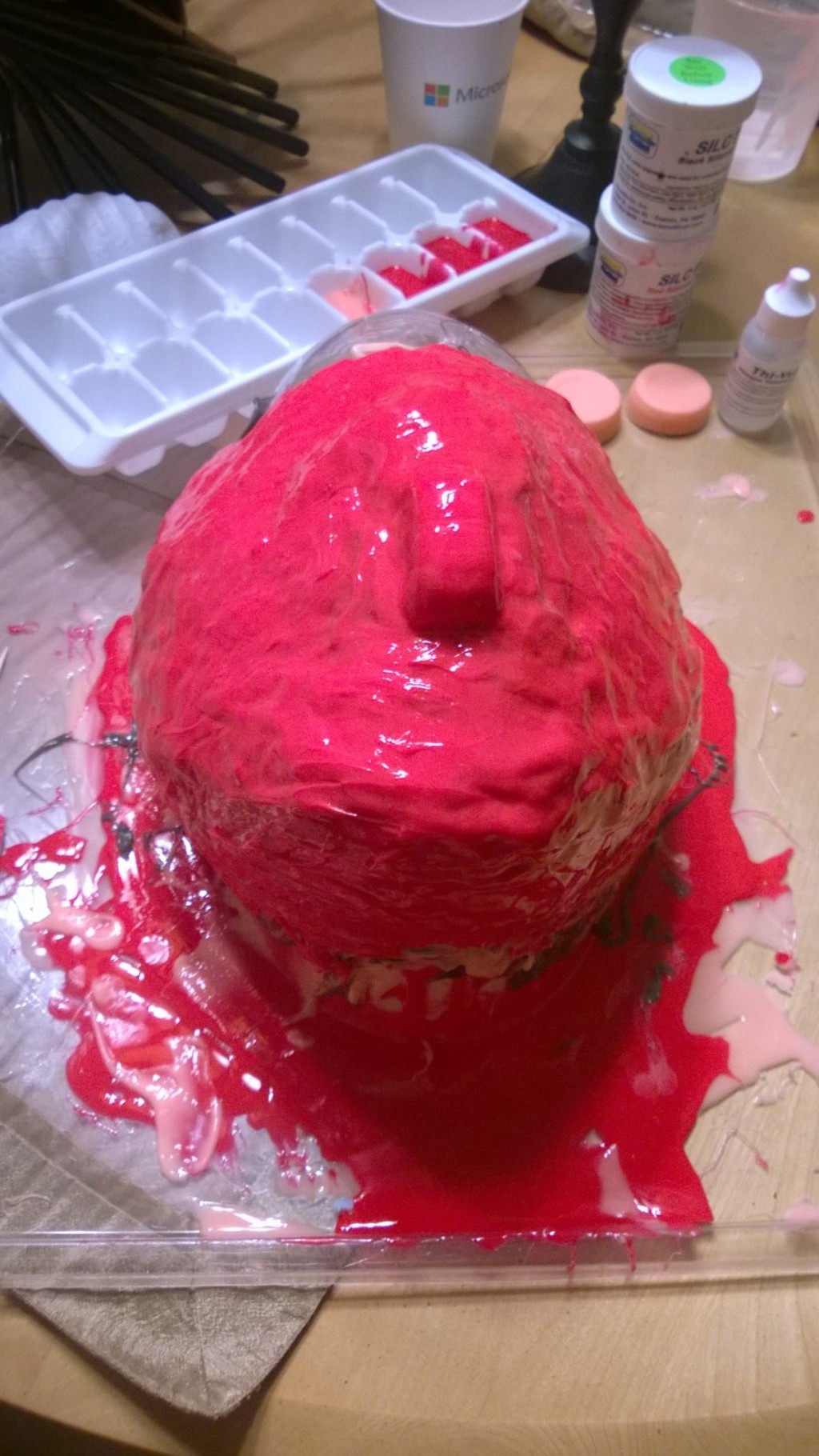

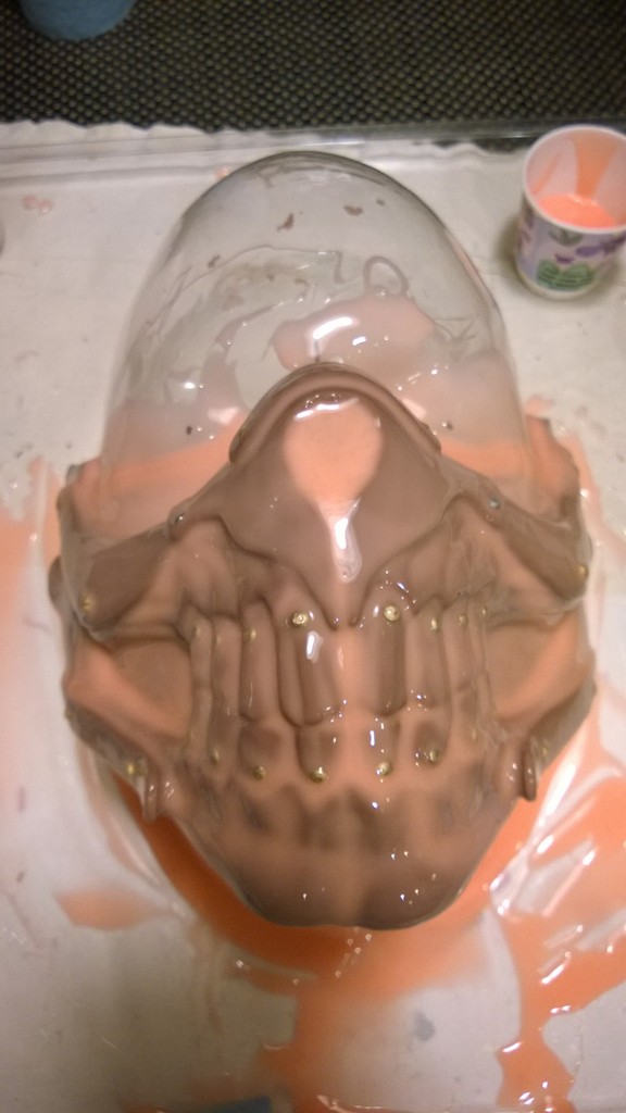

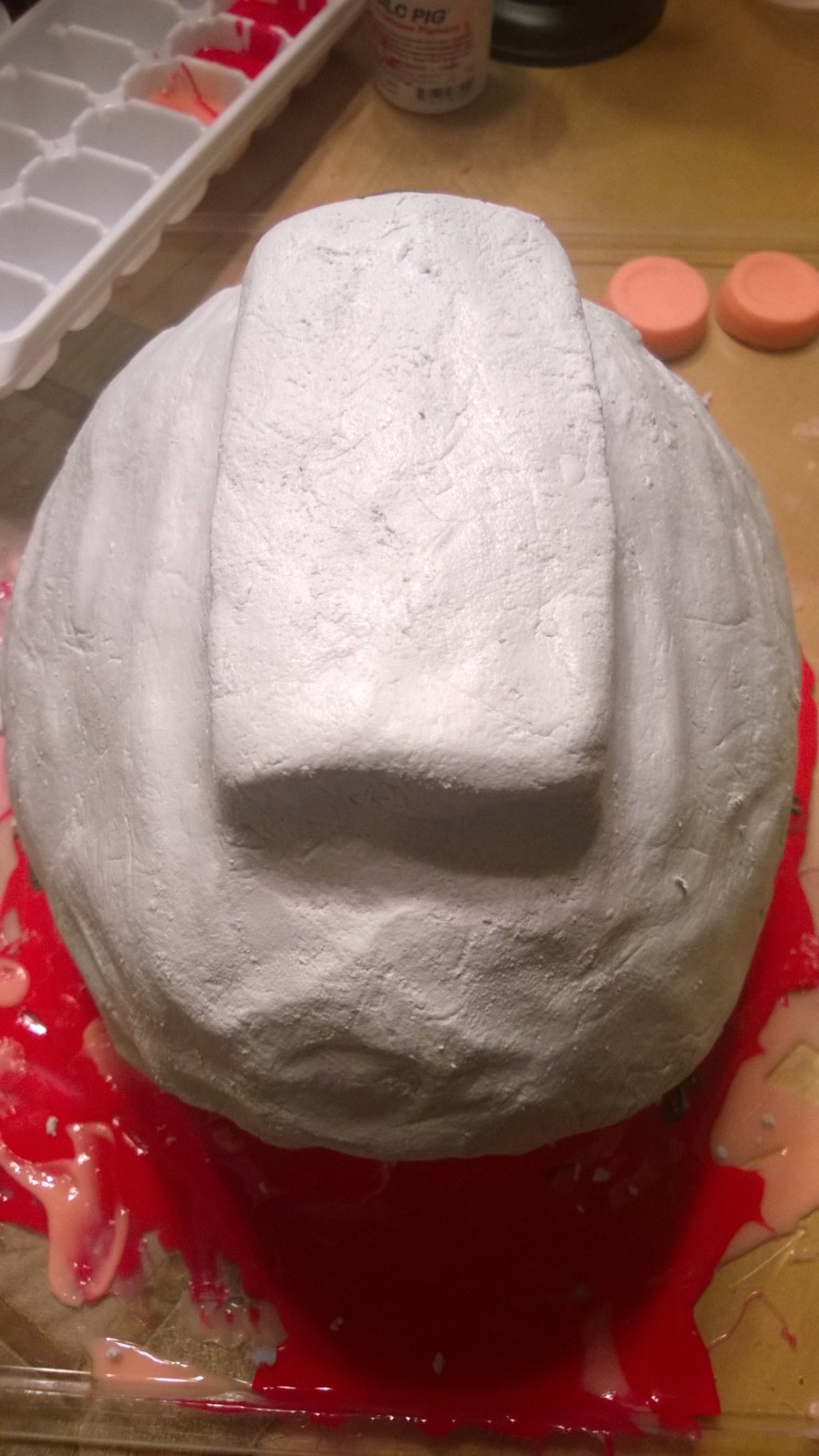

Molding this is pretty straightforward, however when I did it, I was rushing to be done for Halloween, so chanced it with a single registration key, and a single-piece support shell. Doing it again, I'd add more keys, and do a two-part shell. I just posted a few pictures of a method for the latter (on a Twisty the Clown mask) in a different thread: http://www.therpf.com/showthread.php?t=243676&p=3712666&viewfull=1#post3712666
Here are a few shots of doing Joe. I think I did 4 layers of Rebound 25, and then made the shell with Free-Form Air. I was worried about the little "metal" strips along the jawbone, since they have a little part jutting out, but they came out just fine.

I've never actually done one of those type of molds, but I'm pretty sure I have Rebound, that Thivex thickening agent or whatever it's called, and plastic paste to shell it. I'm surprised you got the shell done out of that Free-Form Air stuff, it never seemed to get much more than marshmallowy on me the times I've used it.
How well do I have to seal behind-the-mask against the head mannequin or dome that I'm sitting the thing on? Do I need to sculpt it fairly shut with something like klean klay or monster clay?
There are a few pretty good videos on Smooth-On's site on how to do the brush up mold.
Weird about the Free-Form Air; was it old? I've always had good luck with it.
You'll definitely want to build up some clay around the mask. If nothing else, just to fill in the gaps between it and the face. You can also build some small walls, to keep the silicone contained. Either of those clays will work, though Monster Clay would be difficult to work with for what you need to do. The easiest to work with would be a water-based clay, like EM2010. However, you'll have to keep it moist, if it's going to take a while to finish the mold.
