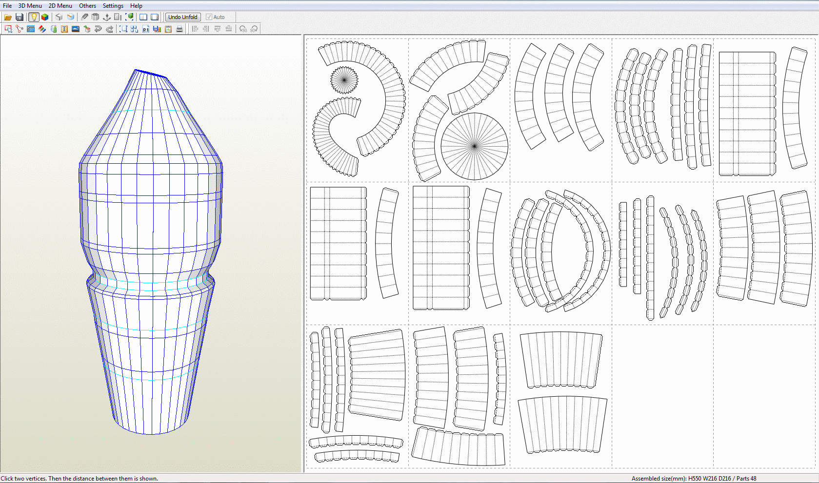

It was a quick sculpt and unfold, so not incredibly accurate, but should do for a background item in that full size Cantina I know you're all dreaming of building...
I've left out the small raised details and holes, on the basis that these are easy enough to drill out or add with styrene or cardboard later on.

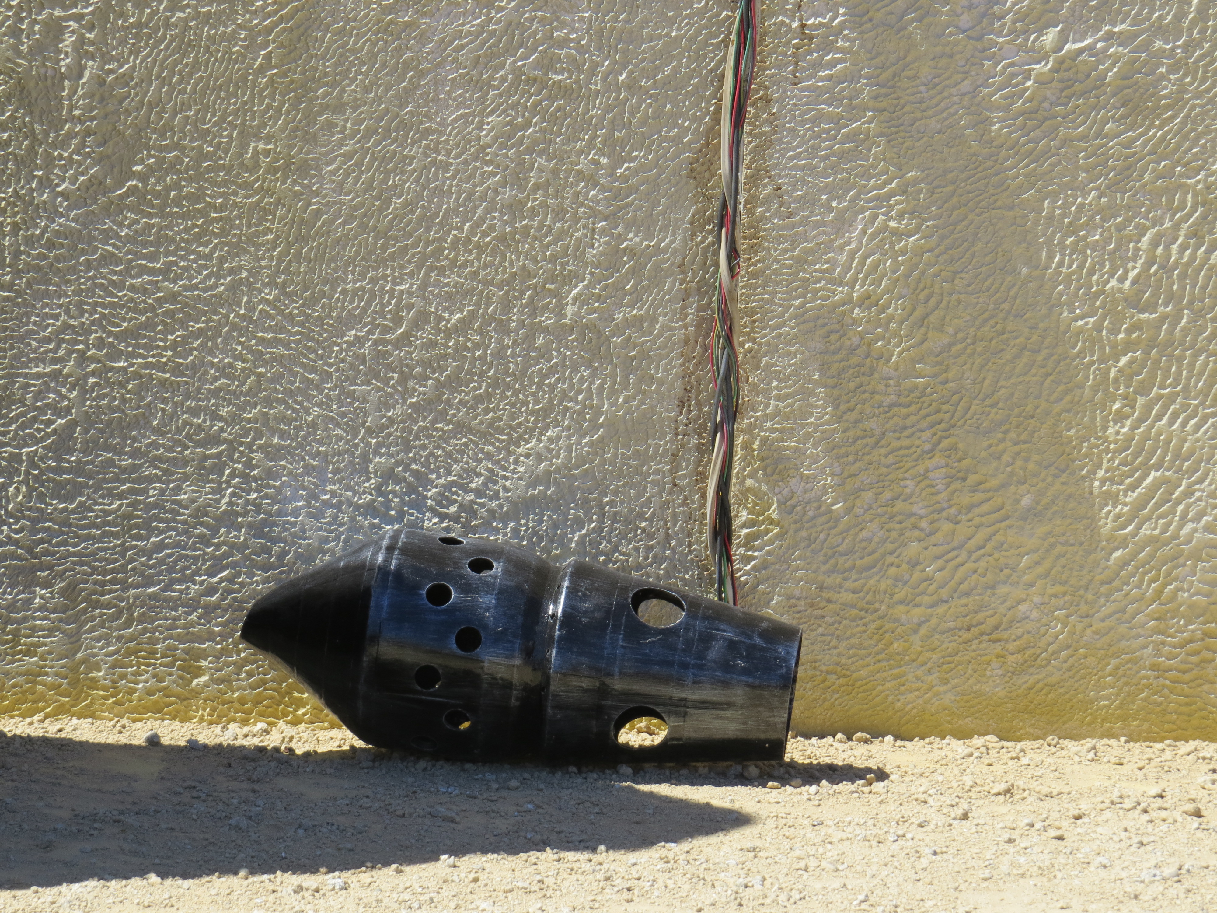

Well, we've been busy here Down Under, getting ready for a troop. IG-88 is going to be making an appearance - or at least his head will be, acting as a power droid. Planning on having a couple of bike lights inside with a swag of wires disappearing into the wall behind. http://www.therpf.com/f79/star-wars-themed-photo-backdrop-set-piece-build-189769/

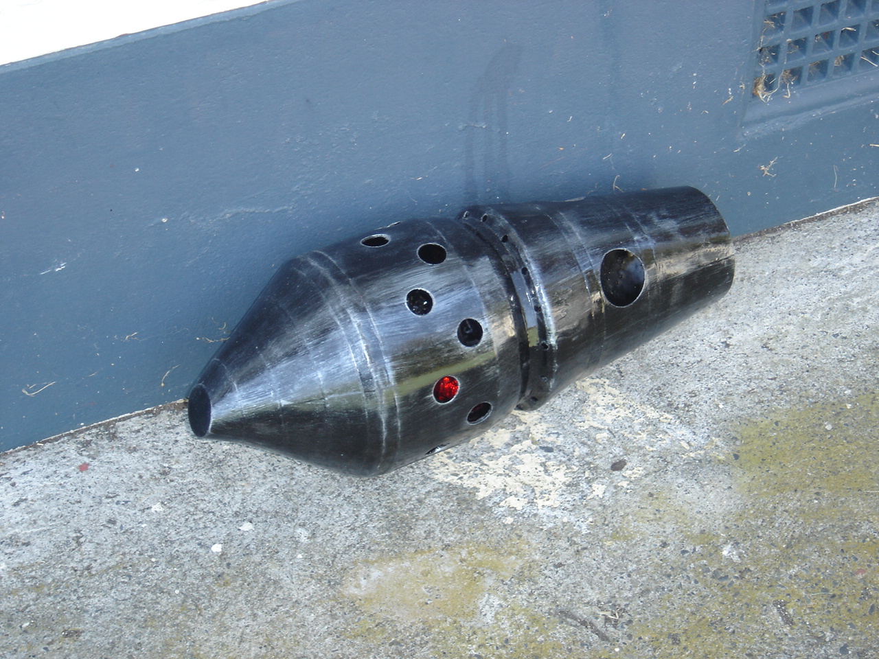

I'm really pleased at how the overall shape has turned out. The only downside is that fibreglassing the inside is quite a hassle - unless you've got two elbows in each arm - so I'm considering re-doing the pep file as a two-part build which bolts together about the 'equator'.

No, it's an easy build, but I was just in a hurry to get the inside fibreglassed, so I did the whole thing in one go. If I'd had more time I'd have rondo'ed it thoroughly, let it harden a bit, then glassed the inside top and waited until that was hard before doing the exhaust end. Give it a go!

We had a troop here today with IG-88's head making an appearance on the ground against the backdrop - and someone even recognised him! He looked good, too, not bad for a prop replica that cost about $5!
