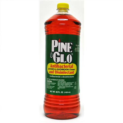

I use Pine Glo for cleaning

I use Pine Glo for cleaning out bottles and air brushes. let it soak for a day or so.

Yeah, there are household cleaners that will do this like the one above. The best depends on your location. In the UK there used to be a product called "Fairy Power Spray" that was absolutely brilliant at softening and stripping paint from equipment and kits without being harsh, smelly and corrosive. Unfortunately a few years back they changed the formula and it lost its paint stripping abilities.

I also see that the Pine Glo is available on Amazon. May have to pick some up.
I am in California as well.I get it at Walmart under $2 for a bottle
