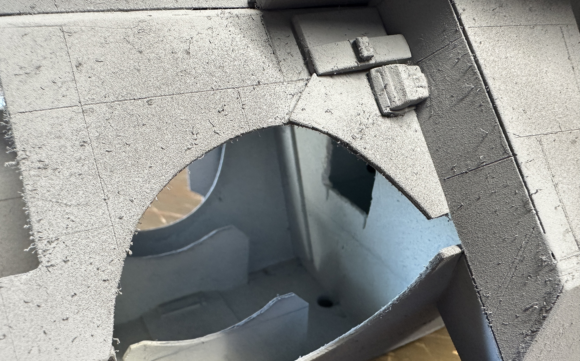

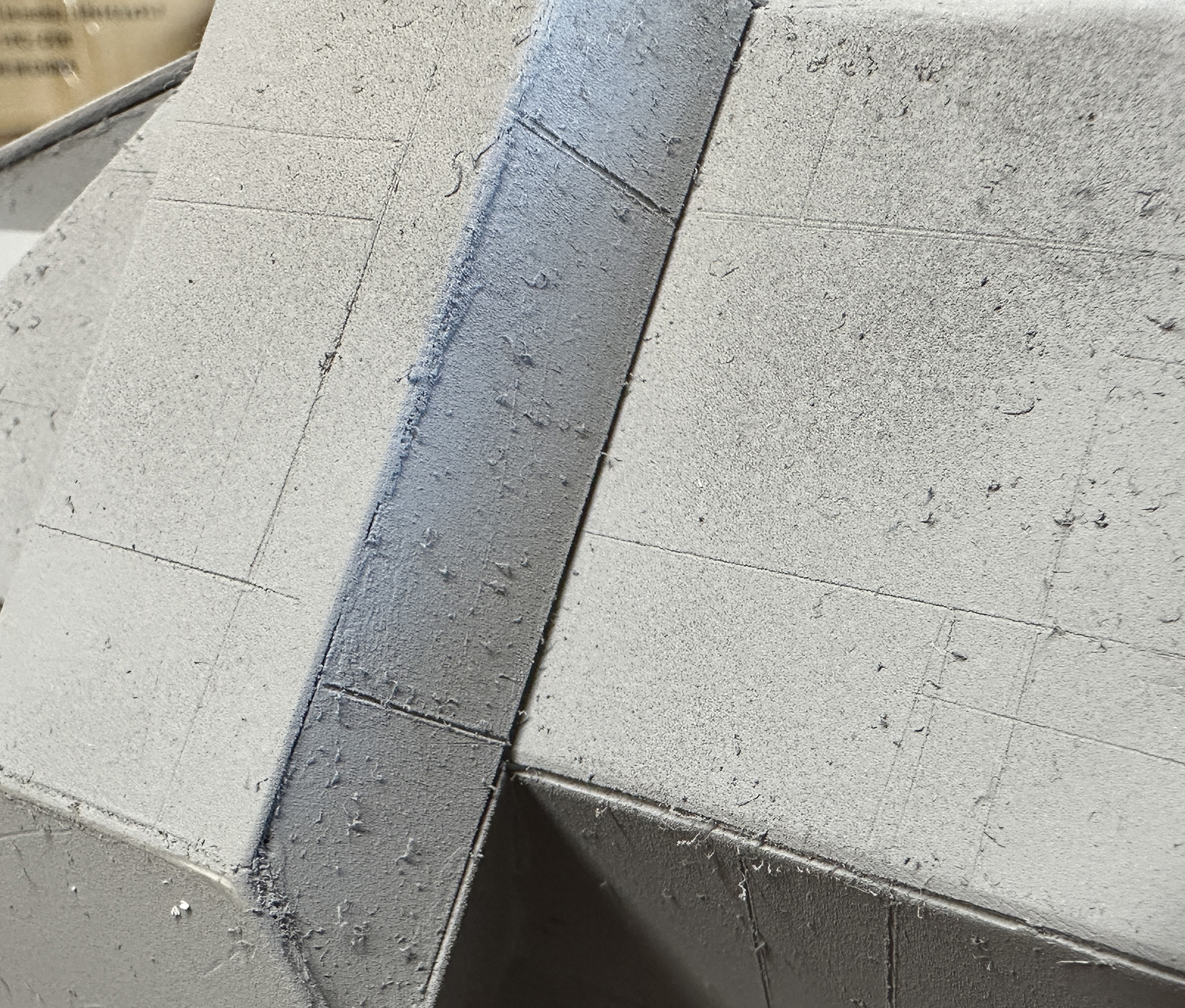

What happened here? How best to fix this? How to ensure this does not happen again?
I primed this model yesterday and got the ugly result seen in these close up photos, about 3" of surface.
I've seen this happen once before. It appears to be static electricity on the surface messing up primer layer.
After sanding I swatted and wiped surface with an old t shirt rag. Then I wiped clean the surface with odorless mineral spirits, also on an old cotton t-shirt rag. I let dry completely before spraying rattle can auto primer. Model was sitting directly on folded up cardboard on my truck tailgate. The cardboard has been used many times for spray painting and has accumulated paint on it.
I'm thinking I got static electricity on the model surface. Perhaps using the cotton cloth rags caused it, or do you have ideas or answers to this mess?
Thanks for any suggestions or advice.
Know of any good videos or tutorials on model prep best practices for painting?
Depends on the medium and the context. As prep/painting 101 is concerned, cardboard will have to be dusted very carefully before painting.
No need to say that any paint booth or others have to be clean (not hospital clean): no dust flying while you're spraying.
Do be careful, also, with platform/bases used on which you put on your model. These can be generating dust as well.
Plastics also have to be dusted/or damp rag trick before painting. Last, but not least; if you don't have a proper spray booth, the overspray can also leave paint dust on your painted or unpainted surface.
I wet sanded it and it's all good now, but I'm puzzled at how so much static got on the model. I guess it was the cotton cloth.
I like spray painting outside and often just throw cardboard on my tailgate and spray no problem. The tailgate has a spray on liner, but I wonder if somehow the truck battery can cause static charge on a plastic model on the tailgate.
I had luck with wet sanding then wiping it with a wet cloth. When I built my SW Chiss fighter years ago, I had dust where the wings angle out at the base. I Googled it and figured out certain areas can cause little vortices that cause the paint to dry before it hits. I've never ever seen that happen ever. I'm not saying it's that, but it's another weird thing that can happen.

As stated above, wet sanding is the key. I have found that wet sanding and then letting it air dry before priming works best. Prime it, wet sand it and let dry over night or all day. Then prime again. Most of my static issues were gone using this method.:cool:
Lightly blasting the model with an air-hose or even an air-can goes a long way towards removing particles and achieving a good finish before you paint.
