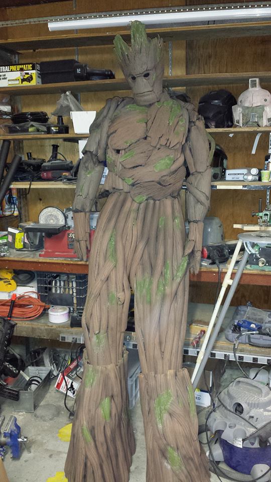

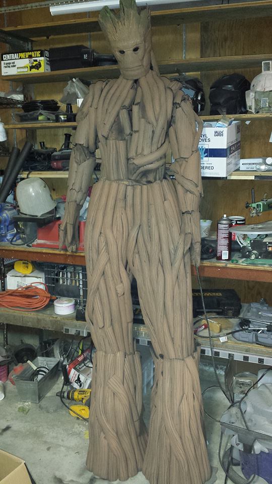

I am Groot ( Feet Built. Foam over foot tall wooden boxes with shoes bolted down)

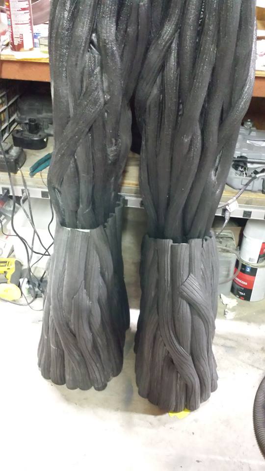

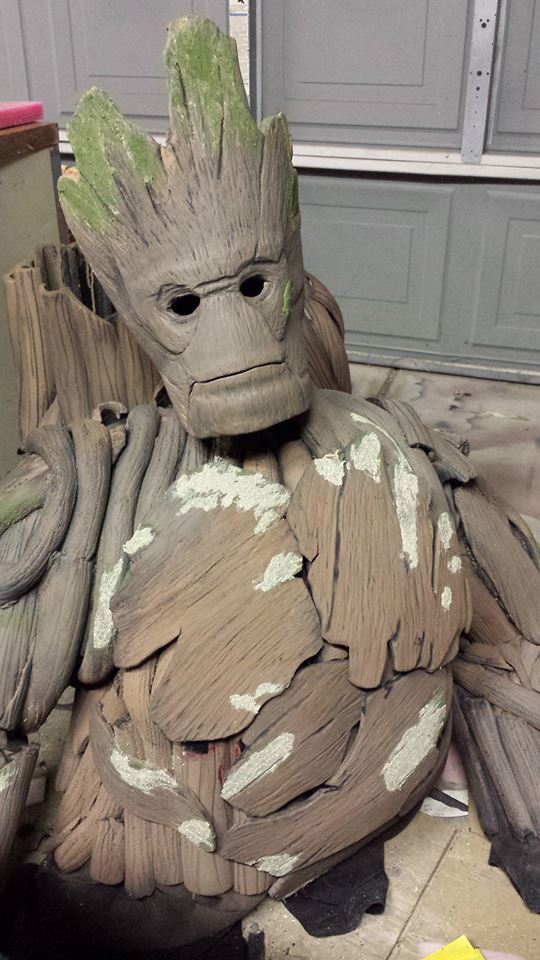

I am Groot ( Base brown on, body plates not included in photo. Letting it Dry overnight before I black wash and detail with greens to make it look "mossy")

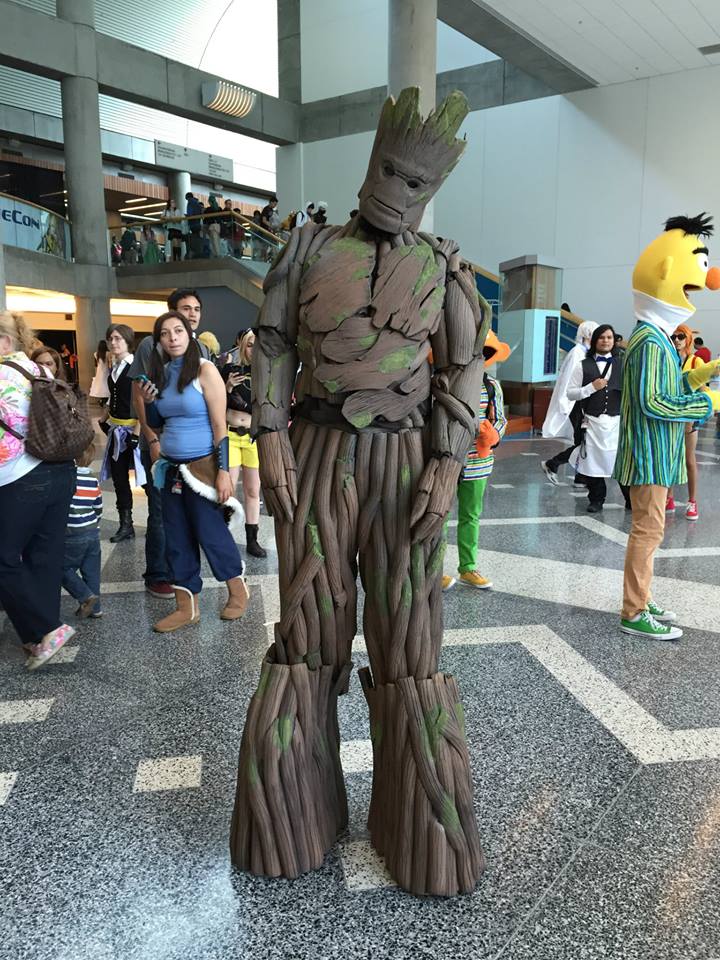

I am Groot( Pretty much done, just needs stress testing, after I get some sleep. Con is in a couple days. The Moss texture is made by spreading glue to areas then flocking/rubbing sawdust/foam dust over it then going back to brush on green paint. I used hot glue on the EVA foam parts because it spreads to how I want but since hot glue would melt the insulation pipe unless cooled a bit first I spray glued with super 77 in those areas with insulation pipes.)
