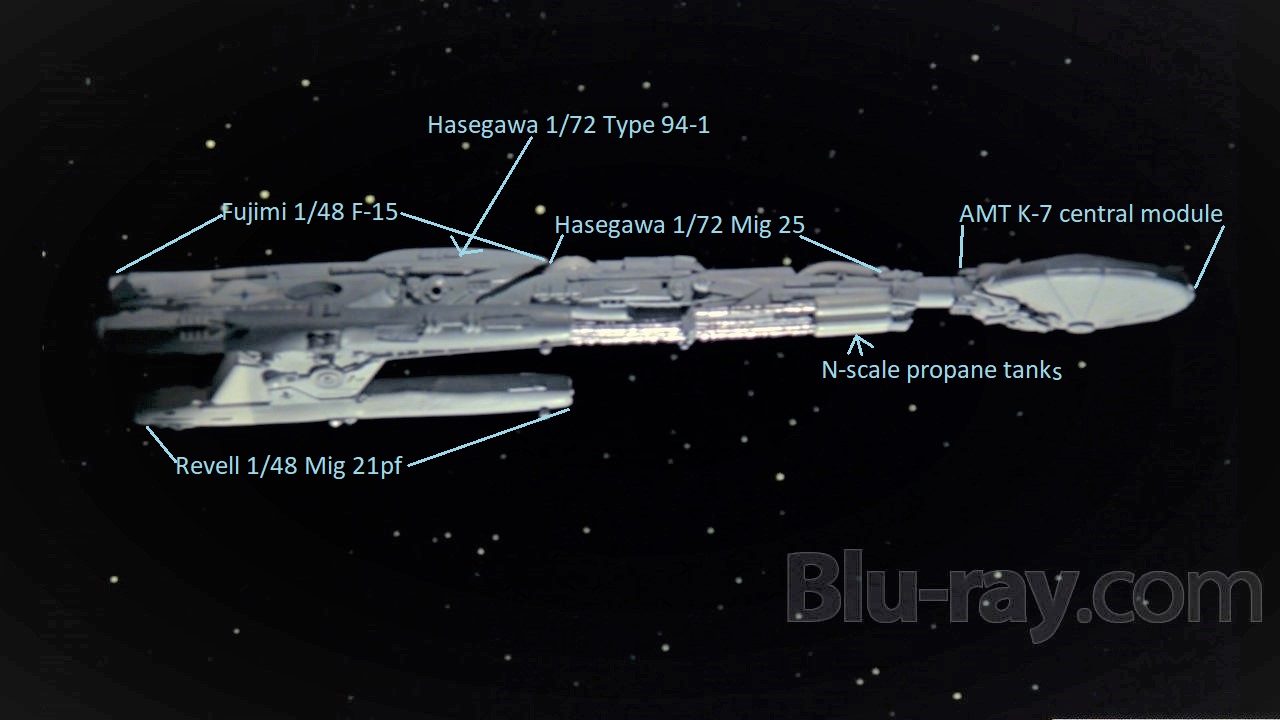

I am working on this project as well, it is (The Shape Of Things To Come) 1979 TV show.
The first part I need help on is what floatplane was used on this model ?
If I'm not mistaken, I see the rear engines are from a F-15 And the nacelles are from a MiG-21. I think the pontoon things are actually conformal fuel tanks from an F-15 or from the upper or/and lower halves of a F-15 kit.
TazMan2000
Wrong shape for F15 conformal tanks, I just looked at those parts in my Revell 1/32 F15 kit and the shapes don't match. I'd say they are seaplane floats.
If that main body is a 1/32 Eagle (what it looks like I think) then that makes the floats from 72/48 scale kit i'd say.
SAS

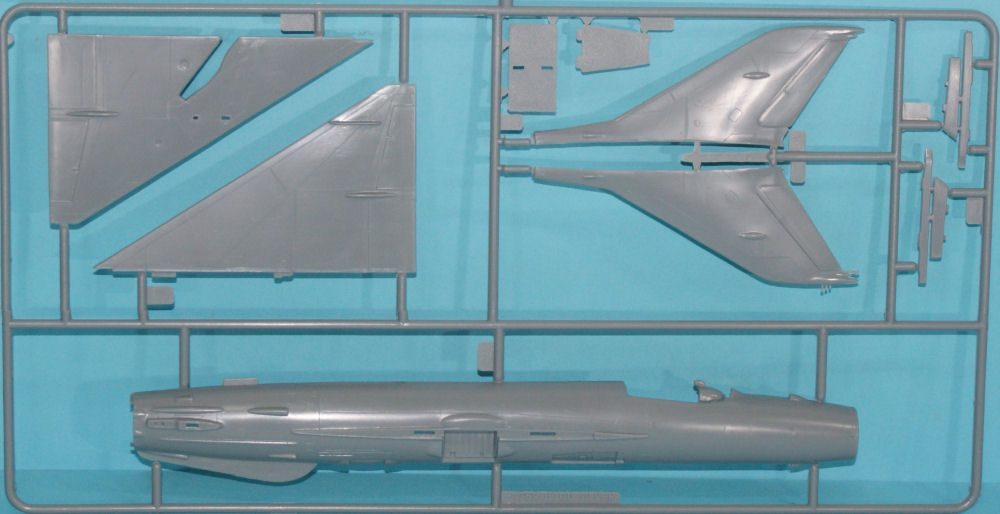

What do you think of the AIRFIX 1/72nd Scale MIG-15 parts?
Also does this kit look like the right ones ?
The 2 outer pylon parts are from the Revell 1/48 scale MIG 21-PF kit (you'll need 2 of them).
-eminto
-eminto

Hmm, that pic shows I was wrong, it is two halves of a single float after all.
I think it might be a Japanese naval biplane with floats - the Type 94 aka Kawanishi E7K - Hasegawa do it in 1/72 and it was produced in the 70s so the age is right.
https://www.scalemates.com/search-solr.php?fkSECTION[]=Kits&q=Kawanishi+E7K&qs=Search
The floats look the correct profile and in particular have very tall squared off ends which is unusual as most floats go to a pointy end.
A rough calculation and I make the floats of a 1/72 kit should be about 95mm long.
SAS
I think that the pair of half cylinders forward of the light grey disc are cut from the end of the 1/72 Hasegawa Leopold barrel.
Good eye and find, thanks !
I do have 5 or 6 kits of the 1/72 Hasegawa Leopold kit.
:cheers

Here's 80% of the parts identified. I'm currently working on my 'Starstreak', and will post it when finished!
Great design from a horrible horrible movie ; )
*The front of the Mig 21pf's have a 1/35 panzer III road bogie attached to the front.
