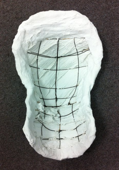

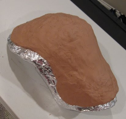

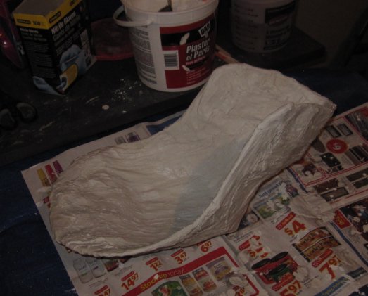

I would think you would want a thin layer of glass over whatever you covered your mask with and then once it is hardened, return to the underside of the armature and continuing laminating from underneath. This would ensure a much tighter fit to your mask. Otherwise your're just building up away from the mask and increasing the gap (The Armature edge becomes the gap). Does this make sense? Now, you may run into a problem with masking tape if you try to do it this way because, from past experience on my latest headache project, the resin doesn't bond with the masking tape and delaminates (At least Smooth-On 320 did). If you do try and glass the underside, just make sure the tape isn't delaminating. Just my two cents...
Iremove the tape first, cause i use pva mold separator over it and then i add the fiberglass,its easy to remove, i know people is asking for pics but, until i have a raw mask in my hands i cant do it, but i want to

Not to digress, but I'm going to: you can use wire, wood skeleton and wire mesh to create your forms. Cover that in an absorbant fabric, like faux velvet, and paint on a couple coats of West System Epoxy Resin (Epoxy is better on the nose, though a tad more expensive and not as easy to come by). Then go back and glass the inside/foam fill (Check boat supply stores for 2-part marine foam) for further support. You could also cut insulation foam into rectangles, glue layers together, carve a basic shape and glass over that shape and refine the detailing...
