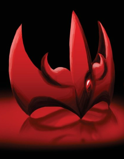

How do you guys recommend I should go about measuring someone's head if I were to replicate this crown. I assume with a measuring tape, but what do you measure on the head to make sure it will fit and stay on the head?

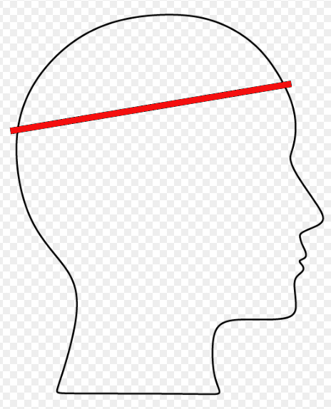

That part of the head is the widest part, anything smaller in measurement would cause the crown to ride up, anything bigger would cause it to droop. What you want to do is line up the crown and sculpt it based on that measurement. you can sculpt it to go down to the brow, but if you keep that measurement it will ensure that where that sculpt is made it will stay. the easiest way to sculpt it would be a lifecast of your actor, but if you dont have that, i'd take that meaurement i showed, and build up styrofoam or manequin head to be proportional to that measurement.
