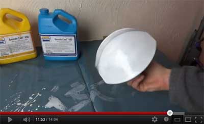

I've been doing some testing with plastic coating plastazote foam, although I've only tried it a couple of times, I'm pretty sure it could give some amazing results with practice. Essentially this gives you the speed and ease of foam building with the finish of plastic or fiberglass pieces.
Here is my foam test piece:
It also works for expanded polystyrene and other materials, so I think my next project will be a Terminator Endoskeleton made out of foam, carved polystyrene, cardboard tubes etc, all plastic coated and painted up like metal.
Here's an article with words: XRobots.co.uk/coating
And a YouTube video showing the step by step process: XRobots - How To plastic coat foam & expanded polystyrene prop and costume pieces - YouTube

Please excuse my ignorance, but what is the advantage in using the smooth on rotocasting stuff over say just fibreglass? Could you use the same process you described using fibreglass resin? (nice tip on using PVA as a primer :thumbsup)

Yes possibly, but without reinforcement polyester resin would be quite brittle, the Polyurethane is much better in thin sections.

Thanks guys, to answer a few questions:
-Yes I'm using 10mm foam, but you could probably use 5mm thinnest I'd say. I had some lower density 5mm foam and it was quite 'floppy', so you might want to put cardboard formers in the piece before coating it.
-I've only used Smooth cast 65D which is a rotocast resin, which means it 'self levels' and gives a nice smooth surface - normally on the inside of the piece. You could try other Urethane resins, but you probably want lots of thin coats to avoid lumps.
-In terms of strength it feels pretty good, but what you see is all I've made using this process so far. It might be worth coating the inside as well as the outside of the piece for extra strength, and at that point you could always reinforce the inside with more resin as thick as you like.
-The foam I'm using is Plastazote from: Thames Valley Supplies - Rubber & Foam Converters - Rubber Snow Plough Blades
