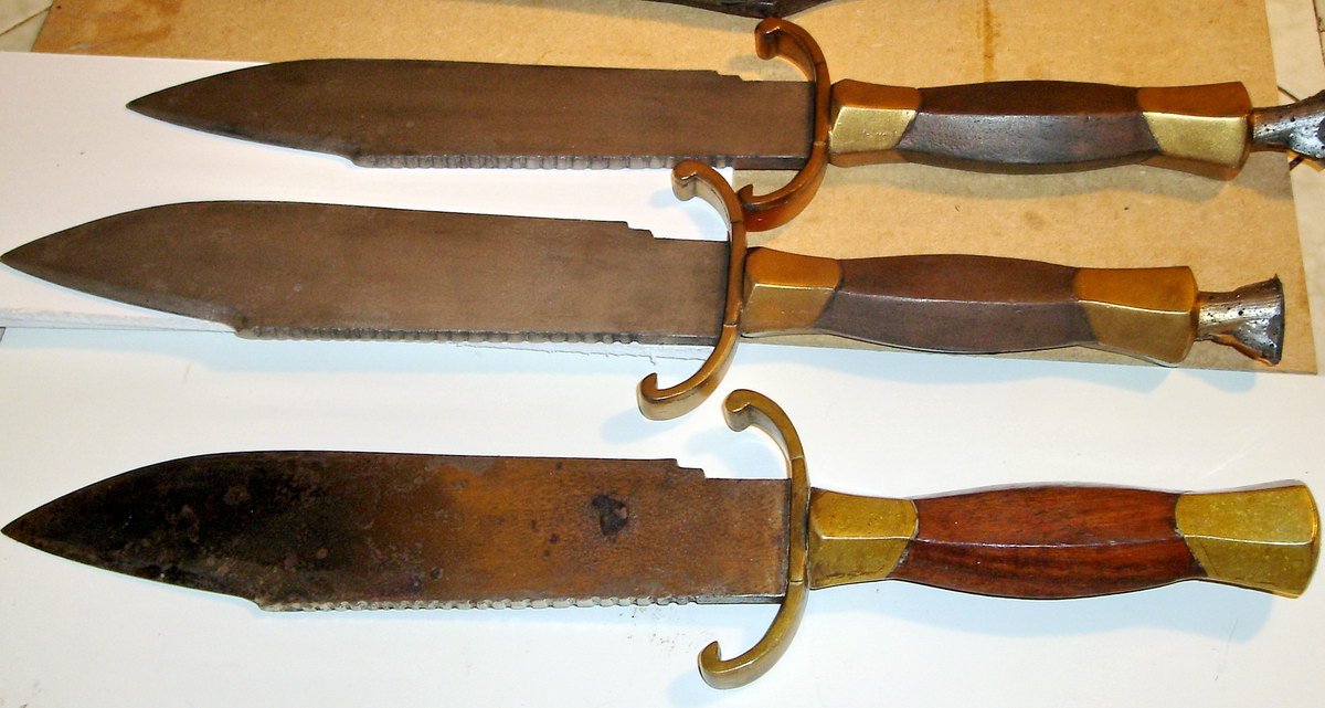

200 mesh will likely just fall to the lowest point. It's heavy and dense. I doubt you would be able to brush it up in a mould. Retailers generally don't get involved with selling metal powders finer that 450 mesh due to safety concerns. It also allows them to sell quantities more than what you would really need in a much finer mesh. Years ago I tried all sorts of "cold casting" with minimal acceptable results and noticed the waste of metal powder. You'll also see people claiming metal powder in resin adds strength and durability. The issue is cheap hobby resin will always be cheap hobby resin. It's brittle by nature. Better material will achieve better results. But it comes at a $$$ investment. Same with metal powders. Invest in the material once. It goes a long way.
I don't have any examples handy. Next time I turn the computer on I'll find something. Until then here are a couple. No cold casting, all parts strait from the mould as is. The bright silver parts are aluminum powders. The darker coins are a mix of oxides, graphite and nickle along with some brass.

Thanks, that's the look I'm going for! If retailers don't have the powders, can you post of PM me a source? And when you say that they're not cold cast, do you mean that they are achieved by brushing fine powder into the mold and then pouring unfilled resin on top?
