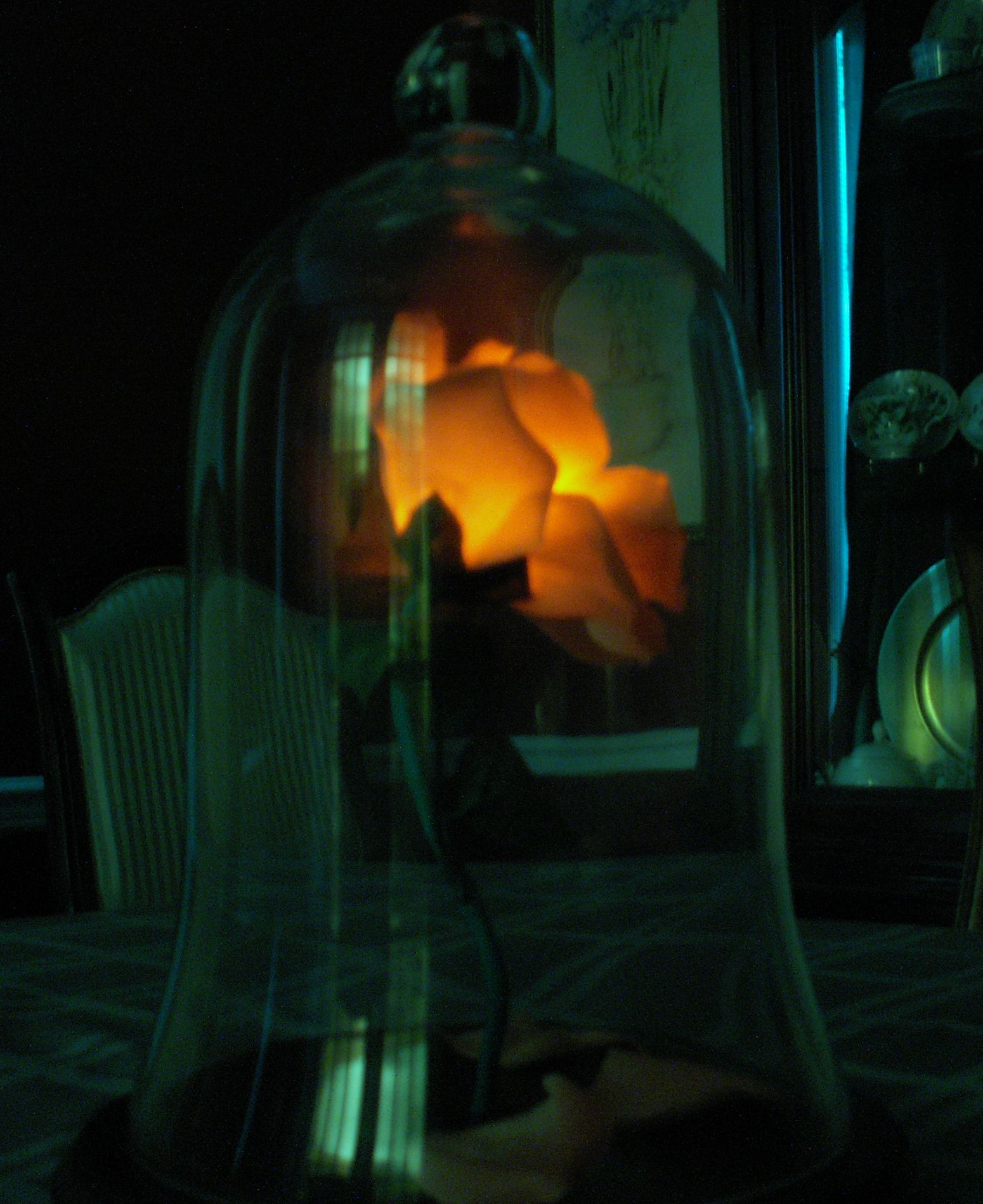

very nice work, but just a question for you. Why don't you have the rose light up as well, the material would also act as a diffuser.
I personally only lit the rose for the one I made for my wife and it's a nice source for the light.
My camera is terrible, and so is the lighting in the room, but the head lighting is nice:
View attachment 729256View attachment 729257

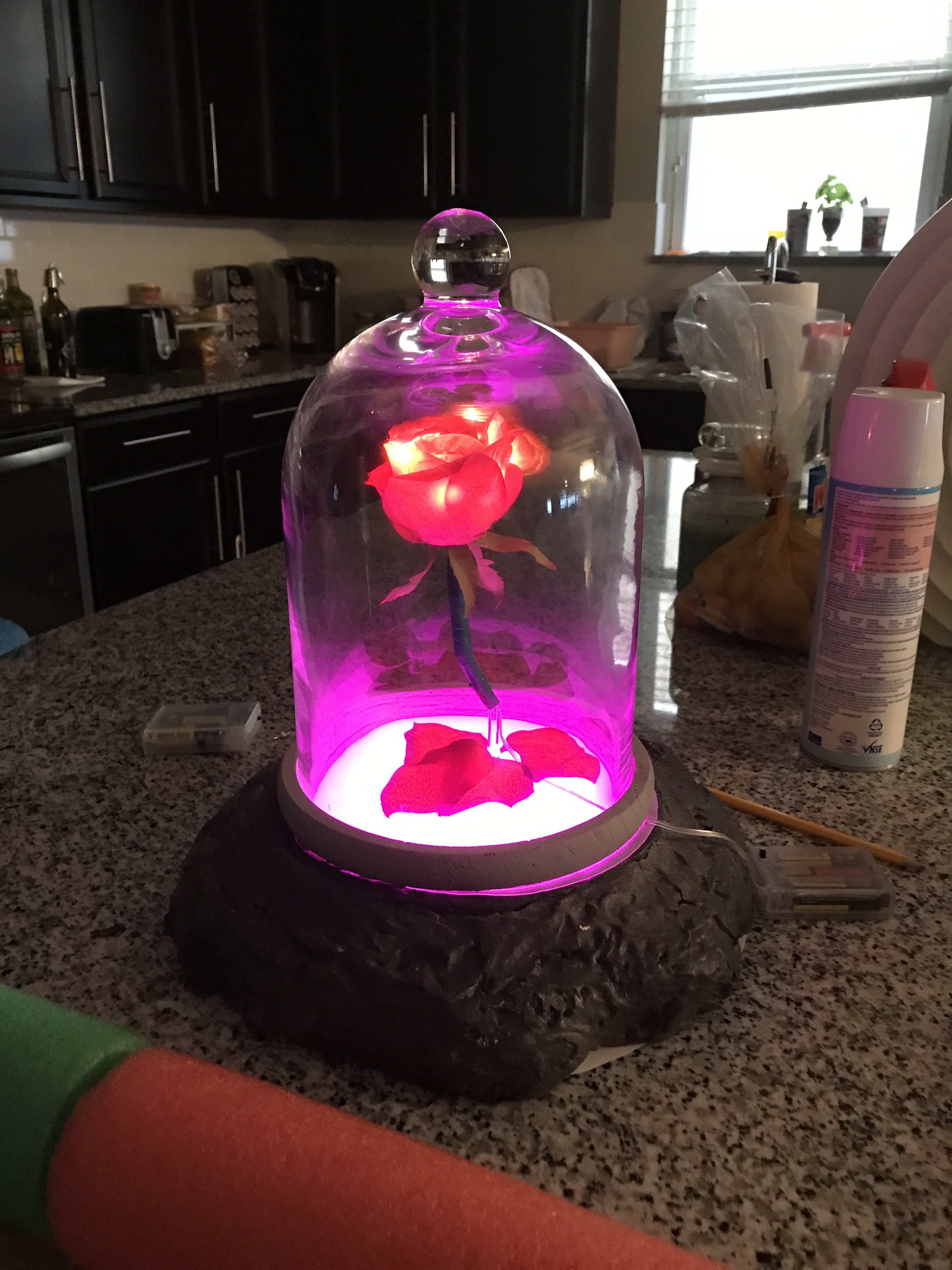

I am super excited with the progress I made. I originally wanted to make the top removable to service the lights if I needed to. Once I gave up on that and decided to make an access panel in the bottom for that I was able to get the plexiglass base on the way I wanted.
These pics just have the lights stuffed in the cavity any which way. I need to figure out a way to keep them from pointing directly up. I also still need to paint the edges to take care of the light bleeding out the edges. I am also going to physically attach the ring to the base. That should make the effect seamless.
Then I still need to paint everything up, drill the hole for the rod for the rose and finish the bottom panel.
I am working on an enchanted rose for my daughters birthday and wanted to know if there is a better way to make the circle of LED lights look more like a solid light? Right now they are attached at the bottom through holes I drilled. I tried a frosted plastic over it and it is better but still not what I really want.
The goal it to edge light the glass bell.
Any tips? I am open to different lights too.
Thanks in advance!!!
View attachment 729179View attachment 729180View attachment 729181

I basically made an arc reactor to fix the lights. Really happy with the outcome.
