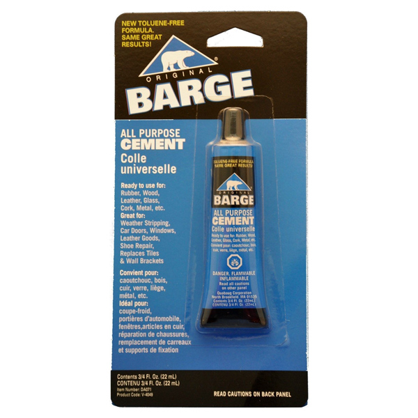

i'm sure super glue would work.
if not what you're looking for try barge contact cement.
you put it on both things you are gluing together....let it dry out a little ...then touch them together. super strong!
always make sure you test things out first....don't want to screw up your good stuff.

Thank you ultraman! I will be sure to try it out!
