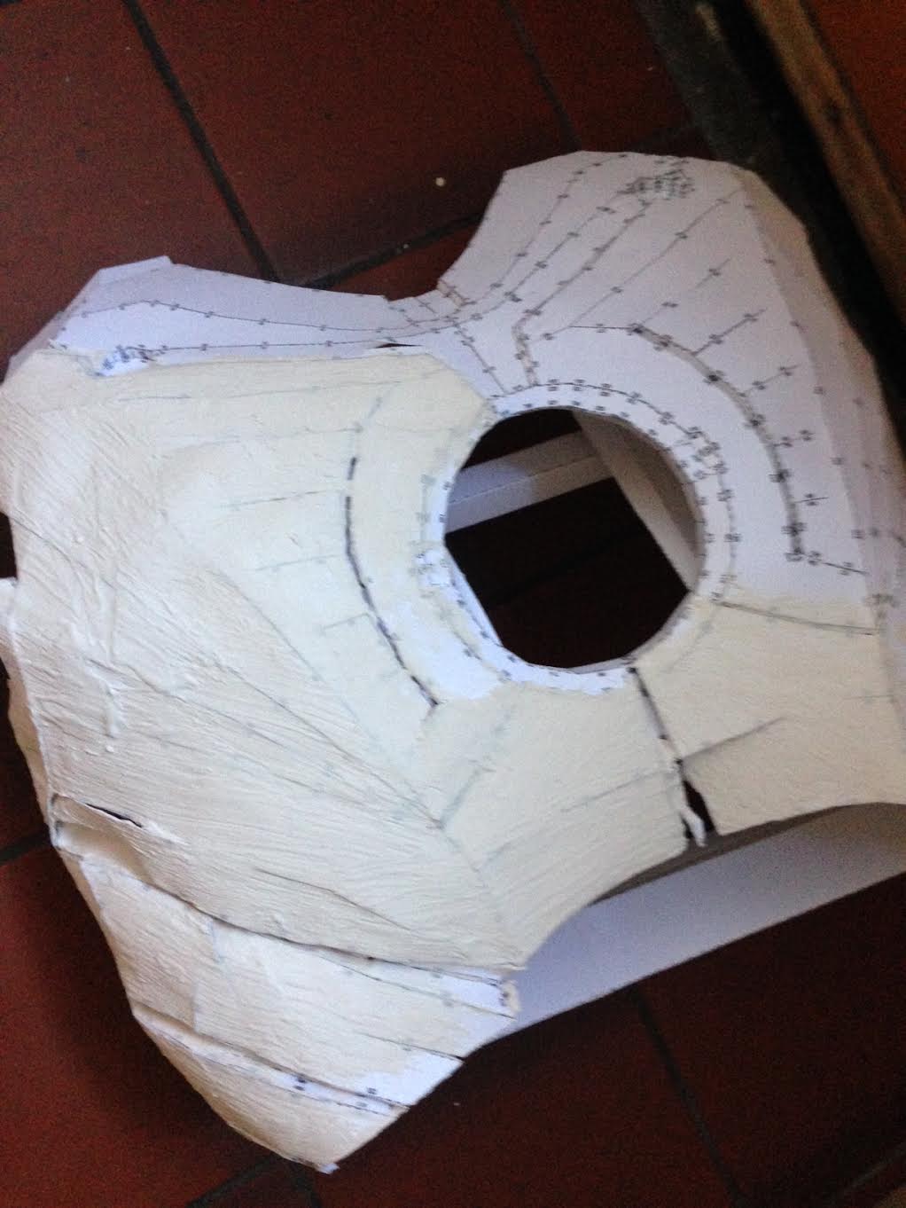

Ok, so during the last few weeks I've read up on Pepakura, resins, fiberglass, you name it. I gave up on my initial helmet try since it's so out of shape and instead started off anew with the Mark III files from DancingFool and Dubean33s helmet. I was highly motivated, and after having read some more on Jesmonite (or Aquaresin) was confident that this would work and I knew what I was doing. So far I just build the chest piece and am currently assembling the new helmet. So today I thought "lets put that first coat of Jesmonite on the chest" and prepared it. Somehow, I don't know why, I was under the impression that the Jesmonite would work sort of similarly to normal (epoxy?) resin (I'm really not overly keen on working with that stuff), at least more or less, and that I could apply a very thin layer. Turns out, it's not that simple.
I mixed it in the recommended 1 part liquid to 2.5 parts of the powder (weight wise) and I got a rather chewy, plaster resembling paste. Stupidly enough, I tried nonetheless and started brushing stuff onto my lovely chest piece. It was of course only then that I realized that it's not working like I thought and remaining way to thick, weighing the paper down immensely. I only then also realized that I should have probably applied it from the inside rather then the outside... well... when I had about 1/4 of it covered in Jesmonite the chest piece was starting to lose its shape due to the weight and the paper getting wet, I assume, and I gave up. It's now in the shed to dry but frankly, it's a disaster, and I'm not sure how to proceed now. The following things come to mind, since I really don't want to go down the toxic resin route:
- mix it differently and keep it more fluid so it can be applied thinner
- apply first coat from the inside rather then the outside
- should I spray something onto it before I start with the Jesmonite? Like some clear coating or something?
- try again when it's warmer outside so the stuff won't harden as quickly
That's pretty much it. I'm hoping that it's not completely ruined and that I can sand a lot of the dispensable Jesmonite down again, but I'm not sure. I'm really frustrated now. I have read from a few people on here that Jesmonite works and that it might end up a little heavier than with epoxy resin, but I don't think I've seen someone actually describing what they've done. Anyone able to help?

I gave the whole thing a lot of thought today and started a second try this afternoon, this time from the inside, and it worked much better. I didn't manage to coat all of it (again) because it turned hard in the pot before I finished. I could have mixed some more and applied the rest, but I was hungry and called it a day ;) I'll finish the first coating tomorrow and then hopefully also get to the point where I add fibre tissue to the inside (I went for the thinnest version since the Jesmonite already seems to provide a lot of stabilty and I was afraid that with fibreglass options I may need to much Jesmonite and it will get too heavy. we'll see).
Anyway, here's a picture of yesterday's first try from the outside. You can see where the paper gave in on the side. Now trying to figure out a way of stabilising this to get it back into shape properly...
