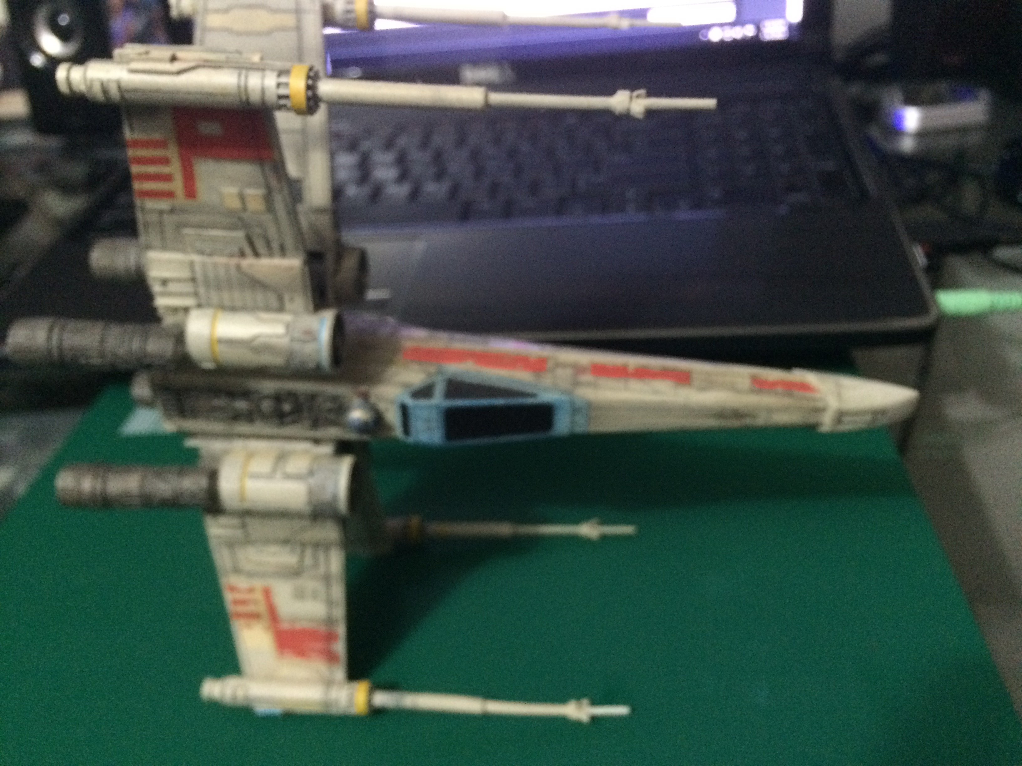

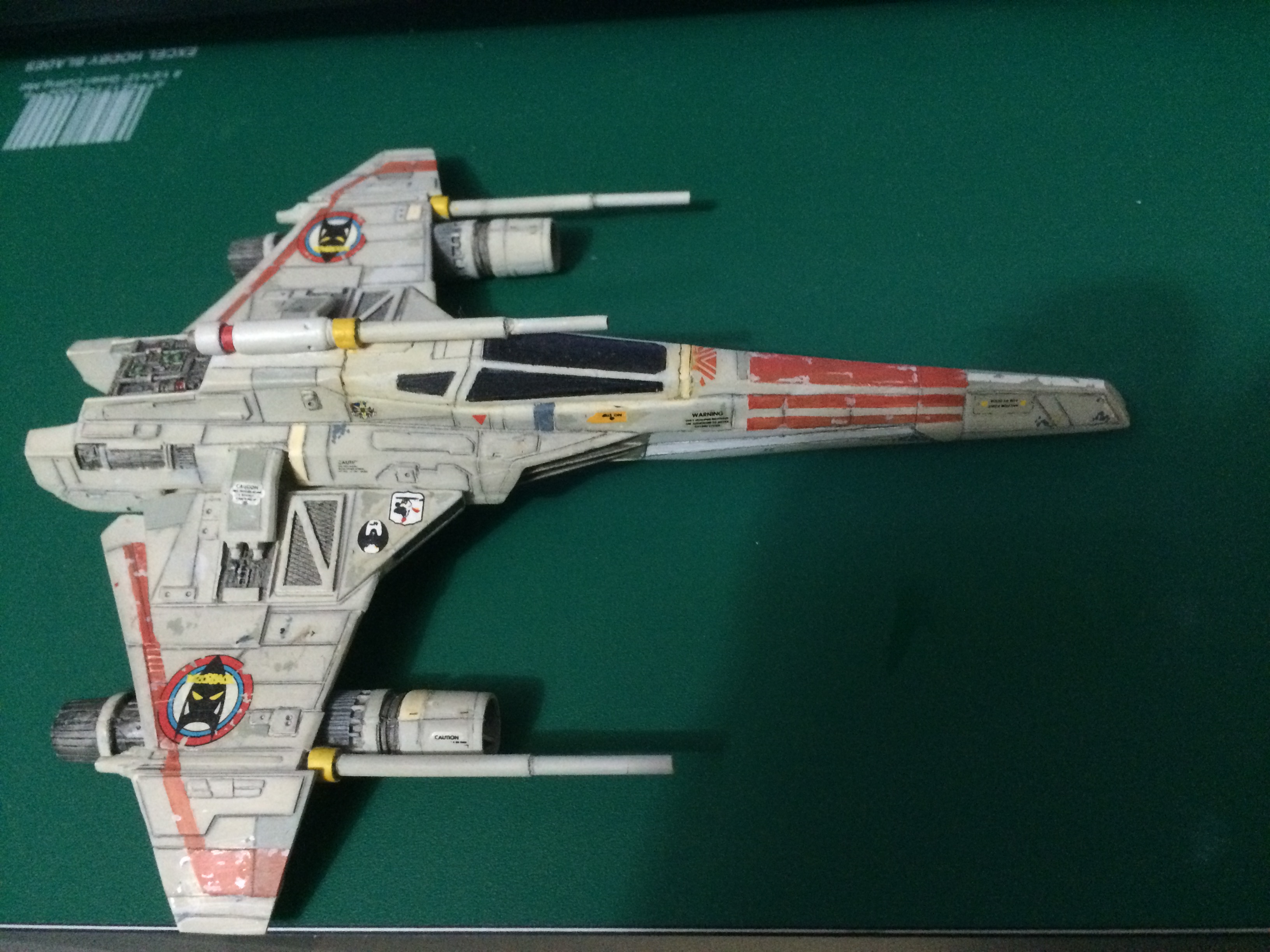

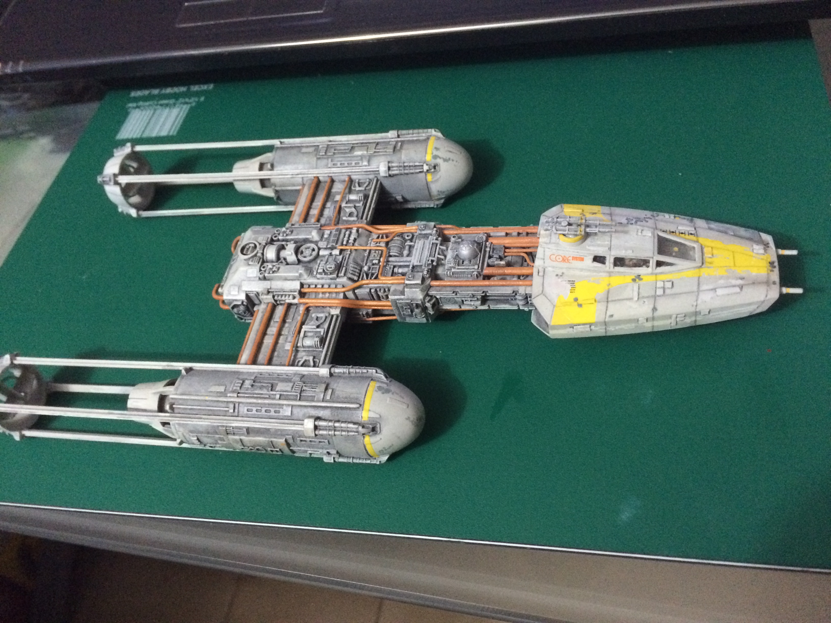

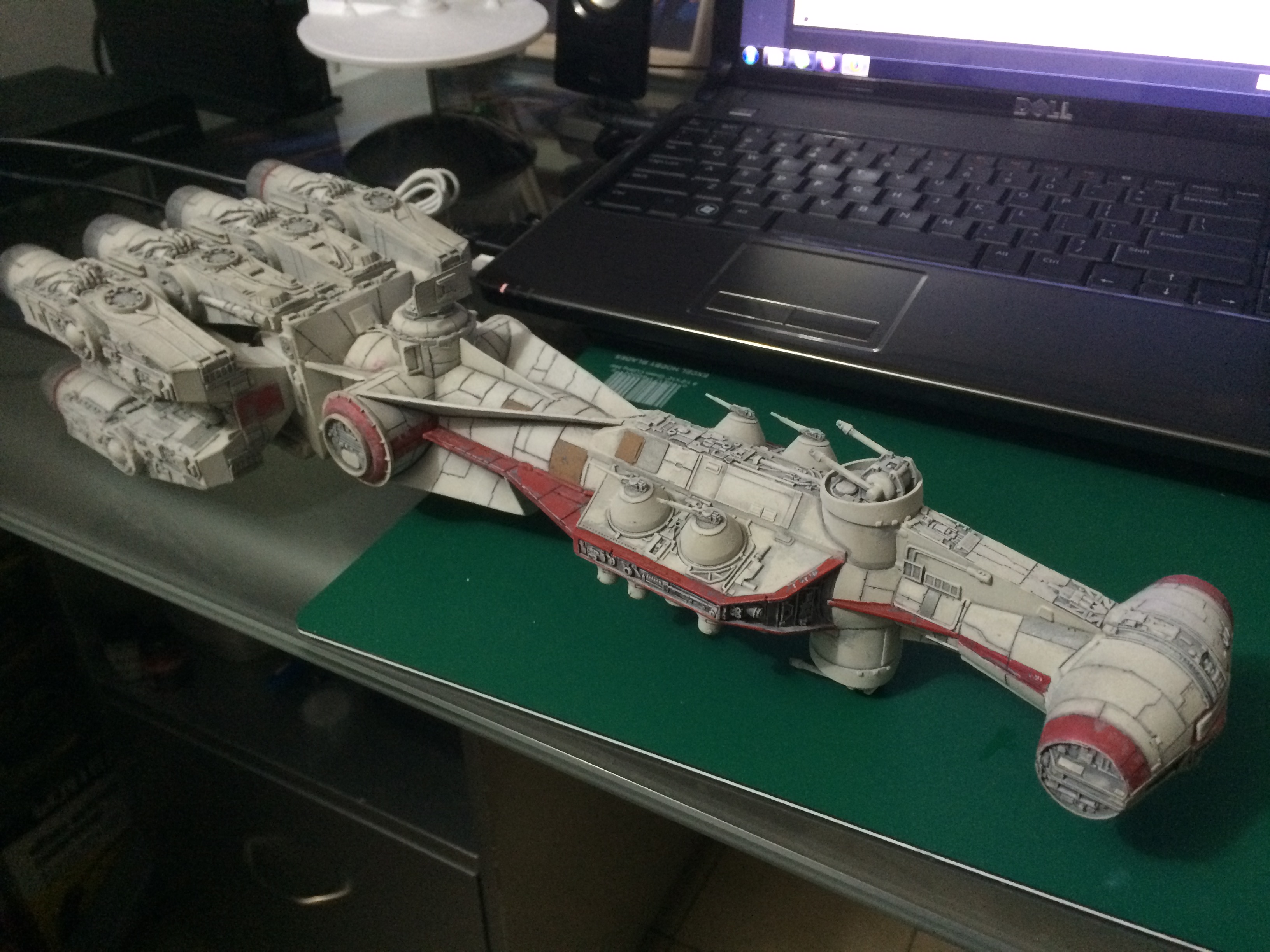

Thanks to all for your respective inputs. I'll certainly will put them to use when I prep the model once again for base coat (currently I am working on the AMT Defiant). I was also thinking of replacing my airbrush. Any recommendations on the replacement? Good quality and reasonable price preferable. Thanks again. BTW here are some of my pieces should you,like to comment on my work.

Thanks again. Anyway what is your impression regarding my work. I am trying to identify areas of improvement since the next jobs are a little pricey. Want to create excellent pieces. To list a few AMT Ktinga cruiser with all the JT Graphics resin and photoetch updrades for the Quonos 1, the FM Millennium Falcon and the VF-25 & VF-27 from Macross Frontier. I am also purchasing materials to build a 1/350 Nebulon B. I did some quick numbers and should be running around 3 feet in length.
Pedro
The pics are a little grainy, but all those models look pretty darn good to me. :) (is that a Gundam decal on the Y-Wing?)

Randy13
I just wanted to say beautiful work on your builds but the Blockade Runner and Y-Wing really stand out to me. I really like the paint job on those. If I were to do anything else to the Y-Wing, I would add a little darker weathering to the engine exhausts. But I'm definitely no expert and still have a lot to learn about painting and weathering myself.
