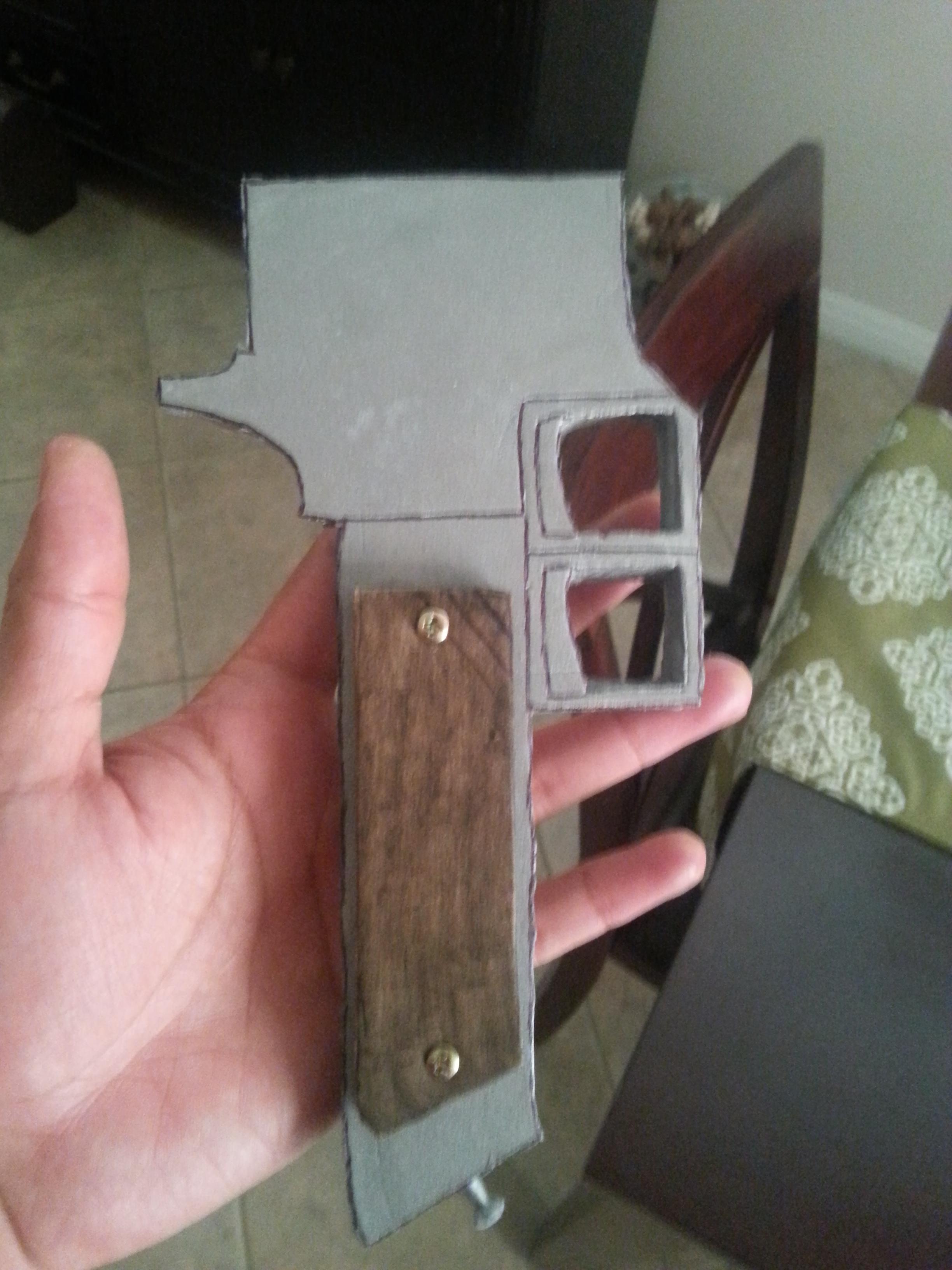

FRONT VIEW
TOP VIEW

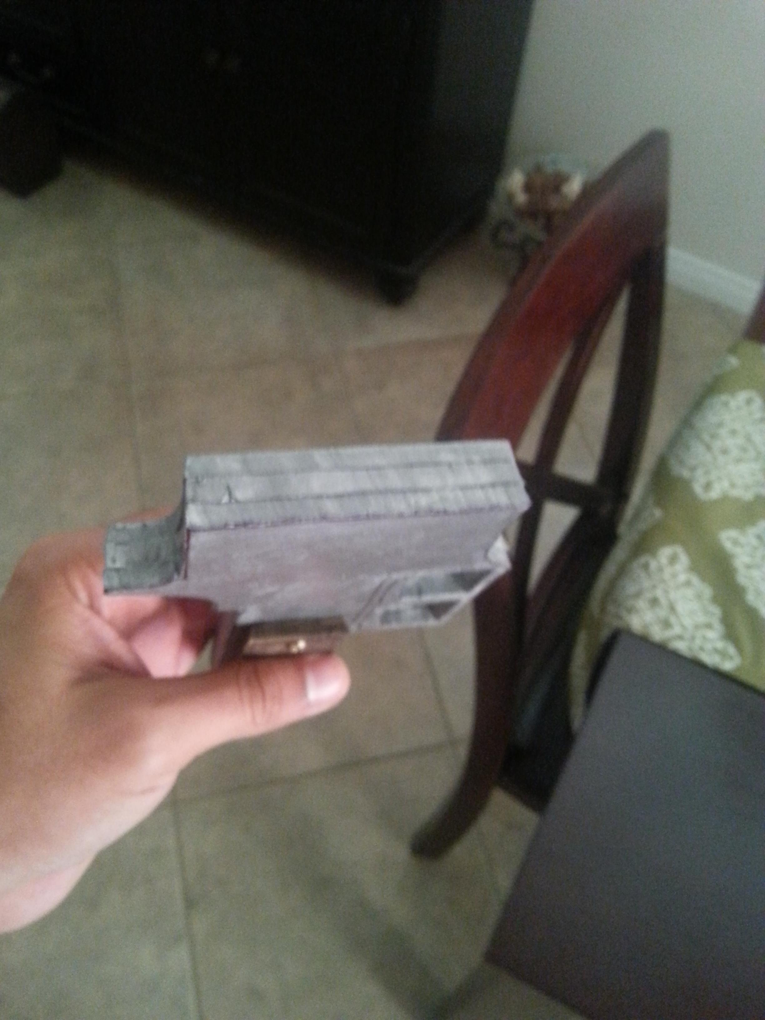

This is where the blade is being inserted. At least, that's the plan. The hilt pictured is made up of three layers of foam board glued together with foam glue, and I am planning on removing part of the center layer in order to wedge the blade in and either glue or fasten it somehow. Any other suggestions would be very welcome, though I don't believe that just gluing the blade to the top of this hilt would be very stable. Haha
SIDE VIEW
A side view of the layers in the hilt.

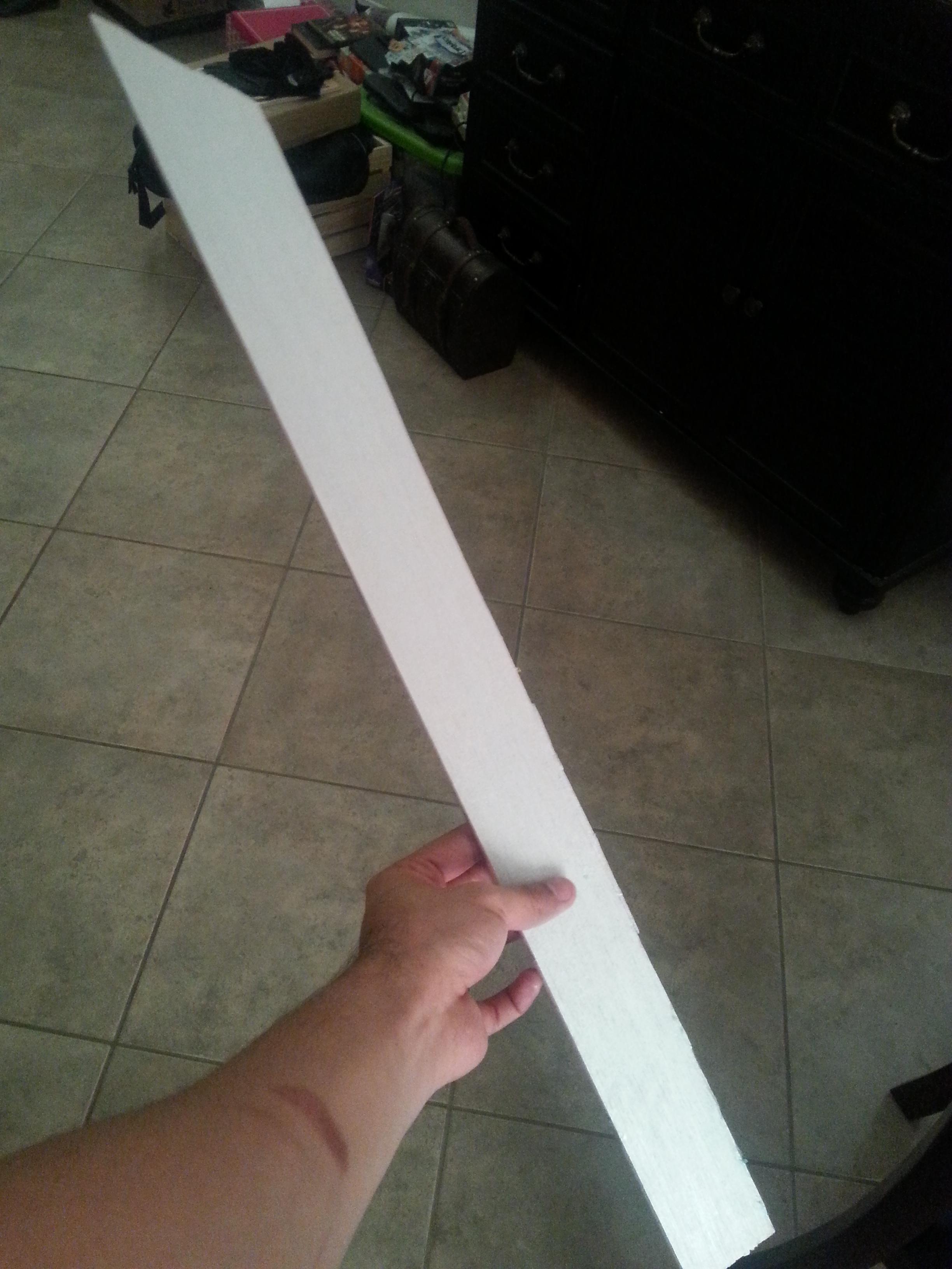

THE BLADE
Frontal view of the piece of wood I'm using as the blade. As you can see, no tang, although I do have some give with the length. I'd be fine with sacrificing some length in order to make this all work.

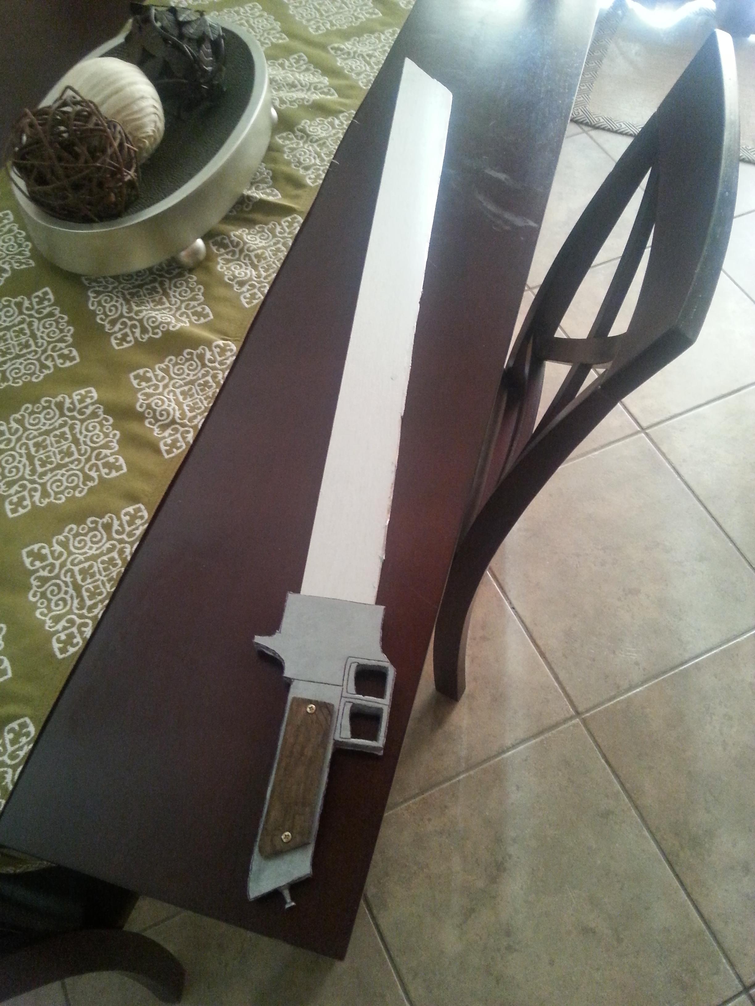

ALL TOGETHER
Ideally, this is what it would look like once finished.

novacat17
First off, nice work.
Now on to the issue. It seems that a good solution will require you to rework the hilt a bit. The pin solution may work, but balsa is probably not strong enough for that. Could you carve out the middle section of the foam a bit to allow the blade to slot in slightly?

CynderBloc
Looking at those pictures, it looks like the hilt is made up of three identical pieces sandwiched together?
Really, what you want to do is remake the whole thing. I know it's a pain, but if you had incorporated the blade as the middle section of the hilt, you would have had a full tang and a very sturdy build.
With what you have there, it's going to be very difficult to get a join that will hold
novacat17
I sadly have to agree with CynderBloc (sad because it means redoing it, not sad because cynder suggested it:p), best way is to take what you learned and redo it all (a common feature of a replica-prop creation, I promise).
However, if you want to try and salvage what you have and carve out the middle, a good method would be to use a sharp exacto or utility knife and go very slowly (be careful). You may even be able to use a chisel exacto blade (most hobby stores sell them as part of exact and hobby knife kits).This is a dangerous prospect and I wouldnt recommend it. The possibility of cutting youself while working on the it is a bit too high in some respects, especially as the results may still not be anywhere near stable enough (a floppy blade). A dremmel sanding bit could also do this, but again with poor results.
As far as the pins, you could probably use finishing nails, which you can find at any hardware store. They are thin enough, dirt cheap, and might be long enough to work. However, there is a good chance they would just chew through the foam over time.
As cynder mentioned, safest and best way is to start over. If you plan on doing this, you could get a full paper plan sorted out first and then work from this plan. I use a vector drawing for any of the blades I plan on making and then print them out on thick cardstock to test the ideas, look, and size of the design. If you have questions on this method, feel free to shoot me a PM or search around the RPF for examples of blade builds.
