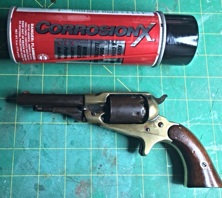

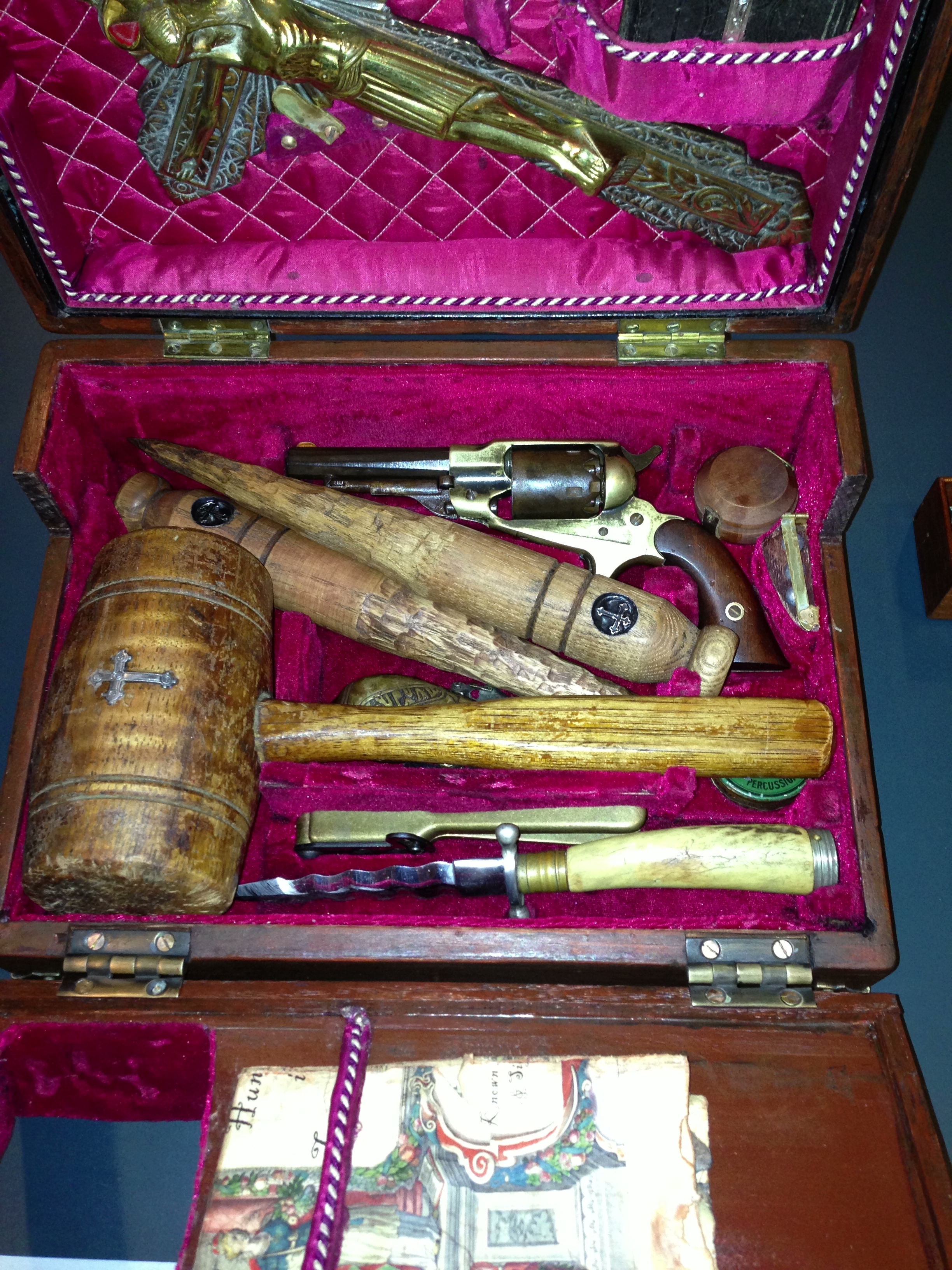

I built a vampire killing kit about 6 months ago which includes a nice working percussion pistol replica from Dixie Gun Works. I used Birchwood Casey Plum Brown to finish/age/weather it as per the instructions and I was very pleased with the results:
A few days ago, I reopened the bottom layer of the case and took out the pistol and was shocked to see how rusted the iron parts were! I am sure, now that I think it over, that this comes as no surprise to experienced gun owners, but I really did not expect it to be this severe. I then set about patiently disassembling the pistol and working oil into all of its parts while trying to preserve the antique appearance. I have definitely lost a lot of metal off the more delicate parts but everything works again I am satisfied with the appearance.
How can I arrest this process without changing its appearance too much? Is coating it, inside and out, with a thin film of oil the best approach? What oil should I use?
I live in the mountains of Virginia and it is not displayed in a particularly humid area (air conditioned, etc,) but should I include some of that rust preventing paper like they use in tool boxes in the kit (just between showing it to people)?

well im no expert and can only pass on what I use on mine - I have an actual 1850 percussion pistol - deactivated as I don'r want any issues with the law and I had the same problem to begin with and I did exactly the same as you cleaned it up and oiled it that helped and then I asked someon at the Imperial War museum in london how best to keep guns like this looking nice they suggested a Silicone based oil designed to protect the exterior of guns - I Just used a few drops on a soft cloth and gave all the parts a light wipe over and reassembled the gun and wiped over the exterior parts of the gun, it did give it a little sheen finish but it does protect it from water ,rust and corrosive little fingerprints, and I've not had the rust issue since.
hope that helps
There is a product called Corrosian X, you could spray the entire gun with it, let it soak then wipe off the rust then coatit in corrosian x again but this time wipe off the excess, this will not change the patina or affect the value of the gun.

Corrosion X is available on Amazon with nearly all 5 star ratings. I have ordered some and will report back. Thanks, again!
