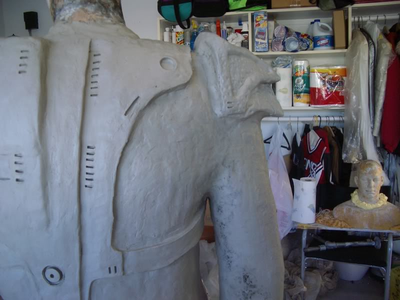

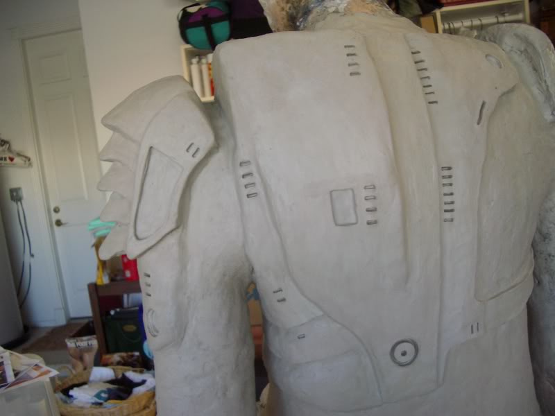

Ok im ready to mold it today. This has bugging me for awhile I don't know if I want to risk moving it from the table and lay it on its back with a milk crate and step stool or bricks or if i want to mold in the way it is? I will be using ultra cal.
I was thinking of keeping it upright on the table and mold each arm seperate then mold the chest.

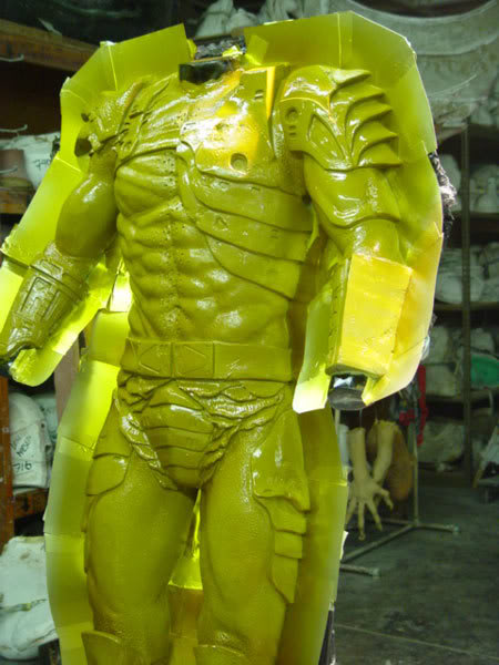

Use the sheetmetal like so....
Batman Dead End pic.
