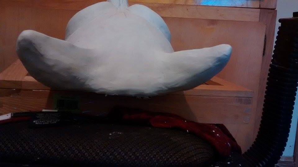

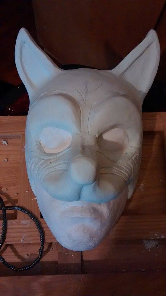

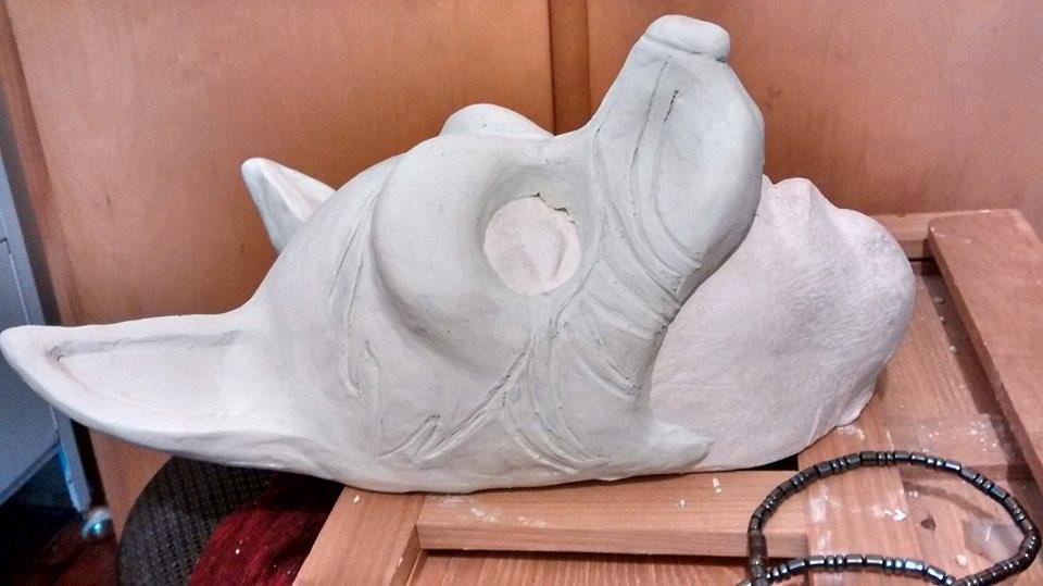

I sculpted myself a mask on top of a plaster face cast I made but I have ran into a problem. The ears make it difficult to make a simple jacket mold and I'm not sure how I would make a box mold for it. I could really use some ideas on how to make a mold for the mask. Also I could use some pointers on how to smooth out the mask and make it look a bit cleaner.

So I decided to go with a two part box mold. The only problem I'm running into is that the mask I sculpted is made of non drying clay. The only way I know how to make a two part box mold is by embedding the item in clay. I could really use some help.

That was my initial plan but I am unsure how I'm going to get the back of the ears. Would I just brush that up and try not to spill while slush casting or try and fill in the ears after?

I'm looking at the rebound 25 now and have more questions. Is there a big difference in 25 and 40. Also, when making the Mold do I still need to buy a thickener even though it's "self thickening"? If so, what kind. Also, would the trial size suffice to making the mold. If not, is there anywhere I could get a bigger amount that won't cost me a near $200. And one more question about the mother mold. From the pictures I took (I could take more if needed), would I be able to make the Mother mold a one piece or would you recommend making it a two or three piece Mother Mold.
If you go with Rebound, I'd use the 25, as it's much more flexible. Yes, you will still need a thickener, a small bottle of Thi-Vex will go a long ways. It is still necessary to thicken the silicone after the first or second coat, in order to fill undercuts. Hard to say for certain, but to me, it looks like you should be able to do the whole mask with one trial size kit.
I'd defer to Mr Mold Maker for best materials to use, and the shell. But I'd use the Rebound, or mold max, and miiiight consider a 2-piece mother mold, just due to the shape. With the snout protruding, and the ears sticking up, you might get it locked in there. Or, might not. Kind of depends on what the final shape of the silicone mold looks like.

I believe locking would be a huge issue.. you basically have the snout and ears acting as giant keys against each other. Ideally, you'd do a two piece jacket, separating at the mid point of the ears, so that the piece can be lifted straight out of the mold.
