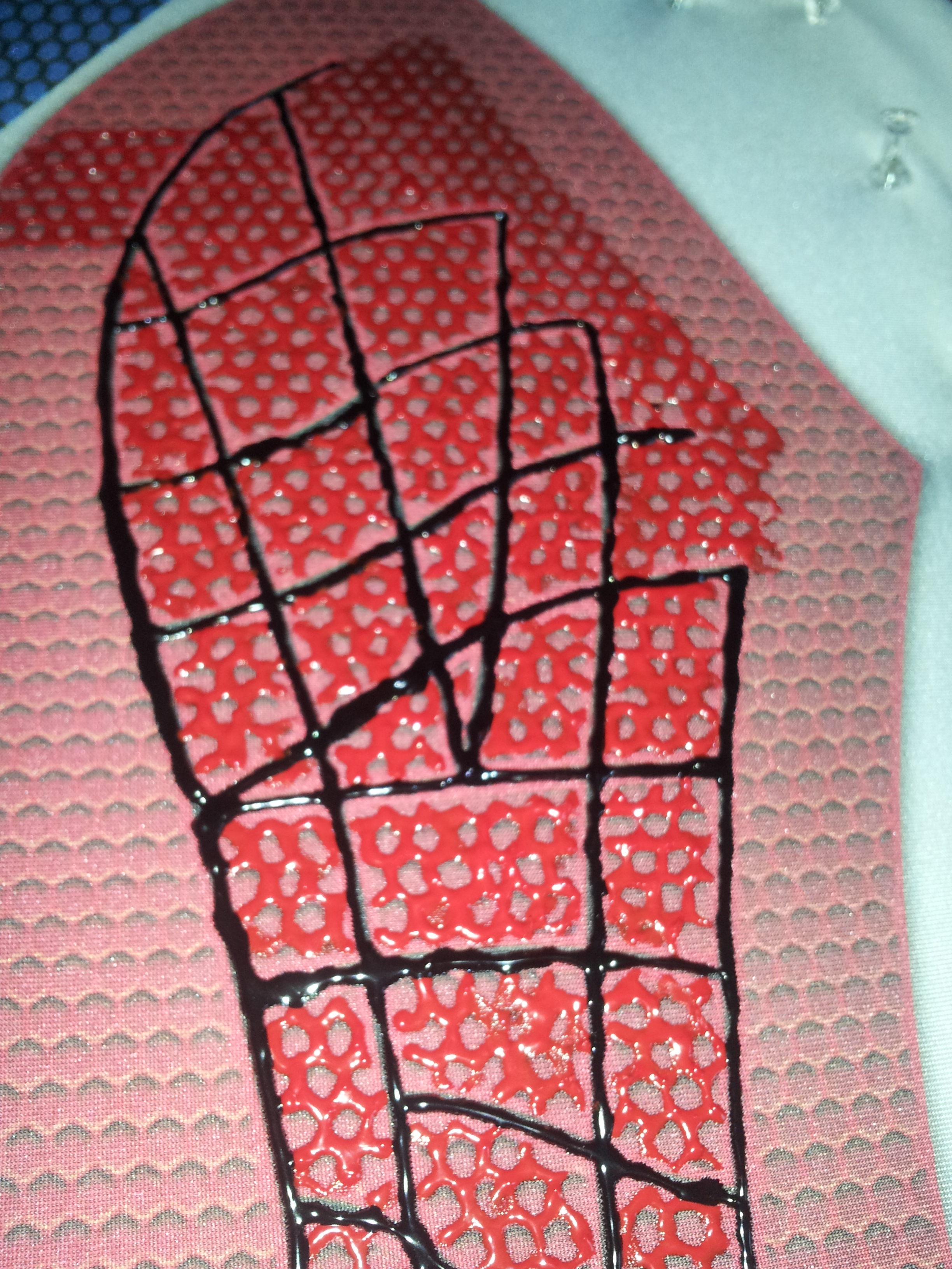

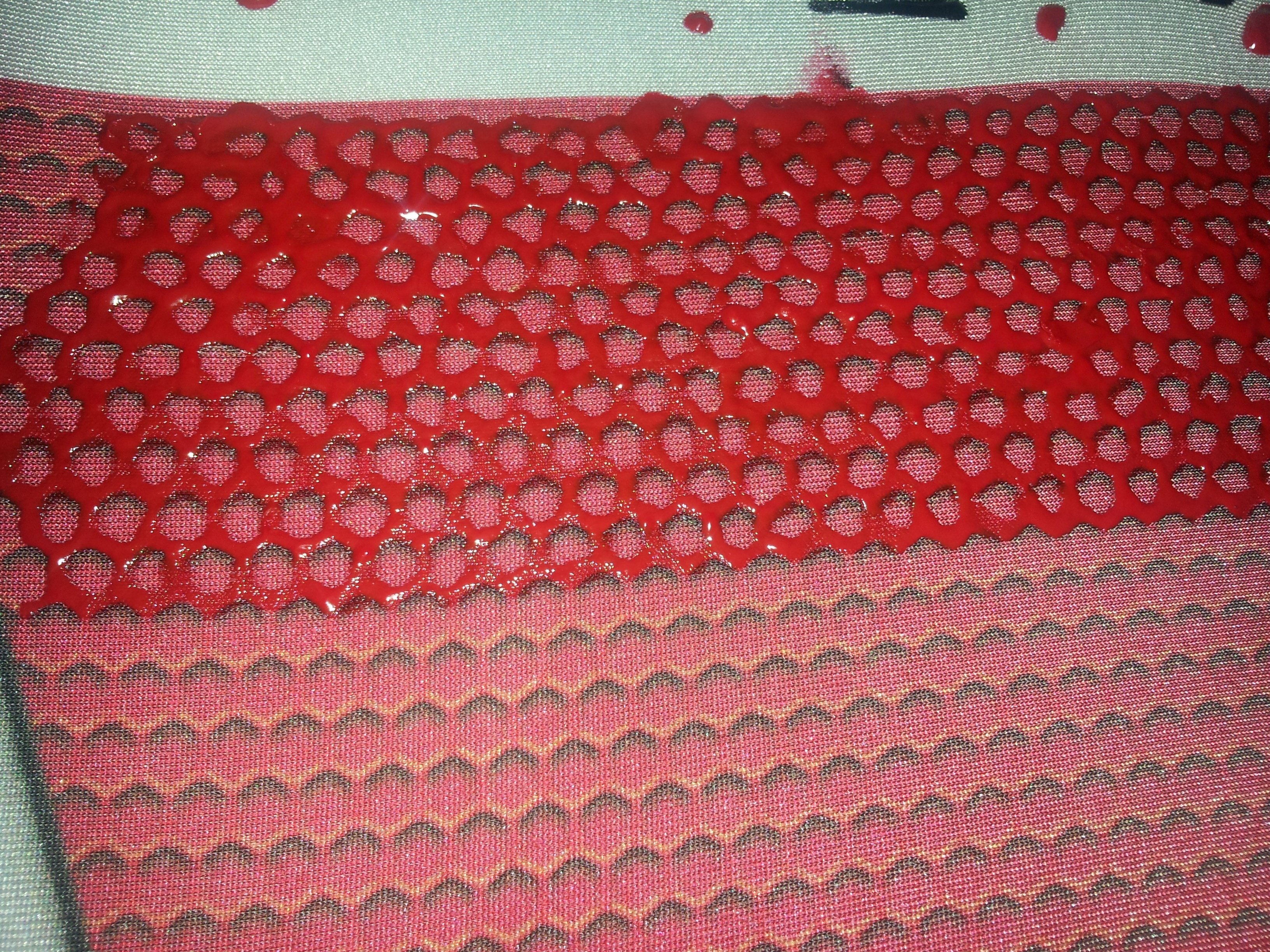

My friend asked me to make him an Amazing Spider-Man Mask.
This is my first time puff painting a project!
Can I get some tips? Do I paint all the lines or leave some to be sewn?
What looks better bigger lines or thinner lines for the Honeycomg pattern?
I am using Taylor's print.
Thanks to TJack for his frames, going to pain them when they are shaped :D!
2013-06-29 12.28.31.jpg2013-06-29 12.28.50.jpg2013-07-03 10.23.17.jpg2013-07-03 23.35.07.jpg

I found that you need to go slightly heavier than you think as it soaks in and shrinks down some, too little and you just get a crispy fabric, too much and it looks bad. Its a lot harder than you think, I still have my arms to do as I messed them up. My advice don't use it straight from the bottle get a metal tip adapter and shake the bottles really well. I think what messed mine up was not shaking the bottles enough and my black was fine when it went on, but then quickly blotted away ruining the print.
I actually brought a PVA glue adapter with bottle and fine metal tip and just decant into that

Thanks, cool Learned the blotting part today one a new piece! :( sigh!
Progress pics
Hey, hey, I'm just wondering where you would get a metal tip adapter for the puffy paint?
Re: First Puff Paint Amazing Spiderman Mask Project!
I got mine from finetip.co.uk
I got the bottle as well as I found by shaking up and decanting into the little bottle it is easier on your hand and also eliminates unmixed paint better
