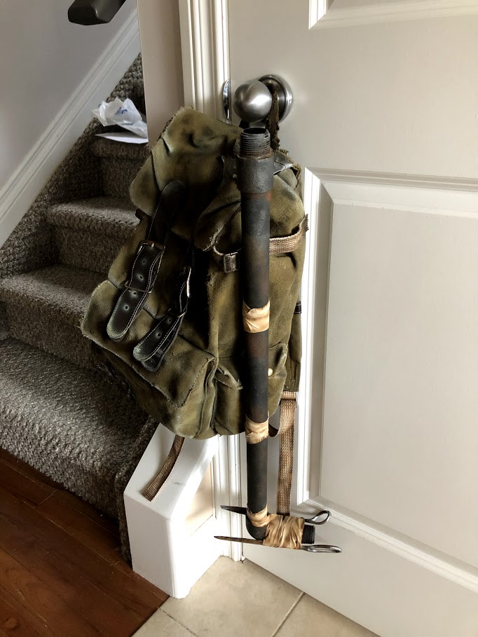

Hi everyone. Long time lurker, first time poster. Hoping someone might have a brilliant epiphany for an issue I'm having.
Working on a cosplay of Joel from the game The Last of Us, and I'm stuck (no pun intended) on how to secure the pipe to the side of the backpack. The pipe is PVC and weighs about 1lb, and the backpack is canvas.
In-game, the pipe just sort of floats with no obvious attachment point (reference below), and my preference is for my cosplay to match that as closely as possible.

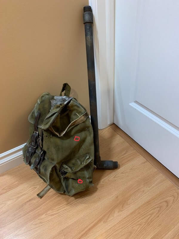

My "brilliant" plan was to glue two strong neodymium magnets inside the backpack (the red circles in the photo), one inside the main compartment and one inside the small side pocket. I'd then glue two more to the pipe (covered with tape), and voila! Unfortunately, this isn't working. The pipe flops around and falls off pretty easily (and these are REALLY strong magnets). I think this is due to a combination of the thickness of the canvas (since magnetic attractive force drops off exponentially with distance), the lack of friction between the canvas and the pipe, and with the non-rigid structure of the backpack (so the pipe shifts a lot as I move). Plus, this isn't even in a busy convention environment where I'm liable to get bumped into frequently.

Got it. I ended up cutting two small notches into the pipe so the magnets wouldn't stick out quite as far, used JB-Weld to attach them and then taped over.
The trick was to attach the each magnet inside the backpack to a steel nail plate, and then glue that whole piece to in the interior. That drastically increased the holding power without reducing holding distance. I've tested walking around and shaking and everything seems to be holding pretty steady, so I think I'm good.
