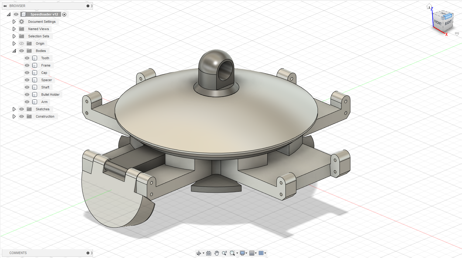

I am looking for some reference photos of Hellboys 4 round speedloader. I want to make a functioning loader (or two), and have it fit the Tip Top Workshop rounds.
I am aware of this thread: Interest - Hellboy - "Speed-loader" for the Samaritan!!!
too bad I missed the run.
It looks like when you turn the top of the loader, the arms release the bullets. Hoping for some high res photos of one so i can determine how it works and/or replicate the details.

the bullet are 22mm diameter, just under 25mm at the back flange. The cylinder is approximatively 71mm diameter.

As I stated in the first post, my design will be for Tip Top Workshop rounds.
If it somehow become a run, or I release the files, I think it can be adapted to work with sideshow.

It’s been slow because I am working on the gun kit itself, and another 3d model I have been working through.
I printed a test in PLA, and found what I need to modify. I need to print the revisions to test again. I plan on getting it printed in resin. Still looking for a service to do that. Pewter would be awesome as well, but no idea how to do that. lol
I also made a more screen accurate version that (I assume) works more like RelicMaker's loader from a few years ago.
Got the first protype from the 3d print service.
It came out great!
There were a few flaws in the top, maybe because of the dome shape? Otherwise, all the planned tolerances seem to be perfect! Now I just need to assemble it.
One thing I know needs editing is the lettering. It needs to be much larger and deeper. I have made that edit, but alas that means another print call. :(
13 parts in total, hopefully it functions as I planned.
