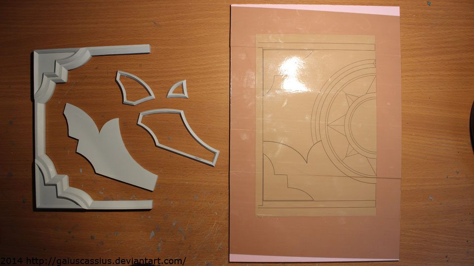

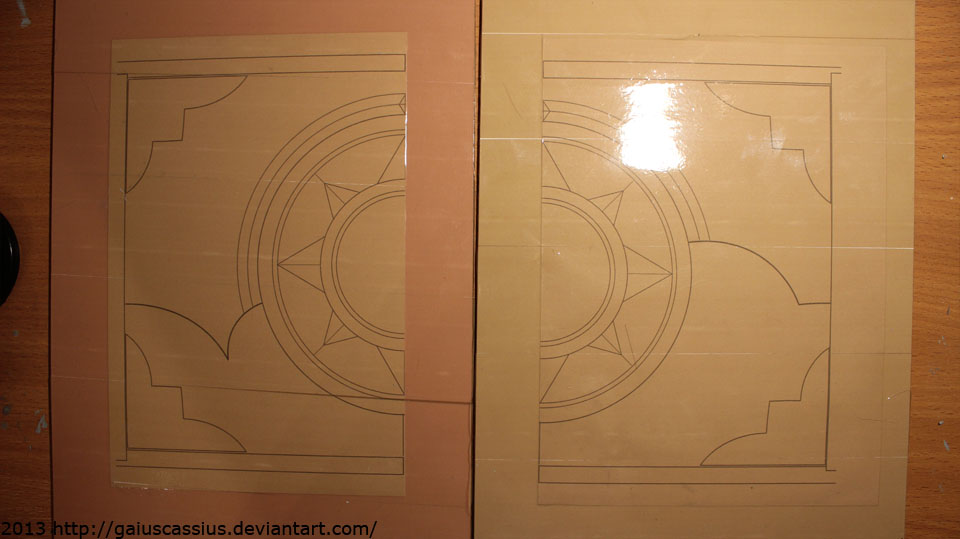

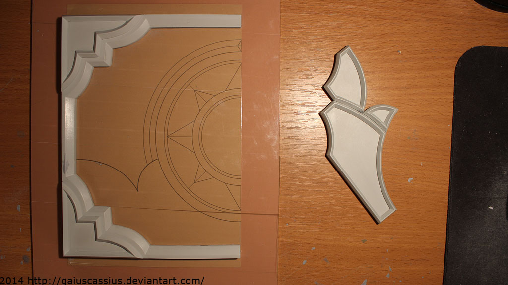

Left plate and mold bases with partial blueprints

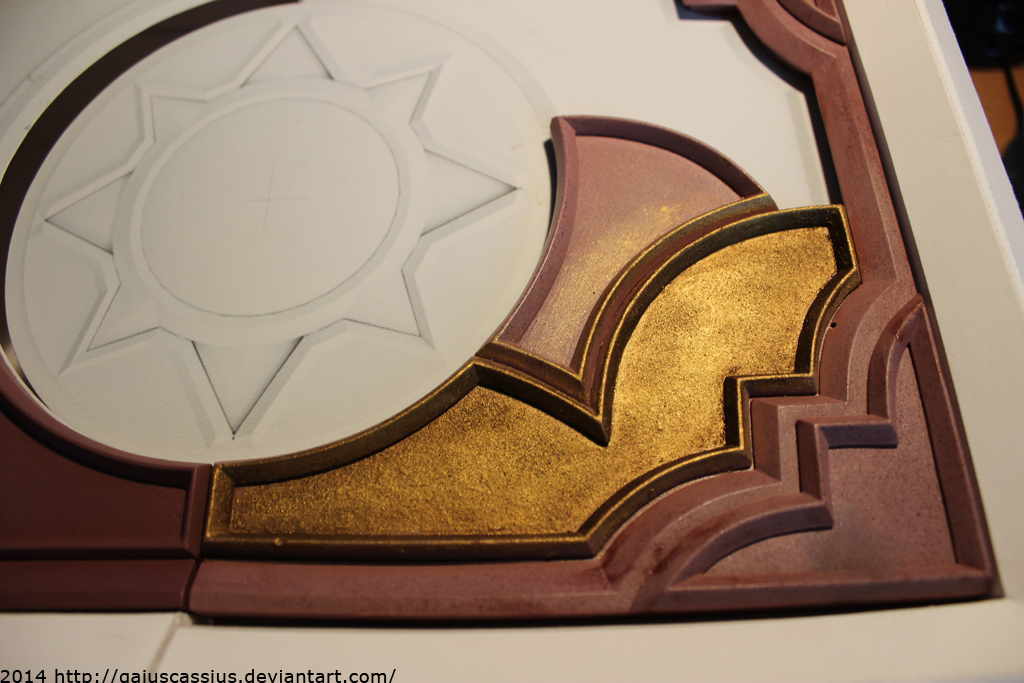

Tested out old gold patina on one of the elements. Seems like a good background color for gold hilights and since getting metal powders in Poland is such pain in the butt I might be using only patinas and waxes. Gonna look less realistic and more game like which is actually not a bad thing :). This week I'll order additional gold, copper and silver patinas to play around with them on casts of left and right plates that should be ready withing next few days. I'm also considering using hinges such as these:
Thx guys :D. Here's a theoretical color scheme for the logo. The real one will be definitely less hi-contrast. Without black it actually looks really nice so I will have to decide how much wax I wanna use :)

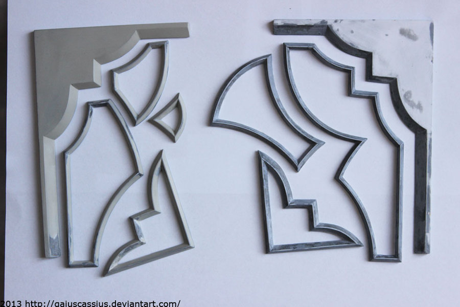

Mold is... average at best and my first mold (left frame) is really bad but I know how to make it work, yay! Rest of the elements are from second casting and they look much better, almost normal :D.

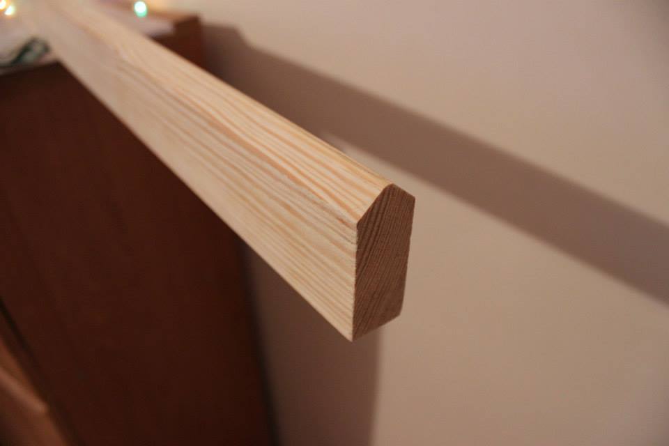

Wood I bought started cracking in the middle section which means I will have at least 33% material less than I thought... Heh, gotta find out what is the cause.
