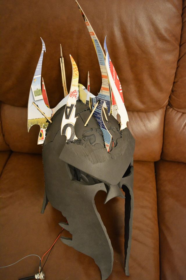

And here's a progress pic of it as well, so you know your work is being put to good use ;-) I pretty much used the inner shell for constructed the face-plate, but I split it differently to haave as few seams in the foam as possible. So the only 'flower' part is the top of the head.
Wow, that looks amazing, I would suggest using the measuring tool in pep and adjust the scale measurements from there.
