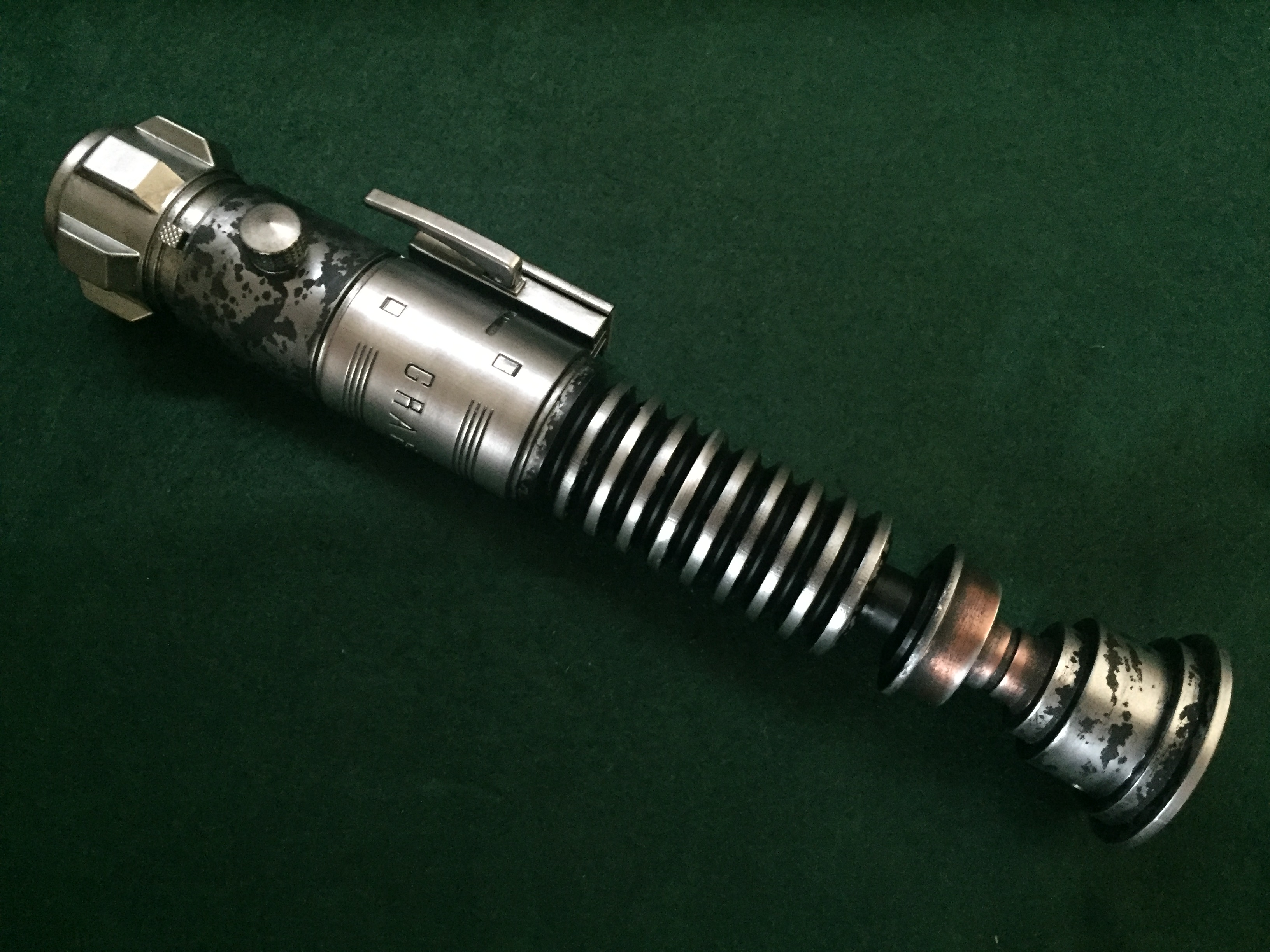

The majority was done with a first airbrushed coat of 'steel' (I think it was a 50/50 mix of Alclad steel and stainless steel) over a satin black basecoat. Then a protective layer of Alclad Aqua clear varnish. Then a layer of chipping fluid. Then a final layer of matt black. That last layer was then scratched and rubbed back to the steel with wire wool and an occasional toothpick.
Some lighter, more subtle areas of wear were created with Rub n Buff.
Finally, I hand painted some areas with a steel mix over the matt black. The trick is to mimic the randomness of paint chips and wear, which is more difficult than it might seem... we have a tendency to want to create symmetry and evenness! :) I used this technique only on my resin-printed Luke ROJ lightsaber - painting silver over a black basecoat and black over silver as needed. It works pretty well, I think.
