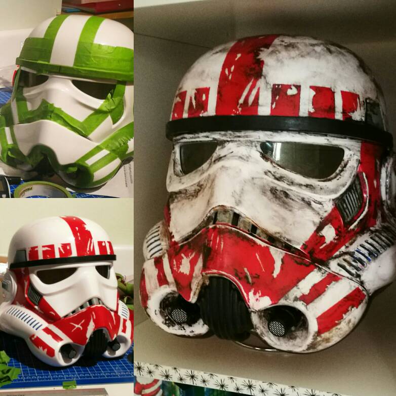

My take at painting and weathering. First time doing something like this. I think it turned out quite okay
For a first time it looks great! Weathering can be a little tricky at first, but there's all kinds of different methods out there to get the job done. Looks like you might not need to look into any though!
I've currently started working on the interior of my black series helmet. I've always wanted to do that, so this helmet provides a good start.
Looks nice! I'd tone down the black soot weathering a bit. I think it'd look much better.

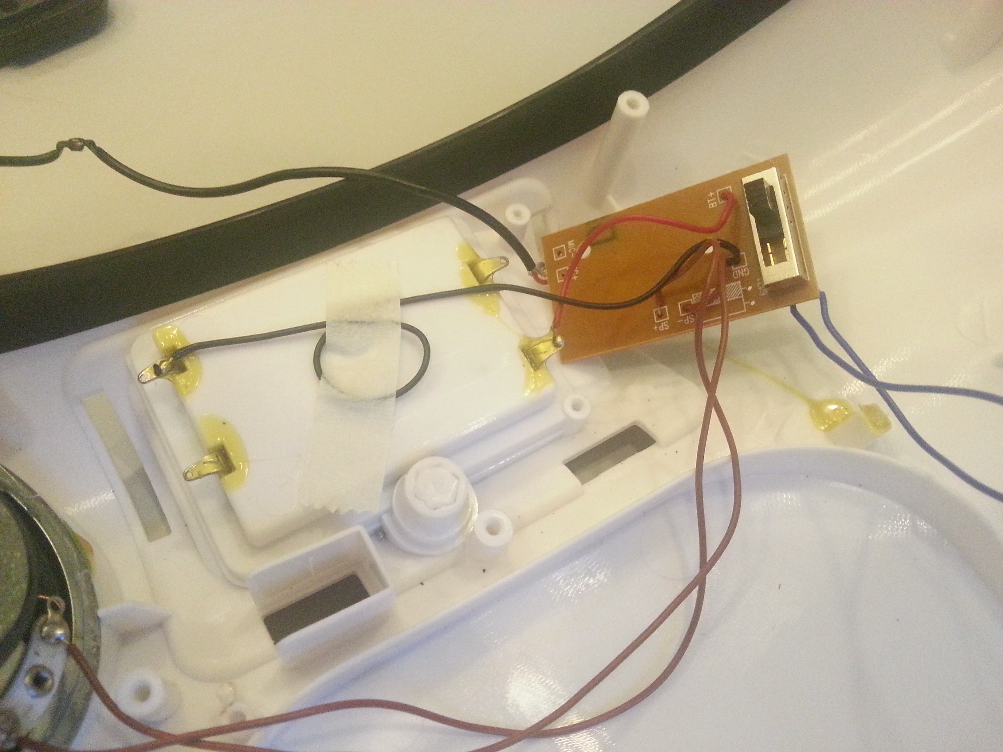

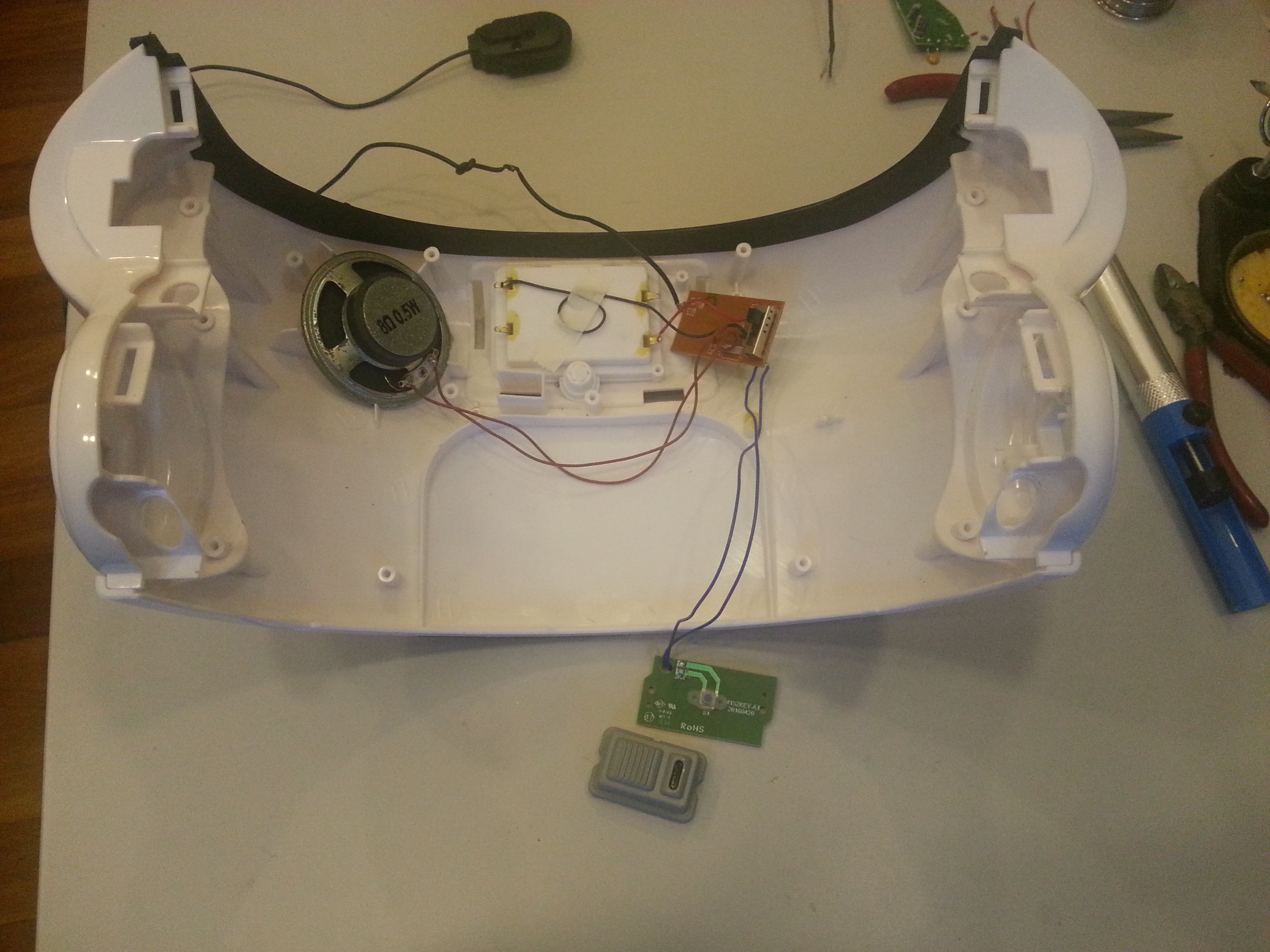

Hi everyone...I know I am supposed to post my first post at the new members' thread but I have been a lurker in this thread for far too long and thought I'd just dive in. I was really inspired by the amount of creativity going on not only with the RPF but also particularly by a YouTuber PITT FORCE FIVE who did a mod of the Kylo Ren helmet using the cheap Voice Changer mod he found on Amazon. I simply tried to replicate the mod with the Hasbro Stormtrooper helmet.

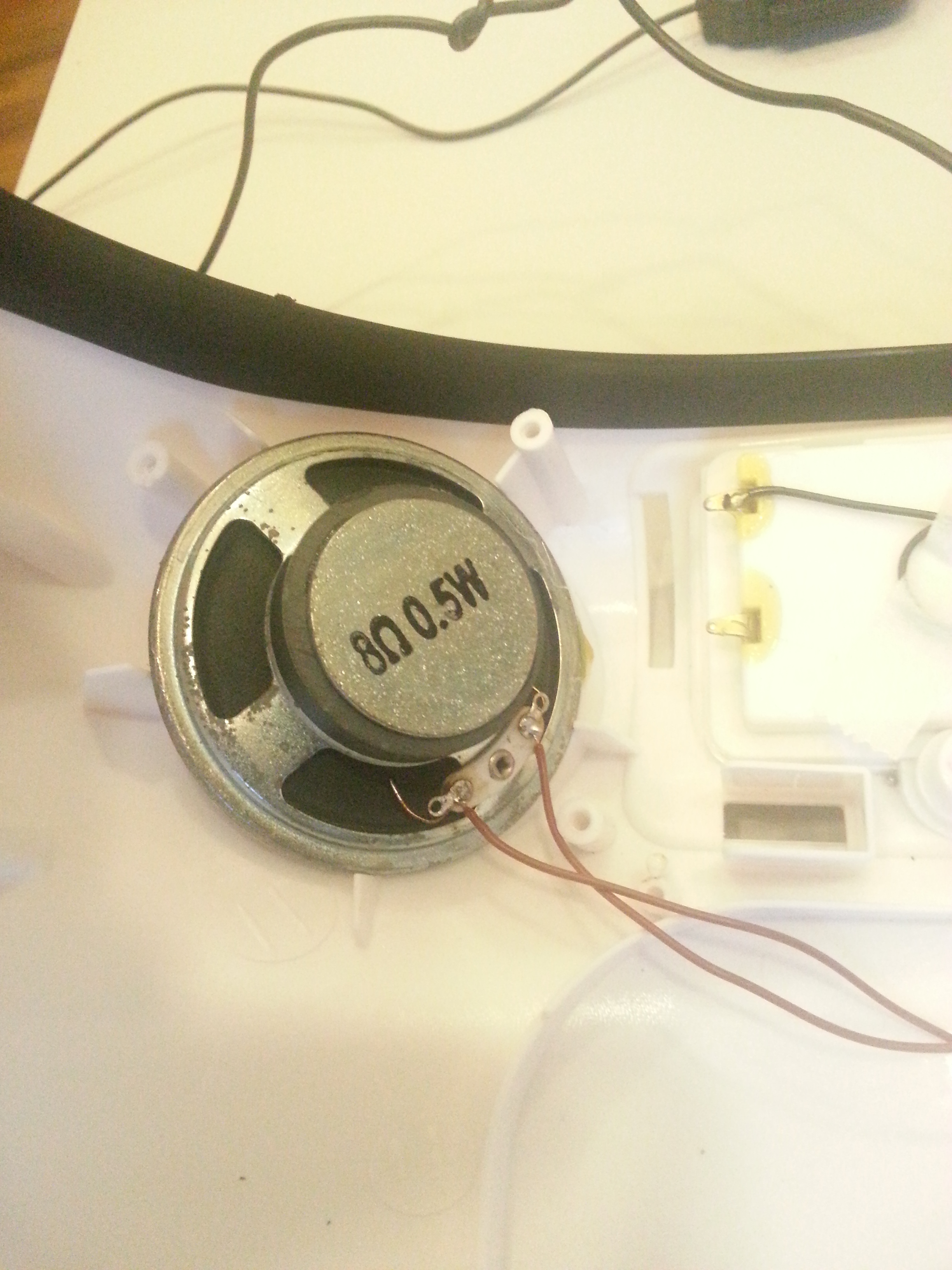

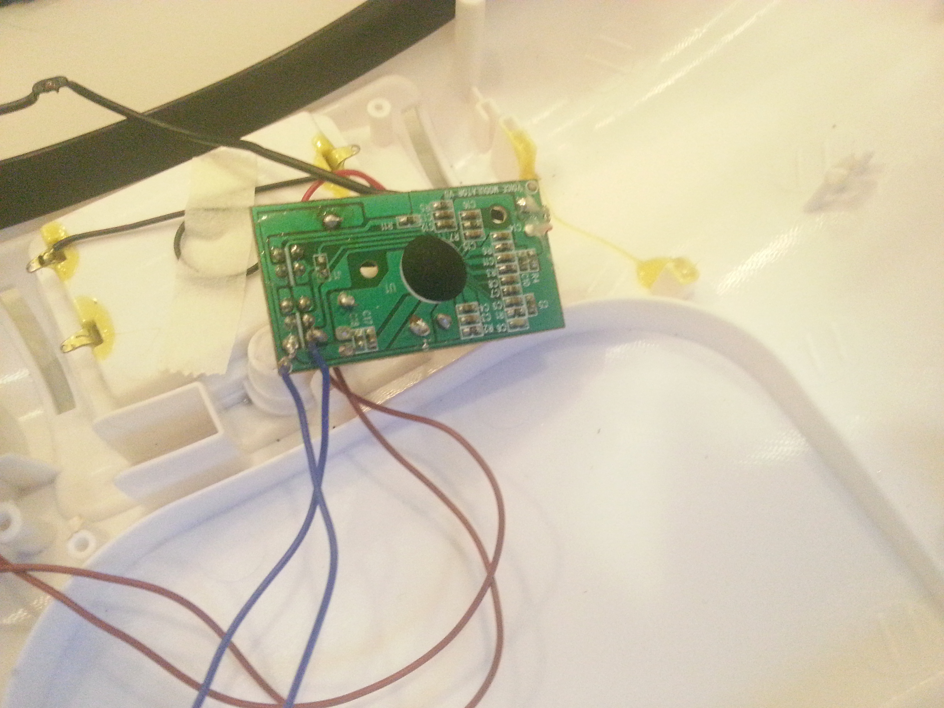

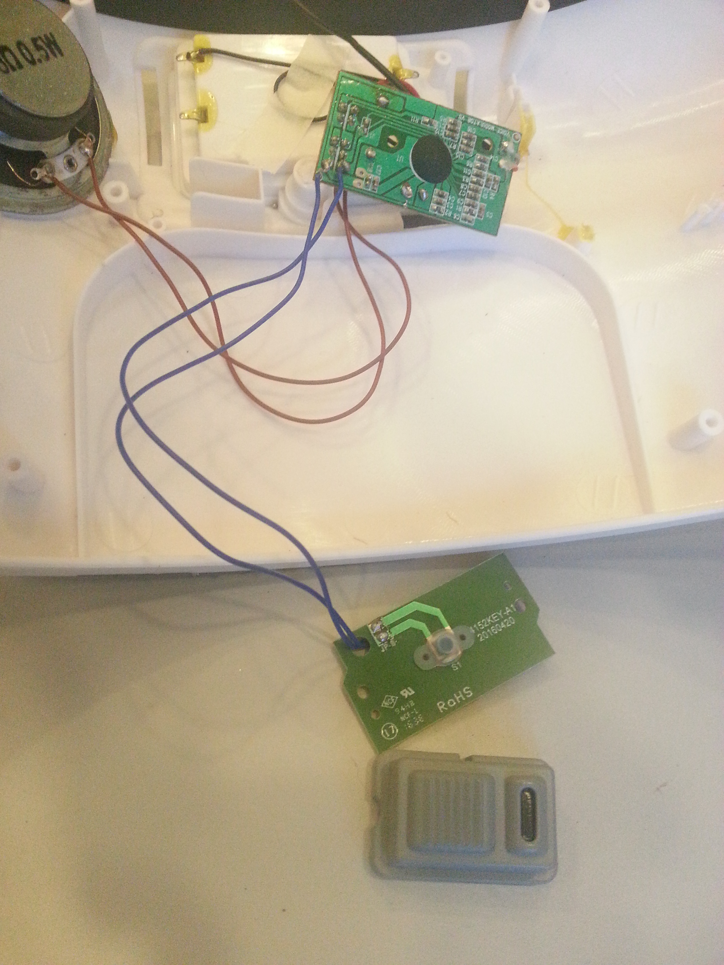

Now, before I dived into this project, I hadn't planned on doing something so major...like just get the Voice Changer, tape the mic and strap on the unit in my belt and be done with it. No I had to take a leap of faith and rely on my rusty soldering skills which I have never used ever since I left Technical School. Anyway, I am now at the point where I have replaced the original helmet's 0.25W speaker and voice changer circuit board to the 0.5W speaker and circuit board from the Amazon Voice Changer.

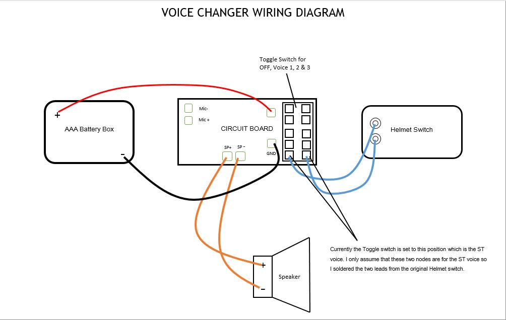

I wanted to use back the original helmet's ON/OFF switch, but I am unsure how I need to connect the two leads from the helmet switch to the Voice Changer circuit board's toggle switch. I'm not confident in doing a clean removal of the circuit board's toggle switch haha, considering this is the first time I touched a soldering iron since I was 19!
Currently I soldered the helmet's switch leads (blue colour wires) to the last two leads on the circuit board which should be the "Stormtrooper voice". But now when I press once on the helmet switch, yes it will turn off the mic/board but after that I can't get it back on. I have to reset the switch on the circuit board instead to turn it back on. Pretty sure there is a way to make the helmet switch work.
Thanks :) Yea, I went with like zero knowledge full carnage on the helmet. Was fun as hell, but next time I think I will watch some tutorials beforehand :D
Yep, had the same thought. toned it down with some acetone already, but I leave as it is right now.
Very cool! What type of paints did you use if you don't mind me asking?
Just a rattlecan of dark red and normal acrylic paint for the weathering. Sticks surprisingly well to the shiny surface. Didn't sand it.
A good trick for weathering and wash is to never use either pure black or pure white color. Nothing in the real world weathers in black. I always start from a brown or white-isch color .. try it and you will really like the result!
I like your red a lot though! :) did you use liquid masking to do this? Or salt and water? Or you just simply scratched your paint job?
Iwilllokintothis.My.spacebar.just.died.on.me.so.I.have.to.make.it.short.I.just.used.mustard.for.masking.worked.nicely.
