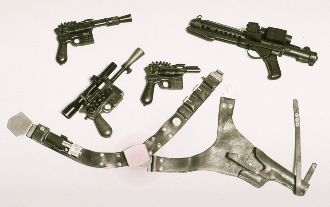

Wait, we know the ANH pouches weren't sewn on? Which pouches? I'm fairly certain they were all sewn on. Even when it was discussed in this post (pages ago)... I believe it was confirmed they were stitched.
Sent from my SAMSUNG-SM-G900A using Tapatalk
If you can. Watch the first 15 minutes or so of my last video. I go into detail about this.
The short version is that no pouches on the Episode 4 holster are sewn. There is no evidence that there were any sewing. All other holsters were sewn.
@ jazkaat: re-read post #52 onwards. The edges of the ANH pouches were not folded outward and sewn to the belt, but folded inward and fastened some other way, maybe just glued on the belt. The second discovery is that the pouches on the rh side were probably all made from one single piece of leather, although this is not general consensus, I believe.
These are, in my opinion, two most relevant discoveries Crazylegsmurphy made in this thread. The ANH Holster is different from the others in more ways than was generally believed.
@Crazylegsmurphy: Having re-read post #52 myself, I had an idea about "the mysterious flying disc". What if the disc was fastened slightly off-center and was simply spinning around eccentrically on the belt? This might easily account for the different positions of the disc you noticed in the same scene.
@ jazkaat: re-read post #52 onwards. The edges of the ANH pouches were not folded outward and sewn to the belt, but folded inward and fastened some other way, maybe just glued on the belt. The second discovery is that the pouches on the rh side were probably all made from one single peace of leather, although this is not general consensus, I believe.
That makes sense. It could have been installed off-centre. I had another thought though....it just ripped/stretched. I suspect that disk got bashed around a lot when sitting down, moving, running, etc. There is a chance on this holster it was knocked, causing the leather to rip or stretch, allowing the disk to droop a bit.
I can't see any indication on the screen used one that it was off-centre, however... there may have been a few versions of the holster and this one (perhaps a stunt one) wasn't built as well, or in worse shape.
Ok, I can get on that bandwagon. No stiches...
I've not seen this pic before, gives up the secret of the holster/buckle interface.
Sent from my SM-G900V using Tapatalk
After all, we still have not been able to find out how the ANH leather belt was fastened to the hook. Obviously there are no rivets (this is one of the main issues on Todd's hardware), and glueing alone certainly wouldn't stand the strain.

Could it be that since the pouches are clearly folded from one piece, they are simply riveted in a few places on the inside? Sewing is less likely because you probably couldn't get a needle in there. Alternatively, is the edging on the leather pressed in? or is it a second layer of leather? In which case, if the pouches are sewn/riveted to that layer, and that layer is glued and riveted along to the second layer, the rivets of the pouches and the stitches would not be visible from the inside. I guess there are no images of the belt from the back/inside? that would solve a lot of mysteries.

As rivets seem to be the predominant fastening system on the ANH belt, it makes sense to assume that the pouches were riveted to the belt, too. Actually, that is the path I'll follow if I'll ever find the time to finish my own holster (It is still lacking the pouches just because I was not sure how to fasten them).
