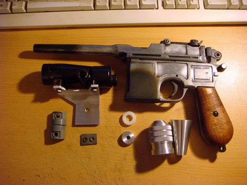

Here are the parts of the Solo blaster in their current state. I definitely need to polish the denix before applying the gun blue or else it just looks dingy and feels dirty.
Also, I'll be fixing the flash hider with a thin walled piece brass pipe, fits in almost perfectly.

I really don't want to paint this thing, has anybody had any luck with those gun bluing kits on Amazon and the like? I've heard mixed reviews in the past. If it looks good I'd really prefer that over painting.
Birchwood-Casey products (Aluminum Black) have been used for rebluing zinc replicas, even though it's not even supposed to be possible... the main thing is the prep work. Strip the Denix thoroughly of the old coating, degrease, sand with several grits, degrease again... get the surface as smooth as possible before applying the bluing compound. Don't forget to degrease. Bluing compound may have to be applied in several coats. Afterwards, apply oil for a nice bluish-black sheen. Lots of elbow grease is needed to achieve a great look.
Yea, I ended up getting that stuff and did a few tests with it, you can see it in the picture up above. The polishing is definitely a necessary step. I might work on the gun a little more in a week or two, we're too busy at work right now for me to get anything done with it really.
